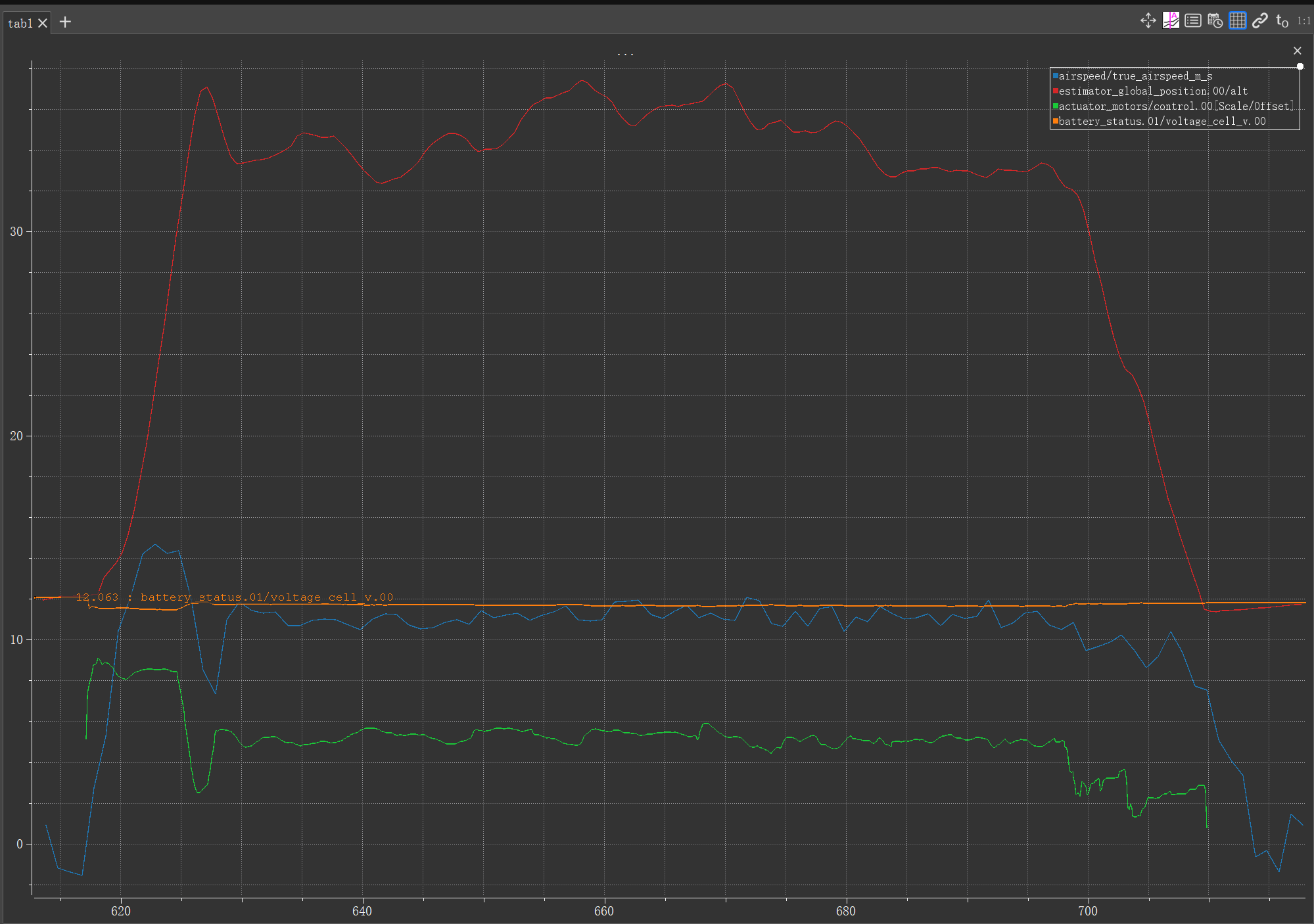

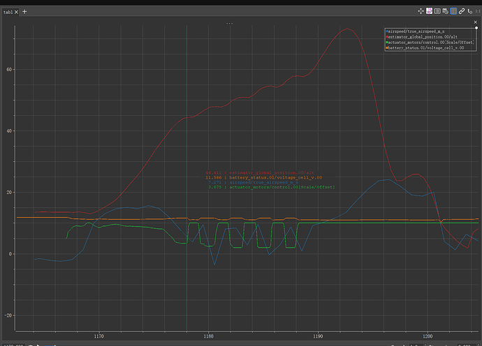

I’m experiencing a critical issue with a fixed-wing aircraft running PX4 firmware v1.16.0. During flight testing, an abnormal failure occurred:
For the first 16 seconds, motor control functioned normally. Suddenly, the motor power began **rapidly oscillating between 100% and approximately 20%**. This caused **uncommanded left roll** followed by immediate loss of control and crash.
Notable context:
- The flight controller has prior water damage history
- For graph clarity: Motor PWM output values are multiplied by 10 in the charts
Attached data:
**Fig 1:** Flight log showing failure
**Fig 2:** Normal flight reference
Requesting assistance diagnosing this dangerous power oscillation behavior. Full logs available upon request.

我使用1.16.0版本的PX4固件固定翼飞机。我在试飞时出现了奇怪的故障。在前16秒，马达的功率控制一切正常。但是突然马达的功率在百分之百和20%之间快速跳动。飞机异常地的向左滚转，然后很快就坠毁。值得注意的是，我使用的飞控曾经进水。为了方便阅读，图表中马达的pwm输出值被乘十。
图一是发生故障的飞行记录
图二是一次正常的飞行。
我十分渴望得到您的解答！感谢！

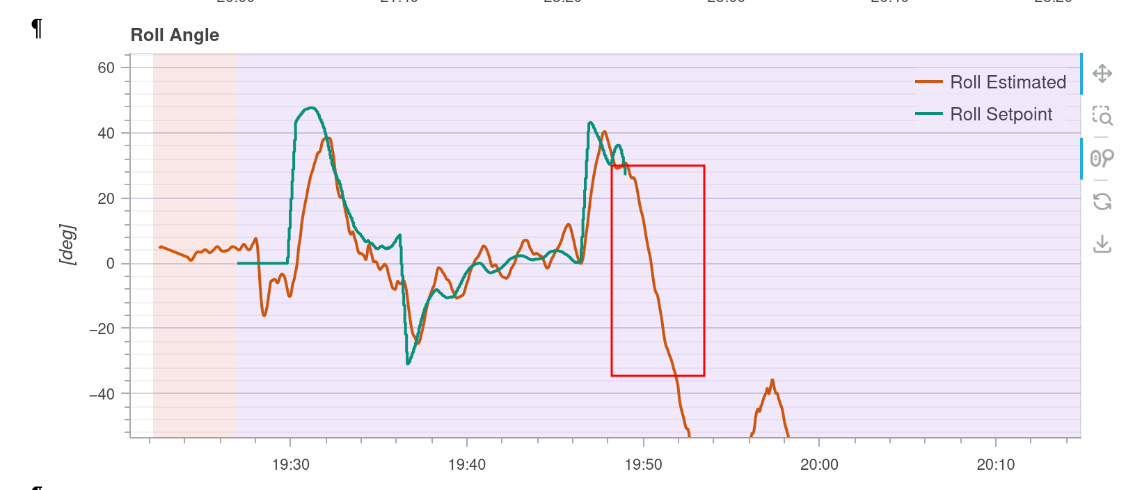

What I can see is that the roll setpoint disappears, so is no longer published:
 ![image](https://discuss.px4.io/uploads/default/original/3X/2/3/2307efbb30871a6a34327a61a9272faaf355664f.png)
I’m not sure why that happens yet.
@ryanjAA do you have any idea, looking at the log?

Never seen anything like this.
Attitude SP can disable if you violate roll or pitch maxes aka terminate but I don’t see that here.
I guess with the backstory of the autopilot and its damage that’s worth something.
low on stack is a bit early to coincide with something like this.
the interesting thing is twice By the same user. I’d say next step is a new autopilot exactly the same parameters. If still happens we have a real issue. If not it is something hardware level given water damage (which tbh I’m skeptical of now, there’s Something going on).
Will keep looking.
