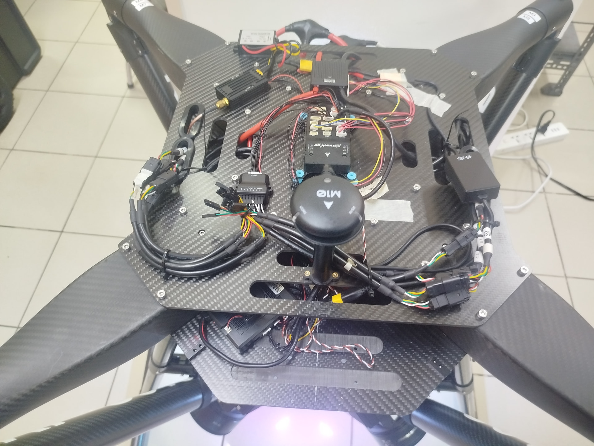

This is the exact frame we used.

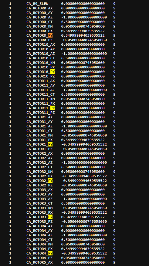

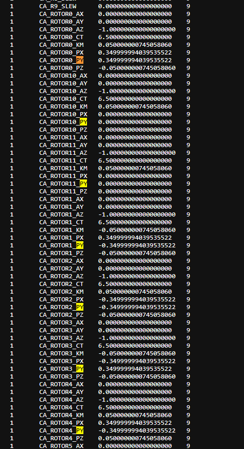

How to measure the motor position for KM?
Also the PY/Z axis value?
 ![image](https://discuss.px4.io/uploads/default/original/3X/a/a/aaccacf8cde2eb13a2ae02799cfd213516afccd2.png)

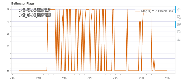

It looks like your Mag was not happy
 ![image](https://discuss.px4.io/uploads/default/original/3X/5/8/589040f34ea4699dc6ab76db02e377b22ae0c4a1.png)
Looking at thrust (current to motors) vs mag field is very correlated, this is bad.
This will casue the EKF2 internal estimator to get wrong readings and ignore the magnetometer.
Most likely, the motor cables are too close to the MAG. I would suggest using an external (e.g in gps) or standalone.
The orange should be mostly flast, only 5-15% changes.

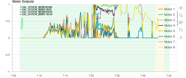

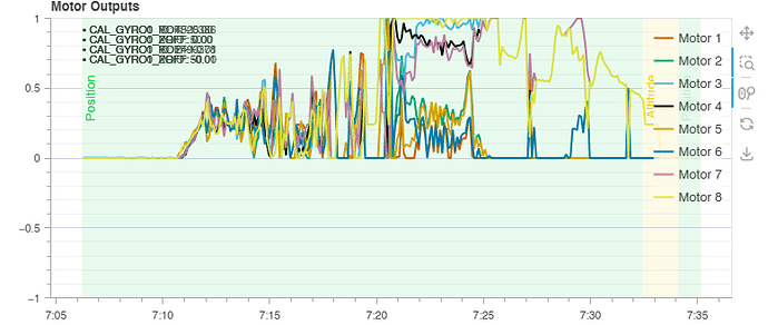

Lots of saturation on the motors aswell
 ![image](https://discuss.px4.io/uploads/default/original/3X/d/8/d8d5ea187f6682407d27adfab247f6fcadfc902f.png)
I haven’t done the math but with such high potential thrust you might be running into the problem of not being able to give low enough thrust on the motors. The motors have to spin a certain speed to not stall or produce uneven lift. There is also a minimum thrust `MPC_THR_MIN` and` MPC_MANTHR_MIN`
One of the best tips I can give you is to build a good testing rigg where the drone can be attached and spin withuot damanging anything.
It can be as easy as a steel bar where the drone can only rotate in 1 way.
This will let you test props direction, thrust, mag, some initial flight stability etc before doing real world tests.

also will try to make some changes on the layout of the components to reduce the noise

but for now Im going to re-arrange the wiring cables especially the arrangement of the components in the top plate. Ill also do some drain test making sure vibrations and electrical interference is reduced as much as possible.

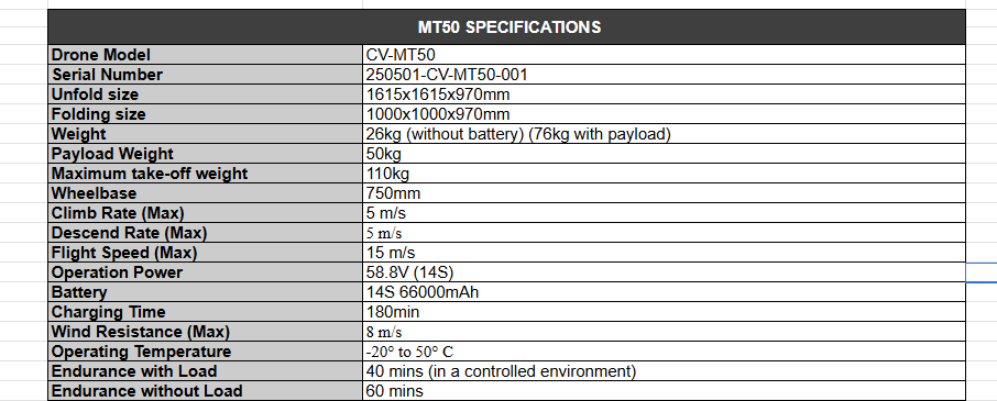

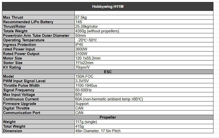

I looked at the specification and watched the recorded flight test and I think one of the major problem is the power lost. I seeing that in the video, the motor is losing power when trying to lift up. then base on the specification of the motors which Hobbywing H11MD it really is needing larger battery packs with higher Discharge rate since at the time of the video the Drone’s battery being used is 14s 30Ah - 5c .
Currently Im looking for a Battery pack that is 14s 66Ah 10c that can still fit in the battery cage so I dont need to modify the cage. Other than that I have already set parameters based on your suggestion and research on the documentation
