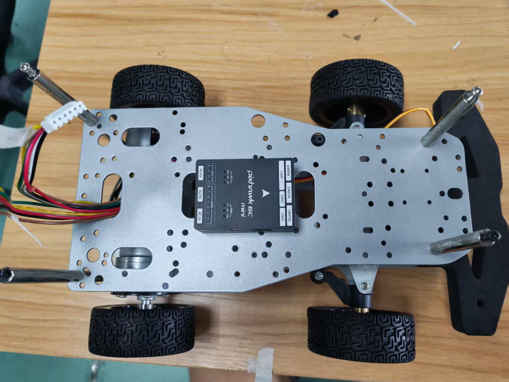

Hi everyone, I’d like to ask for some advice: I want to install a flight controller on this vehicle—what other parts do I need to buy? Do I need an ESC? If so, how do I connect the ESC to the motor?
I’ve provided a video below; I’d appreciate any guidance or feedback. Thanks!

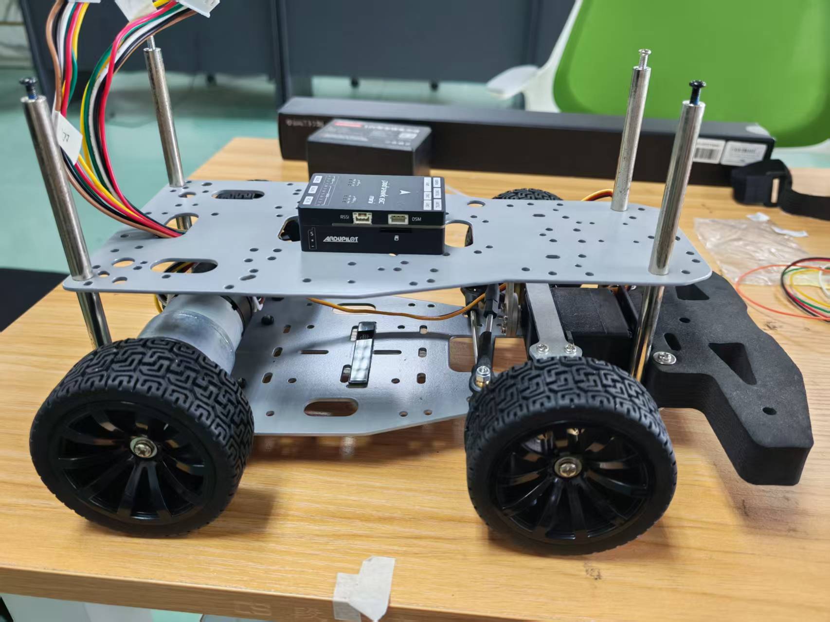

Hi yigitcan
Thank you very much for your reply. Yes, this is a wheeled robot platform; there may have been an issue with the translation software, as my description was translated as an “aircraft.” I want to configure it as a standard RC car (rear-wheel drive) using PX4 firmware. I have already removed the other sensors, and the remaining components are as follows:

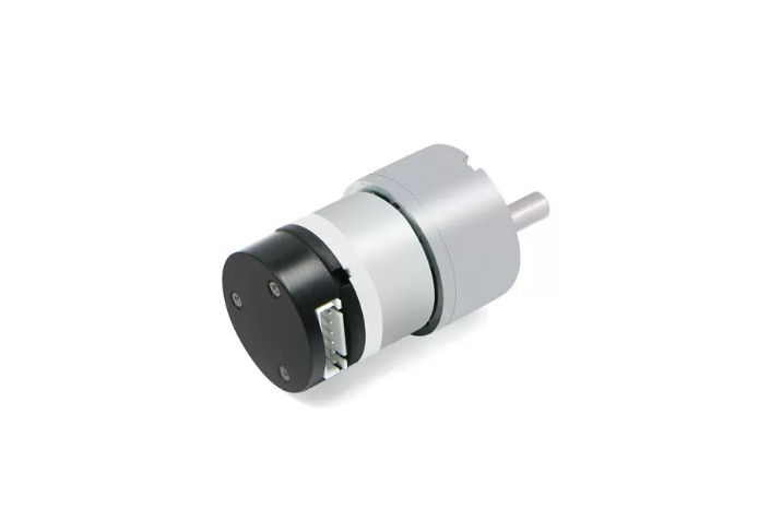

1、Two MG513 motors (with Hall encoders)
 ![image](https://discuss.px4.io/uploads/default/original/3X/9/c/9c18f4c1b8fe668eaa9508e227dc64bb2ec6c3c8.png)

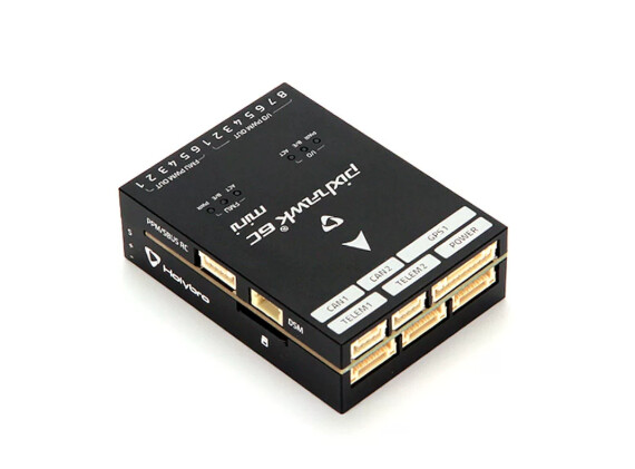

2、One Pixhawk 6C Mini
 ![image](https://discuss.px4.io/uploads/default/original/3X/b/9/b9bfa8df71be9f2a8ad1dcda2c818f74b9f6d7cd.jpeg)

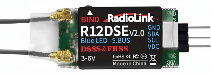

3、One SBUS receiver
 ![image](https://discuss.px4.io/uploads/default/original/3X/5/b/5b3f74310696a08ccf72732d07dca2b242712456.png)

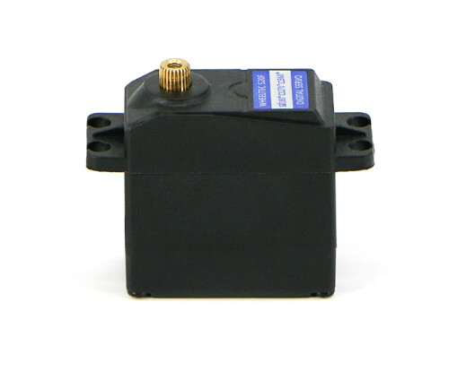

4、One S20F servo
 ![image](https://discuss.px4.io/uploads/default/original/3X/8/5/853f1e8d86dd3a6b1f65b7fa1396c82815252082.jpeg)
I will now answer the questions you raised:

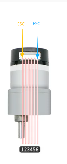

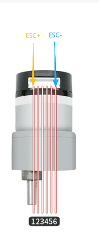

1、The motor model is the MG513 (with Hall encoder). I want to use the signal output from the Pixhawk 6C Mini to drive the motors, but I likely need to purchase two modules (Fire Phoenix ESCs) to facilitate communication between the motors and the flight controller. I am considering buying the modules shown in the image below; would this be feasible? I would appreciate your advice.
 ![image](https://discuss.px4.io/uploads/default/original/3X/3/4/3457793d3090704a4ff1dabf3bb1e5f65bfeec37.jpeg)
2、The left and right wheels are driven independently, and the steering system is controlled by a servo
3、I intend to use PX4 firmware.
4、Currently, I only need to implement remote control functionality.

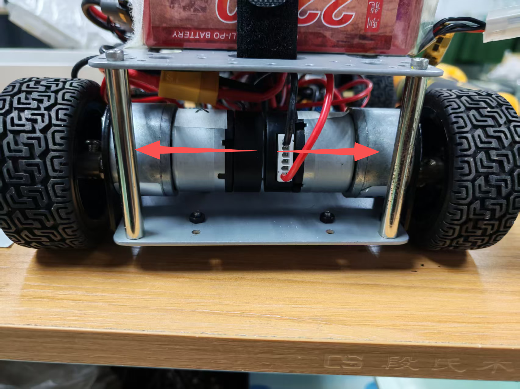

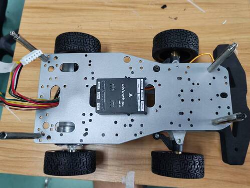

To better illustrate my issue, I have taken some photos showing the current state of the vehicle.
 ![4dbef1b55bb71658903367c567881012](https://discuss.px4.io/uploads/default/original/3X/f/0/f0093f7ff1c1597542772bb9cc977bae59a9ecee.jpeg)
 ![07935cabddc2506b4986b38839a8d33f](https://discuss.px4.io/uploads/default/original/3X/8/c/8cc0a6336e6f252b9d6f8fdfc8f2692cea86bcf7.jpeg)
I look forward to your suggestions. Thank you!@**[yigitcan-ozturk](https://discuss.px4.io/u/yigitcan-ozturk)**

Thanks for the additional information and photos. The configuration is much clearer now.
Based on your description, I would configure this as an **Ackermann-type rover** , not as a differential rover. You have two rear drive motors providing propulsion, while the S20F servo provides the steering. PX4’s Ackermann rover support is suitable for this type of arrangement even if the mechanical steering geometry is not strictly Ackermann.
For your first objective — **RC control only** — I would keep the system as simple as possible:
**SBUS receiver → Pixhawk 6C Mini → motor controller(s) + steering servo**
The Pixhawk should not drive the MG513 motors directly. The MG513 is a brushed DC geared motor, so you need a suitable brushed DC motor driver/controller between the Pixhawk and each motor (or one dual-channel controller).

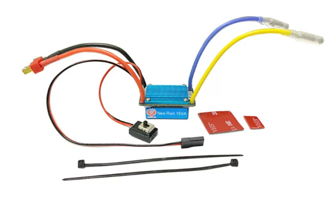

Regarding the Fire Phoenix modules in your photo: I would not purchase them yet solely based on the information shown in the picture.
Before choosing them, I would verify three things:
1. Do they accept a standard RC/PWM command signal compatible with the Pixhawk output?
2. Do they provide bidirectional motor control (forward/reverse)?
3. Can they safely handle the **stall current** of the MG513 motors at your battery voltage?
The third point is especially important. The normal/rated motor current is not sufficient for sizing the driver; the controller must tolerate the much higher startup/stall current.
There is also another approach worth considering. PX4 currently has support for the **Hiwonder 4-channel encoder motor controller** , including an I2C driver (`hiwonder_emm`) for brushed DC motors with encoder feedback. That could provide a more PX4-native integration path than using two generic motor controllers.
For the initial RC test, however, I would not introduce encoder feedback yet. First establish a minimal open-loop configuration:
- Flash the PX4 **rover firmware** onto the Pixhawk 6C Mini.
- Select **Generic Rover Ackermann** (`SYS_AUTOSTART = 51000` if needed).
- Connect the SBUS receiver to the RC input.
- Map the drive output(s) to **Throttle**.
- Map one PWM output to **Steering** for the S20F servo.
- Use **Manual mode** for the first test.
PX4 Manual mode does not require wheel-speed, GPS or position measurements for this basic RC operation.
One detail I would like to confirm before recommending the exact motor-controller wiring:
**Do you intend the two MG513 rear motors always to receive the same throttle command, or do you want PX4 to control the left and right rear motors independently?**
Because you already have mechanical steering through the servo, for a conventional RC-car configuration I would initially treat the two rear motors as propulsion and use the servo exclusively for steering rather than mixing differential steering into the rear motors.
Also, if you can provide the exact MG513 voltage/current specification (or a link/datasheet for the motor) and the model/specification of the Fire Phoenix controller, I can check whether that controller is electrically suitable before you buy it.
Once that is confirmed, I can also give you a concrete **Pixhawk 6C Mini → motor controller → MG513 + S20F wiring/output map**.

[MG513P30\_12V motor](https://www.wheeltec.net/product/html/?163.html)
[Fire Phoenix 160A](https://item.taobao.com/item.htm?abbucket=12&id=557664095039&mi_id=00000EEM9zdXl38we4TedNX_8z3WEFzLTO4DEMKOFbo5kkE&ns=1&priceTId=215040a017907676102088946e119f&skuId=3987689648363&spm=a21n57.1.item.2&utparam=%7B%22aplus_abtest%22%3A%2290bd2df2339dce6a887b119a895c57e8%22%7D&xxc=taobaoSearch)
Both the motor and the ESC module are from niche domestic brands. I am not sure if the product pages will display English descriptions for you; if not, please let me know, and I will translate the details and upload them here.
I have also verified the three points you raised:
1、It accepts standard RC/PWM command signals compatible with Pixhawk output.
2、It supports bidirectional motor control (forward/reverse).
3、The stall current for the MG513P30\_12V (model) is 3.2A, while the “Fire Phoenix” ESC module handles a continuous current of 35A and a peak current of 160A, so it should be capable of handling the load.
Regarding your question on whether I want the two rear MG513 motors to always receive the same throttle command or have PX4 control the left and right rear motors independently:
My current setup uses a servo motor for mechanical steering. Will this type of steering cause excessive tire wear? Does the PX4 firmware support the simultaneous use of two steering modes? (That is, triggering mechanical steering while varying the speeds of the two motors—one faster, one slower—which would likely require independent control via two ESC modules). If this isn’t supported, I will have to stick to using the servo motor for mechanical steering.
Additionally, I might use the second integration method you suggested later on (using the Hiwonder 4-channel encoder motor controller). I would like to ask: is the Hiwonder 4-channel encoder motor controller a main control module that can replace the Pixhawk 6C Mini, or are they meant to be used in series? If the Hiwonder controller replaces the Pixhawk 6C Mini, can I use an SBUS-protocol remote controller to operate the vehicle?

For the first test, I agree with your choice to stay with the Fire Phoenix ESC approach. Based on the specifications you provided standard RC/PWM input, bidirectional operation, 35 A continuous / 160 A peak capability versus the stated 3.2 A stall current of the MG513P30\_12V there is a very large current margin.
I would still do the first power-up with the wheels off the ground and verify neutral, forward/reverse direction and failsafe behaviour before putting the rover on the floor.

**SBUS receiver → Pixhawk 6C Mini**

For the initial configuration, both rear motors should receive the same propulsion command and the servo should provide the steering.
PX4 currently treats Ackermann and Differential as separate rover control architectures.
In Ackermann mode, direction is controlled through the steering actuator. In Differential mode, direction is generated by varying the speeds of the left and right drive wheels.
Therefore I would **not try to combine differential rear-wheel steering assistance with the mechanical steering servo for the first implementation**. That would effectively create a hybrid steering/control-allocation problem rather than using the standard Ackermann rover behaviour.
It is certainly possible to investigate such a controller later, but I would treat that as a separate development step rather than part of the initial hardware bring-up.

Mechanical steering itself should not inherently cause excessive tire wear. Cars and other conventional wheeled vehicles use this principle.
What matters much more is the steering geometry: wheel alignment, toe, steering angles, wheelbase and the relationship between the inside and outside wheel angles during a turn.
PX4 also does not require a mechanically perfect Ackermann linkage; it supports front-steering rovers generally.
So I would first make the mechanical steering work correctly and keep both rear motors at the same commanded propulsion level.

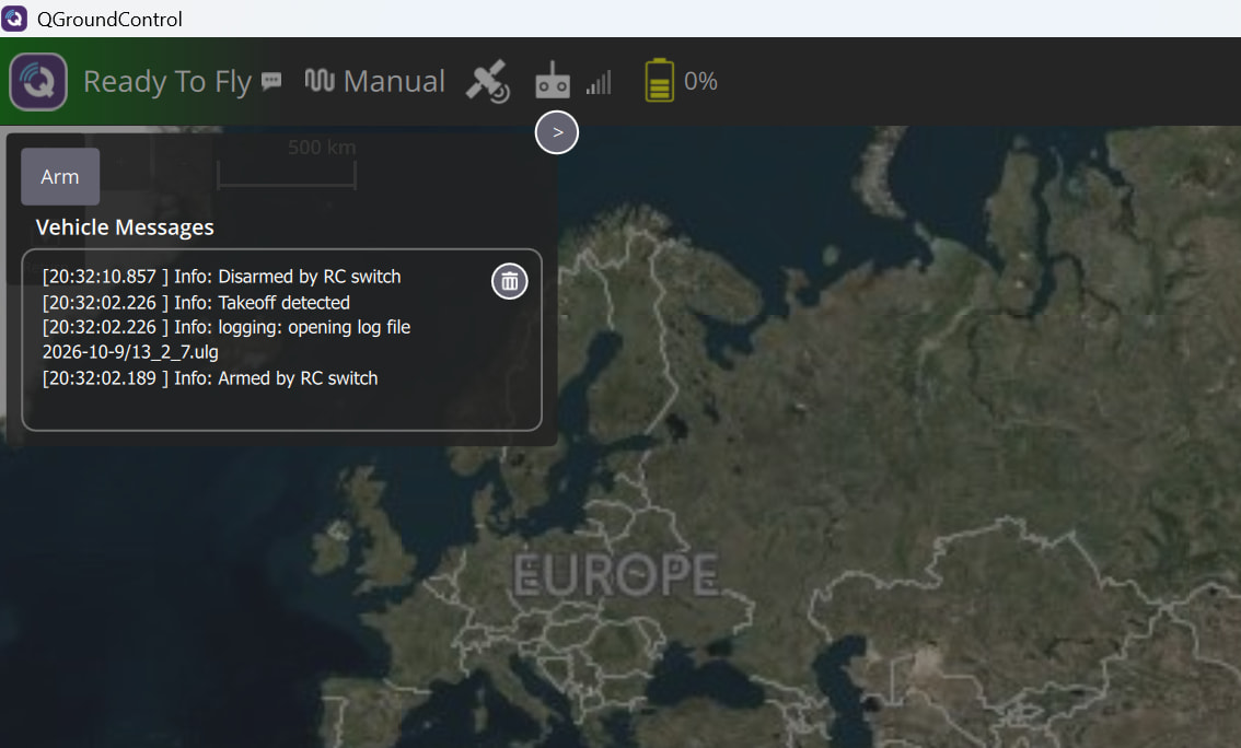

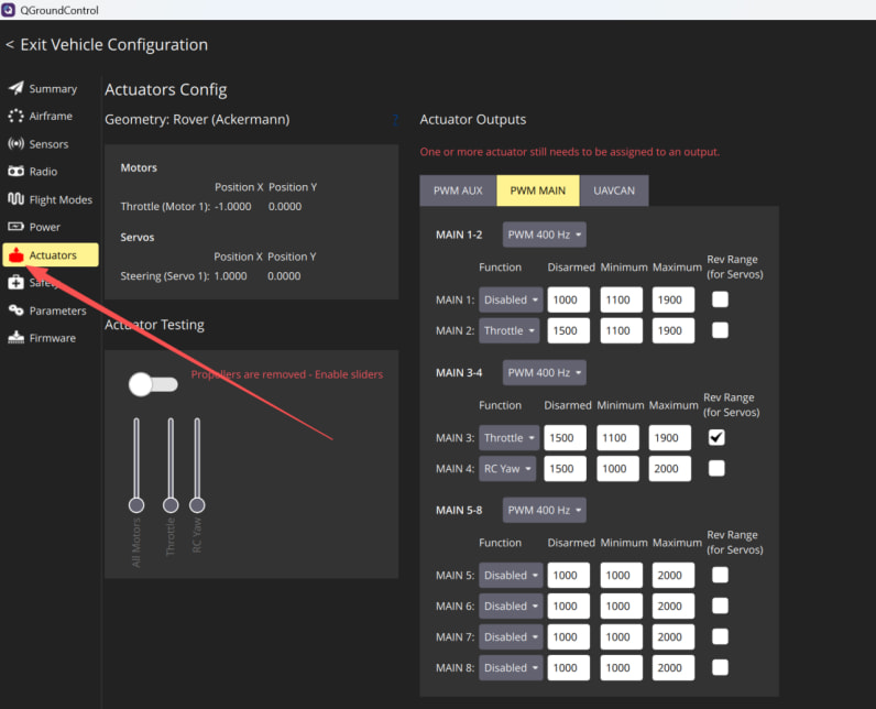

**Post date:** [October 9, 2026, 8:58am UTC](https://discuss.px4.io/t/hardware-selection-for-autonomous-vehicles/49543/11 "2026-10-09T08:58:18Z")
Hi yigitcan

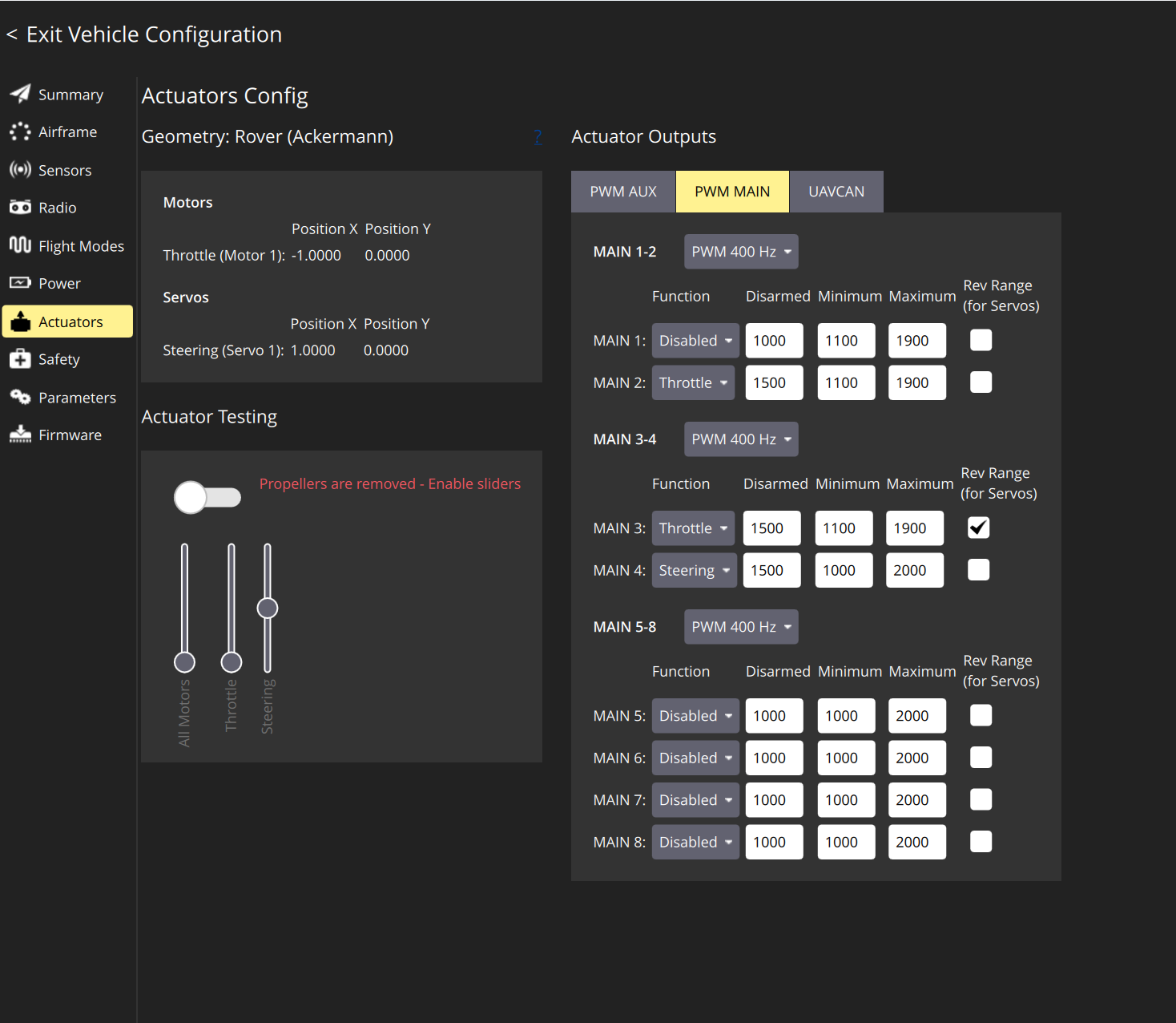

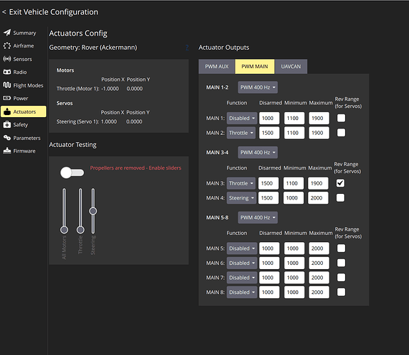

I need to ask for your help again. I flashed the [`px4_fmu-v6c_default.px4` firmware (v1.16.0 Stable Release).](https://github.com/PX4/PX4-Autopilot/releases?page=2#release-v1.16.0) When I set `SYS_AUTOSTART` to `1104`, the parameter fails to save; I even tried `50000` and `50001`, but those also failed. However, if I set `SYS_AUTOSTART` to `4001` (generic quadcopter), the parameter saves successfully. I have uploaded a video here to better illustrate the issue.
> **[2026-10-09 16-26-03.mp4](https://drive.google.com/file/d/1qVwwj92tUyLNkX2ELFzp3GUBn_-NK8d5/view?usp=sharing)**
> Google Drive file.
Suspecting a firmware bug, I flashed version v1.17.0, but the result was the same. I am wondering if you have ever encountered this situation. I look forward to your reply—thank you very much.@**[yigitcan-ozturk](https://discuss.px4.io/u/yigitcan-ozturk)**
**Post date:** [October 9, 2026, 9:10am UTC](https://discuss.px4.io/t/hardware-selection-for-autonomous-vehicles/49543/12 "2026-10-09T09:10:59Z")
Hi Rik,
Thanks for the detailed report and the video.
I checked the PX4 v1.16.0 release information and the `px4_fmu-v6c_default` board configuration. I think we have identified the likely reason for the behaviour you are seeing.
Starting with PX4 v1.16, rover support was restructured and a dedicated rover firmware build was introduced.

**Author:** ![Rik\_Sam](https://discuss.px4.io/user_avatar/discuss.px4.io/rik_sam/32/22130_2.png) [@Rik\_Sam](https://discuss.px4.io/u/Rik_Sam)\
**Post date:** [October 10, 2026, 7:42am UTC](https://discuss.px4.io/t/hardware-selection-for-autonomous-vehicles/49543/13 "2026-10-10T07:42:27Z")
Hi yigitcan,
Thank you very much for your reply. Following your suggestions, I found the [`px4_fmu-v6c_rover.px4`](https://github.com/PX4/PX4-Autopilot/releases?page=2#release-v1.16.0) firmware on GitHub and successfully got my rover up and running. Here is a video of it in operation.
> **[VID\_20261010\_105451.mp4](https://drive.google.com/file/d/1H_Vq7lS1rmnU_1c4LMBZGNL60wcVNy5l/view?usp=sharing)**
> Google Drive file.
I am not sure if my configuration is correct (as the red light in the QGC “Actuators” tab has not disappeared), so I am sharing my settings here and would appreciate your feedback.
 ![image](https://discuss.px4.io/uploads/default/original/3X/3/2/32eced42a6c95691aa129034a533dda430c2bfa3.jpeg)
SYS\_AUTOSTART=51000 (Generic Ackermann Rover)
Pixhawk–M2 → ESC 1 → Left MG513 → PWM\_MAIN\_FUNC2=Throttle
Pixhawk–M3 → ESC 2 → Right MG513 → PWM\_MAIN\_FUNC3=Throttle
Pixhawk–M4 → S20F Servo → Mechanical Steering → PWM\_MAIN\_FUNC4=RC Yaw
PWM\_MAIN\_DIS2=1500
PWM\_MAIN\_DIS3=1500
PWM\_MAIN\_DIS4=1500
PWM\_MAIN\_REV=4
I also noticed a slight lack of synchronization between the speeds of the two motors; I am not sure if this is due to using two separate ESCs for independent control. To better illustrate the issue, I have uploaded another video here.
> **[VID\_20261009\_181822.mp4](https://drive.google.com/file/d/1GVKW1AgtfomfC1nG__C-ujnmfcLCaZD2/view?usp=sharing)**
> Google Drive file.
Of course, it is only a slight desynchronization, so it won’t have a major impact for the time being; I was wondering if you have ever encountered a similar situation.
Thanks again for your reply!@**[yigitcan-ozturk](https://discuss.px4.io/u/yigitcan-ozturk)**
**Post date:** [October 10, 2026, 8:29am UTC](https://discuss.px4.io/t/hardware-selection-for-autonomous-vehicles/49543/14 "2026-10-10T08:29:56Z")
Hi Rik,
Great progress! I’m glad the dedicated `px4_fmu-v6c_rover.px4` firmware resolved the airframe issue and that your rover is now moving.
Thanks for sharing the configuration and videos.
I would check a few things before considering the actuator configuration complete.
**1. Steering output assignment**
Your current assignment is:
- M2 → Throttle → Left ESC
- M3 → Throttle → Right ESC
- M4 → RC Yaw → Steering servo
The first two assignments are consistent with your intention to use a common throttle command for both motors.
However, I would change **M4 from `RC Yaw` to the dedicated rover `Steering` actuator function** , if available in your PX4 rover configuration.
`RC Yaw` is an RC passthrough function, whereas the rover steering actuator is intended to receive commands from the Ackermann control architecture. This distinction matters particularly if you later use other supported drive modes.
**2. Red indicator in QGroundControl**
I would not assume the red indicator is harmless simply because the rover moves.
Could you share a close-up screenshot showing the exact red indicator and any associated warning or tooltip?
We should determine whether it represents an unassigned actuator, incomplete configuration, output state or another warning before changing additional parameters.
**3. Disarmed PWM values**
You have set:
`PWM_MAIN_DIS2=1500`
`PWM_MAIN_DIS3=1500`
`PWM_MAIN_DIS4=1500`
For bidirectional ESCs, 1500 µs may be the neutral command, but this must be confirmed against the Fire Phoenix ESC specifications.
For the steering servo, 1500 µs is a common centre position.
With the wheels safely raised and the system disarmed, verify that neither drive motor rotates and that the steering servo stays in a safe neutral position.
Also verify the ESC behaviour during RC signal loss and PX4 failsafe activation.
**4. Output reversal**
Your current `PWM_MAIN_REV=4` should also be checked.
This parameter is a bitmask, not an individual PWM channel number. A value of 4 corresponds to bit 2, normally affecting the third output channel (M3), not M4.
Please confirm that the resulting motor and steering directions are correct.
**5. Difference between left and right motor speeds**
A slight speed difference is quite possible when using two brushed DC motors with separate ESCs in open-loop control.
Even if PX4 sends the same throttle command to both ESCs, the actual speeds can differ due to:
- ESC neutral/deadband calibration
- Motor manufacturing tolerances
- Gearbox friction
- Battery voltage and wiring losses
- Different mechanical loads
I suggest first confirming that M2 and M3 receive identical PWM commands for the same throttle input.
Then, with the wheels raised, compare the motor behaviour at low, medium and higher throttle settings. Start at low throttle and keep the tests brief.
If possible, measure the motor speeds using the Hall encoders. This would tell us whether the difference comes from the command signals or the motor/ESC response.
**An important distinction:** Sending identical throttle commands to two ESCs does not provide closed-loop speed synchronization.
If matched wheel speeds become important, encoder-based speed feedback and an appropriate controller would be the next development stage.
For now, I would prioritize:
1. Correcting and validating the steering function.
2. Identifying the red actuator warning.
3. Verifying disarmed, neutral and failsafe behaviour.
4. Checking whether M2 and M3 receive identical throttle commands.
You have already achieved a useful first milestone. Once these checks are complete, we can move toward a more reliable and reproducible rover configuration.
Well done on getting the system running!
**Post date:** [October 10, 2026, 12:37pm UTC](https://discuss.px4.io/t/hardware-selection-for-autonomous-vehicles/49543/15 "2026-10-10T12:37:29Z")
Hi yigitcan,
1、I have changed PWM\_MAIN\_FUNC4 from RC Yaw to steering based on your suggestion, and the red alert in the QGC Actuators tab has disappeared.
 ![image](https://discuss.px4.io/uploads/default/original/3X/9/4/9448d038640c5c56a06b20d16f22bb6d94be512a.jpeg)
 ![image](https://discuss.px4.io/uploads/default/original/3X/8/e/8e573476e34814fa2ec92025992006921eab9265.png)
2、Since I have configured my ESC for bidirectional mode, setting `PWM_MAIN_DIS X=1500` works correctly; this setting is necessary for the rover to reverse. If I were to use the default value of `PWM_MAIN_DIS X=1100`, the rover would continuously reverse immediately after arming.
3、As for why `PWM_MAIN_REV` is set to 4, let me explain: the wiring sequence for both motors is identical—neither has been reversed—but since the motors are mounted in opposite directions, one of them must be configured to run in reverse to achieve synchronized movement.
 ![f2343be2-e955-43cd-911b-a5f69c80844e](https://discuss.px4.io/uploads/default/original/3X/4/c/4cfcc3b3c28306e7656405af4bdccebee7077b9b.jpeg)
 ![c4413163-dd77-4993-b013-b8c2306008a1](https://discuss.px4.io/uploads/default/original/3X/7/0/70d7986f9c830a8b032797a4b770c2c589c415a6.png)
4、Regarding the issue of motor speed differences: the problem seems much less noticeable after I recalibrated the ESC throttle range.
It looks like there aren’t any major issues with this rover.
@\*\*[yigitcan-ozturk](https://discuss.px4.io/u/yigitcan-ozturk)\*\*Thank you so much, yigitcan! Your suggestions helped me resolve a lot of issues; this has been a very useful thread. I plan to continue optimizing this rover—perhaps by adding GPS or RTK for route planning.

**Post date:** [October 10, 2026, 1:59pm UTC](https://discuss.px4.io/t/hardware-selection-for-autonomous-vehicles/49543/16 "2026-10-10T13:59:45Z")
Hi Rik,
That’s excellent progress! Thank you for sharing the detailed results and explaining your configuration.
I’m glad switching M4 from RC Yaw to the dedicated Steering function resolved the QGroundControl actuator warning.
Your explanation of `PWM_MAIN_REV=4` also makes sense. Since the two motors are mounted in opposite orientations, reversing the appropriate motor output is a reasonable solution.
Likewise, your use of 1500 µs as the neutral PWM value is consistent with your bidirectional ESC configuration. It’s particularly important that the motors remain stationary at neutral and behave safely during disarming and failsafe conditions.
The improvement after recalibrating the ESC throttle ranges is also a useful diagnostic result. It suggests that differences in ESC calibration were contributing to the motor speed mismatch, although encoder measurements would be needed to quantify the remaining difference.
