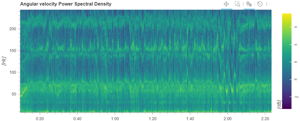

I’m currently trying to filter out the gyro noise using 2 static notch filters and a low-pass filter. I’m not sure if the settings are appropriate, and also worried about the negative effect of mechanical vibration ( maybe other noise).
According to the **Angular Velocity Power Spectral Density** diagram shown below, I set the FRQ and BW of the notch filter for fundamental frequency as (76Hz, 20Hz) and (150Hz, 20Hz) for the 2nd. harmonic.

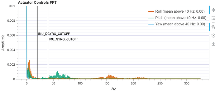

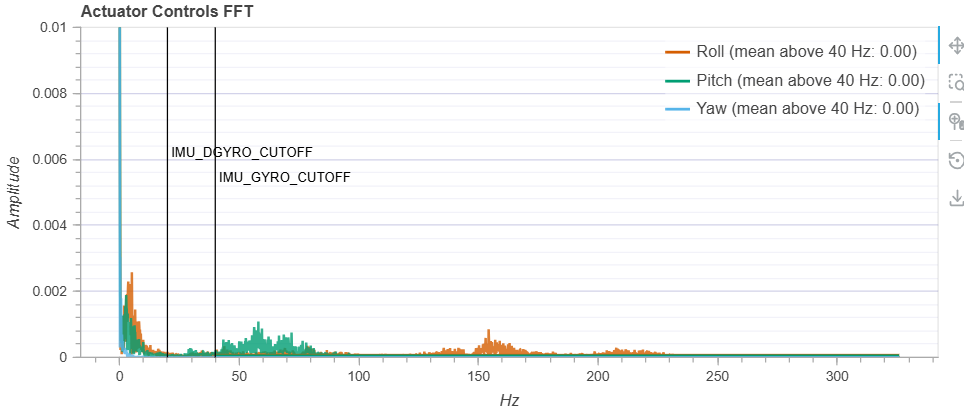

And based on the **Actuator Controls FFT** , I set the low-pass filter to 40Hz, 20 Hz for `IMU_Gyro_CUTOFF` and `IMU_DGYRO_CUTOFF`, respectively

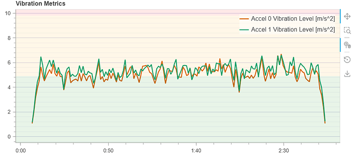

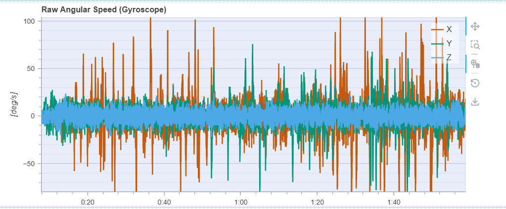

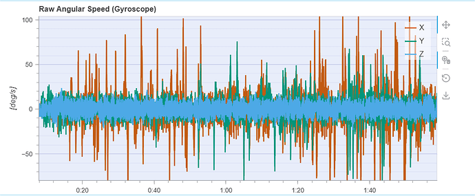

The question is: **Raw Angular Speed (Gyroscope)** diagram seems very _excessively noisy_, as shown below. Do you think this may indicate potential mechanical vibrations (I also attached Vibration Metrics below for reference) or other kinds of noise? Or maybe it’s normal, I shouldn’t worry too much about this, and just step into rate pid tuning?
 ![屏幕截图 2026-05-18 120611](https://discuss.px4.io/uploads/default/original/3X/7/a/7a4e422f0e3d5bed7db5e9d51a9e310d654888e4.png)
 ![屏幕截图 2026-05-18 122350](https://discuss.px4.io/uploads/default/original/3X/b/b/bb7c46d09643d173d2c060be80d310956cfb7f65.png)
