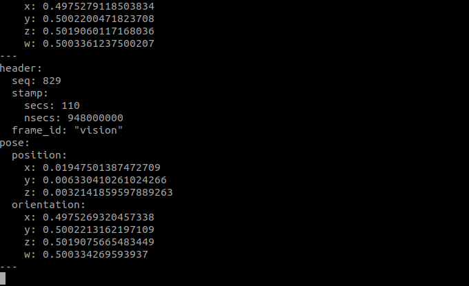

  • VINS output appears correct in Rviz
  • /mavros/vision_pose/pose publishes at 30Hz with valid data

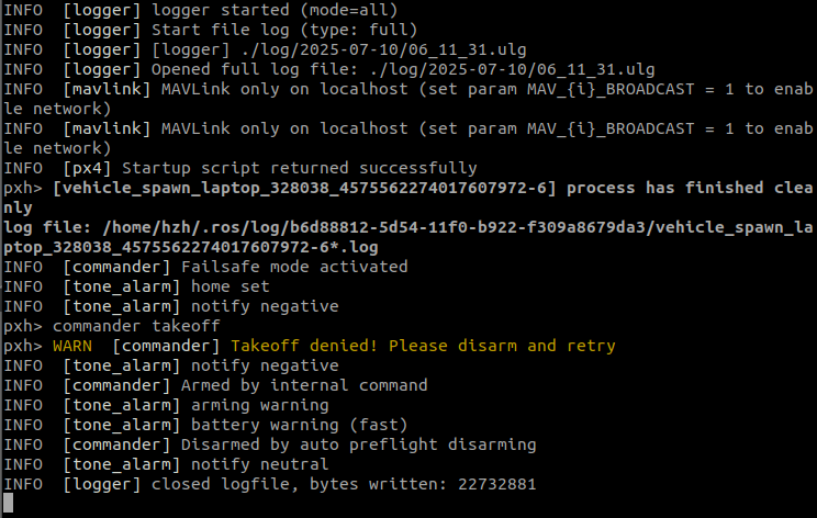

  • commander check shows Prearm OK:
    [HealthFlags] VIO: // No EN/OK indicator! [HealthFlags] POS: // Empty status

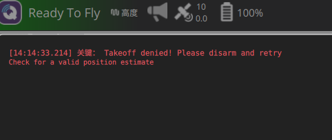

  • Takeoff command fails:
    commander takeoff # ERROR: Takeoff denied! Please disarm and retry # ERROR: Check for a valid position estimate

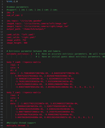

  1. VINS–config
    add iris_stereo_config.yaml left.yaml right.yaml

Screen shot
  1. rostopic echo /mavros/vision_pose/pose
  2. commander takeoff
  3. QGC
Is there any information I can provide?
What should I do for this problem?
