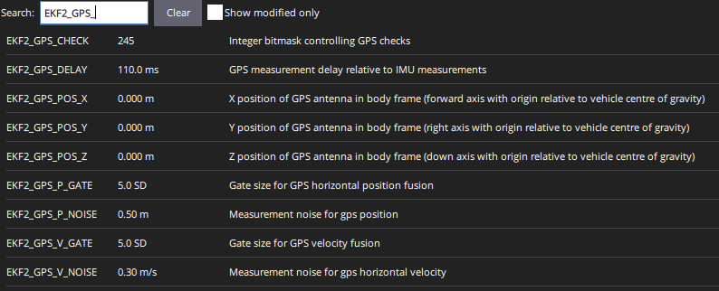

 ![image](https://discuss.px4.io/uploads/default/original/2X/a/ada910a735c61c092377a7460773f58da4f0f53b.png)
Always Result = Timeout.
EK2\_GPS\_CTRL no in QGC
 ![image](https://discuss.px4.io/uploads/default/original/2X/4/4489a626d2bde051ffcc61e4201a4e6cd23fc319.png)
You may have made a mistake in your suggestion to set EKF2\_GPS\_CTRL to zero, because ‘0’ is not turning off GPS:
![image](https://discuss.px4.io/uploads/default/original/2X/b/b3deb571e30b562d20034acd0b23a4b518af79d1.png)
But thanks a lot for the tips anyway. 🥳
