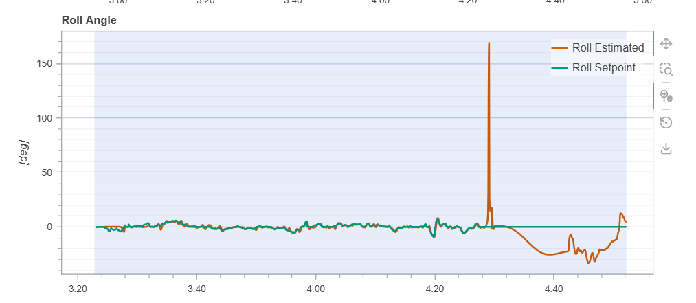

Hi everyone,
I’m trying to understand why PX4 triggered **Flight Termination** during flight.
### Setup
- **PX4 Version:** _1.16.2_
- **Flight Controller:** _MicoairH743_
- **Vehicle:** Quadcopter
### What happened
The vehicle was flying normally when PX4 reported an **Attitude failure (pitch)**. Immediately after that:
- Flight Termination was triggered.
- The aircraft disarmed in mid-air.
- The motors stopped, and the vehicle fell to the ground.
The aircraft did **not** visibly roll or pitch before the disarm.
### What I observed
- Flight Review shows the **estimated roll suddenly jumps to ~170°** , while the roll setpoint remains near 0°.
- A vibration spike occurs at the same time.
1. What could cause the EKF to suddenly estimate a ~170° roll when the vehicle did not actually roll?
2. Can accelerometer clipping or vibration cause this type of attitude failure?
3. Are there any additional log topics I should check to identify the root cause?

I don’t know why the estimator is wrong. It was hovering for almost a minute and then suddenly estimator detects high degree of roll/pitch and it throws altitude failure, and triggers flight termination.

Yes, that happened because there was an erroneous roll/pitch estimation. To compensate for the perceived attitude error, the motors were driven at a high PWM. However, no actual roll or pitch was observed. This ultimately led to flight termination, as the Failure Detector (FD) detected a roll/pitch angle exceeding the configured threshold of 60°. After this, Ekf losses confidence on attitude estimator and triggers flight termination via FD.
I was not able to know why EKF estimates the high degree of roll/ pitch.
Propellers were tight while checking after the crash. Same has been happened multiple times with both PX4 v1.15.2 and 1.16.2.

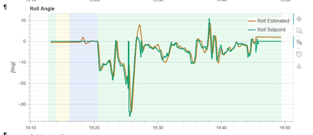

Why would your IMU perceive or produce a roll/pitch angle that did not occur?
When was the last time you calibrated your gyroscopes and acceleromters?
I don’t see the exagerated estimated roll and pitch angles on your second flight review that I see on the first.

Well its good you can rule out sensor calibrations.
The estimated roll and pitch angles are different between the two flight reviews. However, there is high anglualr accelerations on both flight reviews. If there is too much distance between your Center of Mass and IMU, you could get higher than expected accelerations.
ArudPiolot documentaion about Center of Mass and IMU placement problems.“For example if the autopilot was placed on the nose of a vehicle and the vehicle suddenly leans back (i.e. rotates so that its nose points up) with no offset compensation the vehicle velocity estimate would momentarily show the vehicle is climbing when it’s not.” [Sensor Position Offset Compensation — Plane documentation](https://ardupilot.org/plane/docs/common-sensor-offset-compensation.html)
Well its going to be a process of elimination, and there are people here that know more about PX4 autopilot than me.
Let us know what the fix is.
