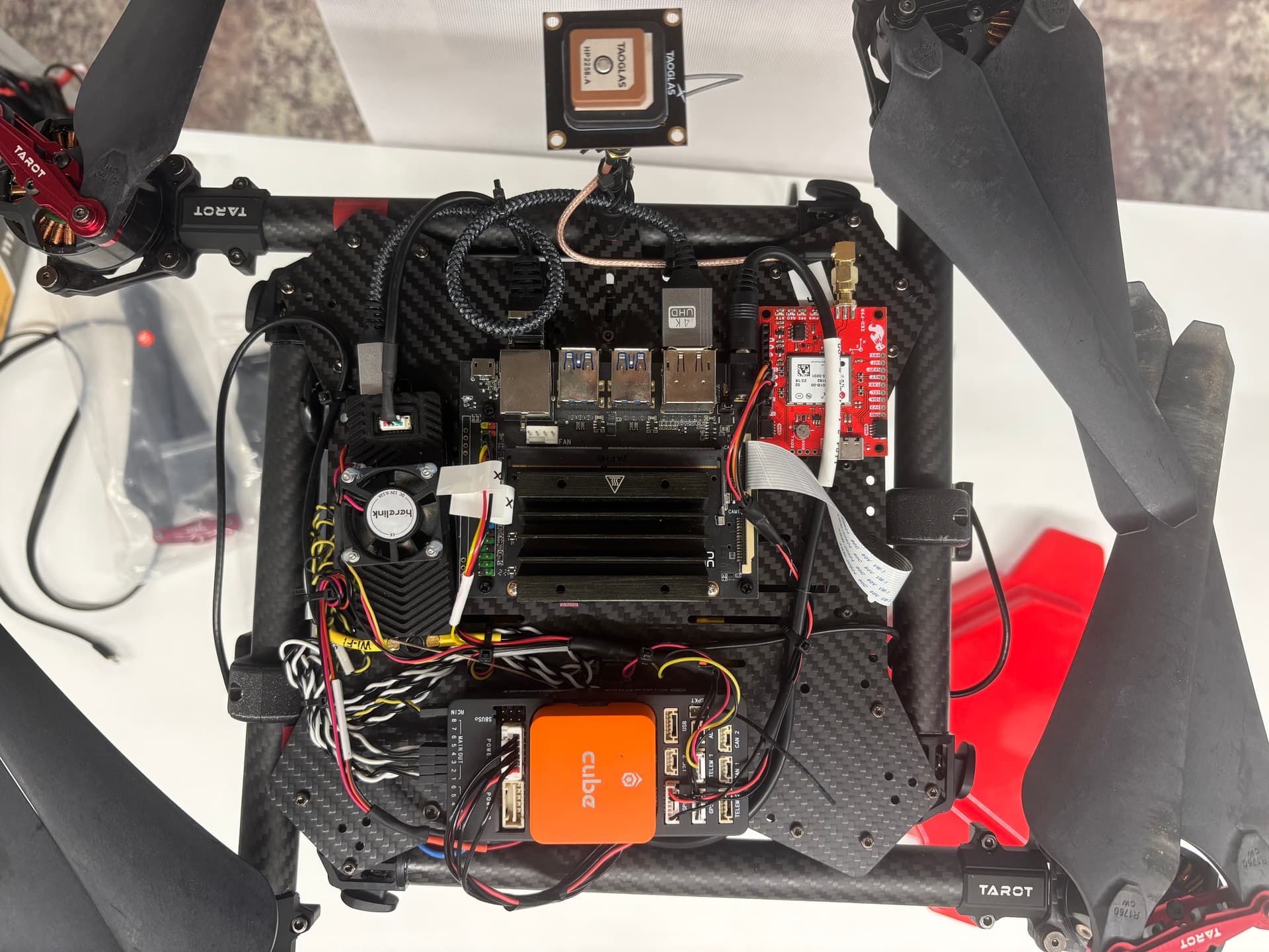

This is roughly how it was originally mounted.
 ![GetAttachmentThumbnail](https://discuss.px4.io/uploads/default/original/3X/9/8/985437dc134a8e37d1109975ba1e013217460e6b.jpeg)

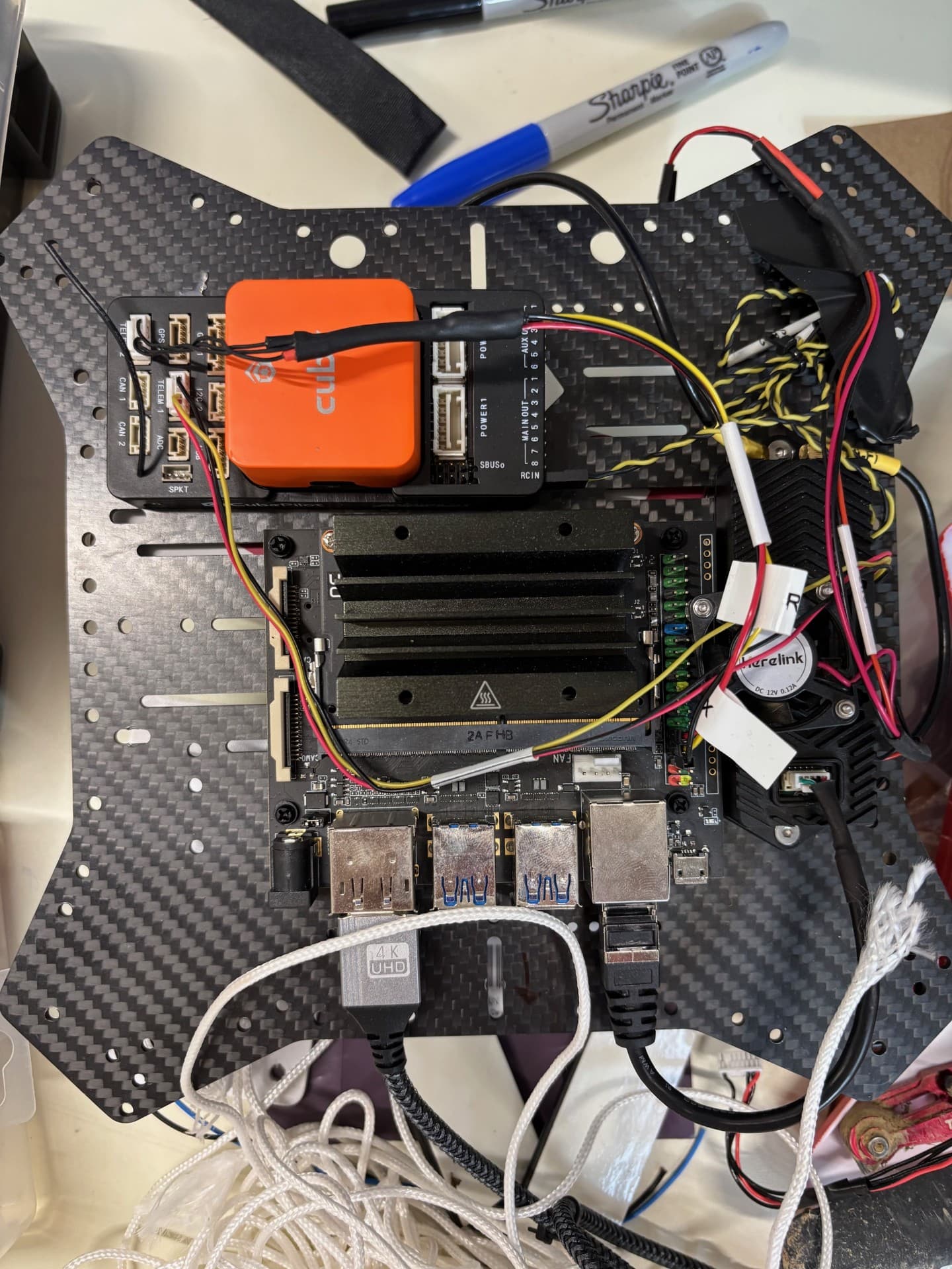

I now used double sided foam pads to mount all electronic components and zip tied all cables. I hope this will resolve the issues. I also plan to do the next flight in stabilized mode like you recommended! And will keep an eye on the GPS readings while doing so.

**Post date:** [August 10, 2025, 11:17pm UTC](https://discuss.px4.io/t/flight-log-analysis-drone-crash-erratic-flight-height/46656/4 "2025-08-10T23:17:44Z")
How is the Cube fixed to the carbon plate? I suggest to use double sided tape usually.
The setup looks overall pretty clean. One note is that it might be worthwhile to set the IMU offset from center using these params: [EKF2\_IMU\_POS\_X](https://docs.px4.io/v1.15/en/advanced_config/parameter_reference.html#EKF2_IMU_POS_X), etc.
