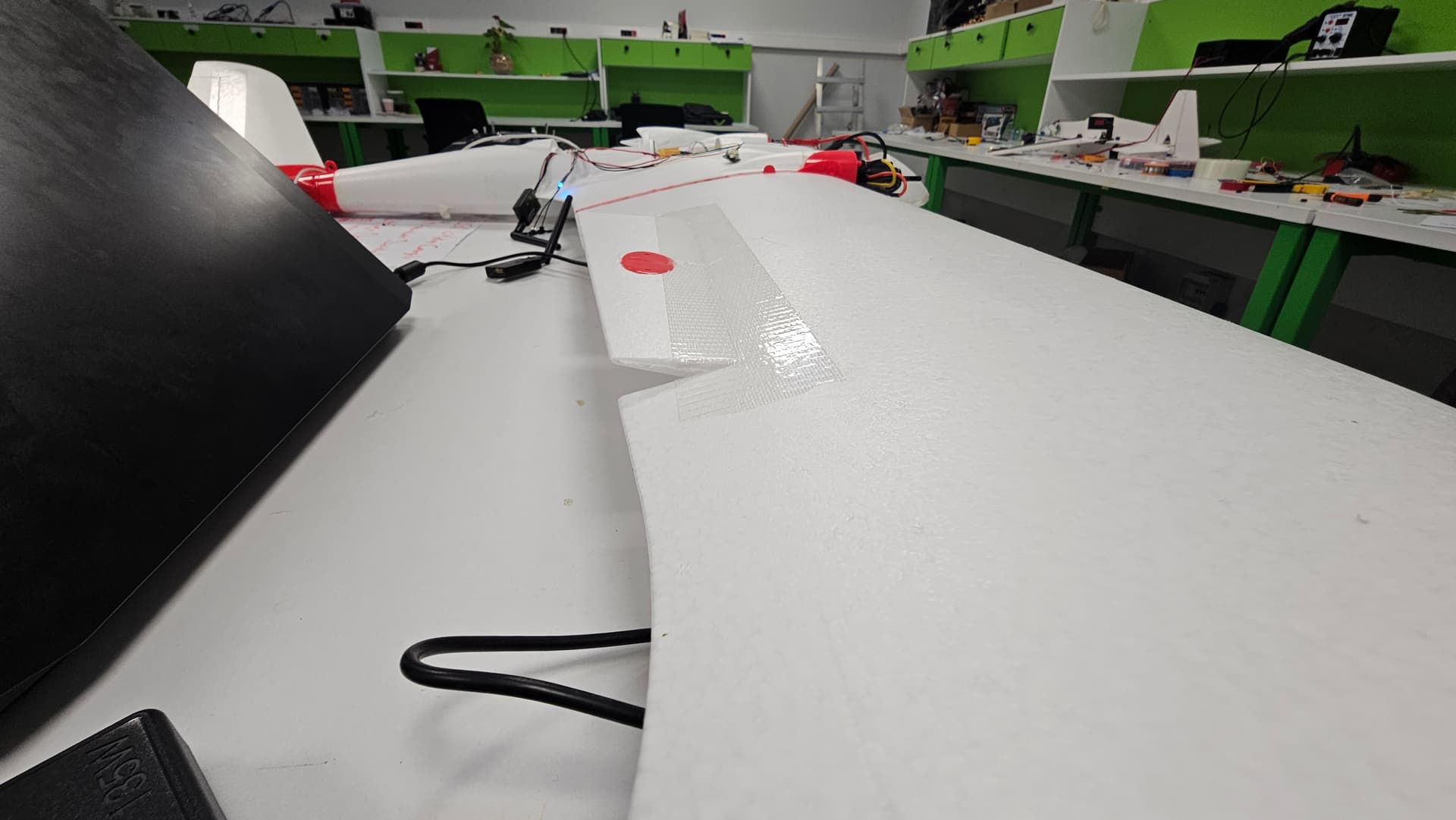

Hello, i tried adding flaps to ailerons and assigning it to a channel on my rc, when i flip the switch it either acts as extended flaperons or spoilers. Is there a way to just retract them to normal ailerons after takeoff ?

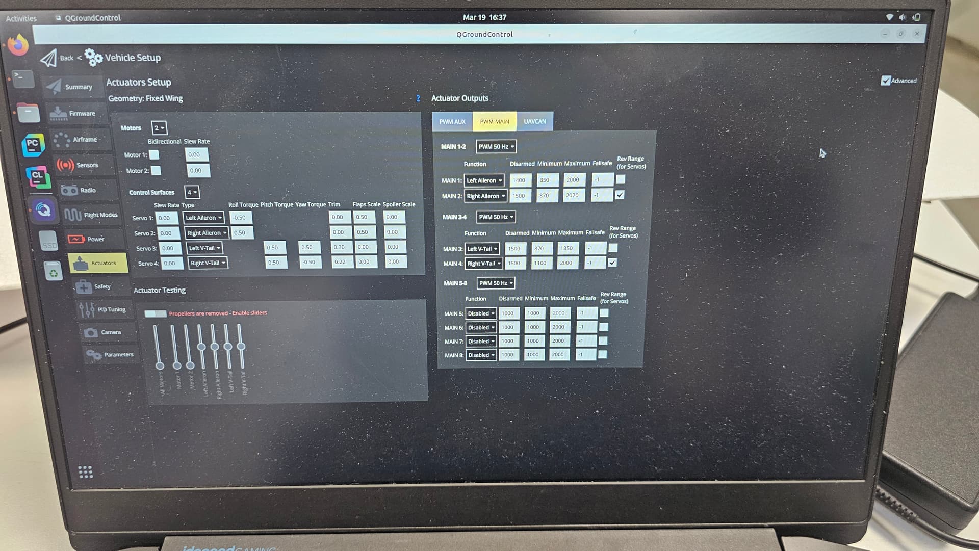

Can you give a bit more context? Maybe a screenshot of your config? Params you set? What versions you’re using, and all the various channels you have assigned? I don’t think we can answer your question without a bit more information.

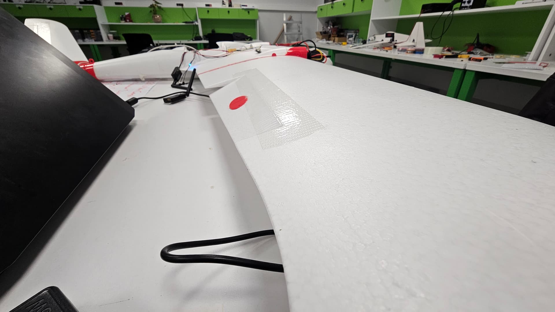

So when i switch the assigned flaps channel, flaperons deflect down, but when i want to retract them they dont retract to normal position, instead they retract up and start acting like “spoilerons”.

I wonder why no solution until now, i sent what you asked @JulianOes
I also encountered the same issue. It appears that after deploying the flaps, the neutral position has shifted. My temporary solution was to add a downward offset.
