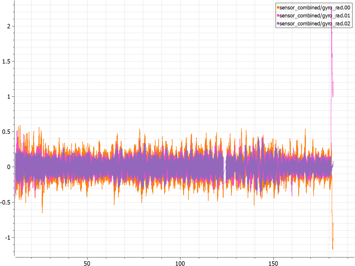

 ![Combined Gyroscope](https://discuss.px4.io/uploads/default/original/3X/1/e/1ee6fbc5f9b308579356af1991951e5e62abaeea.png)

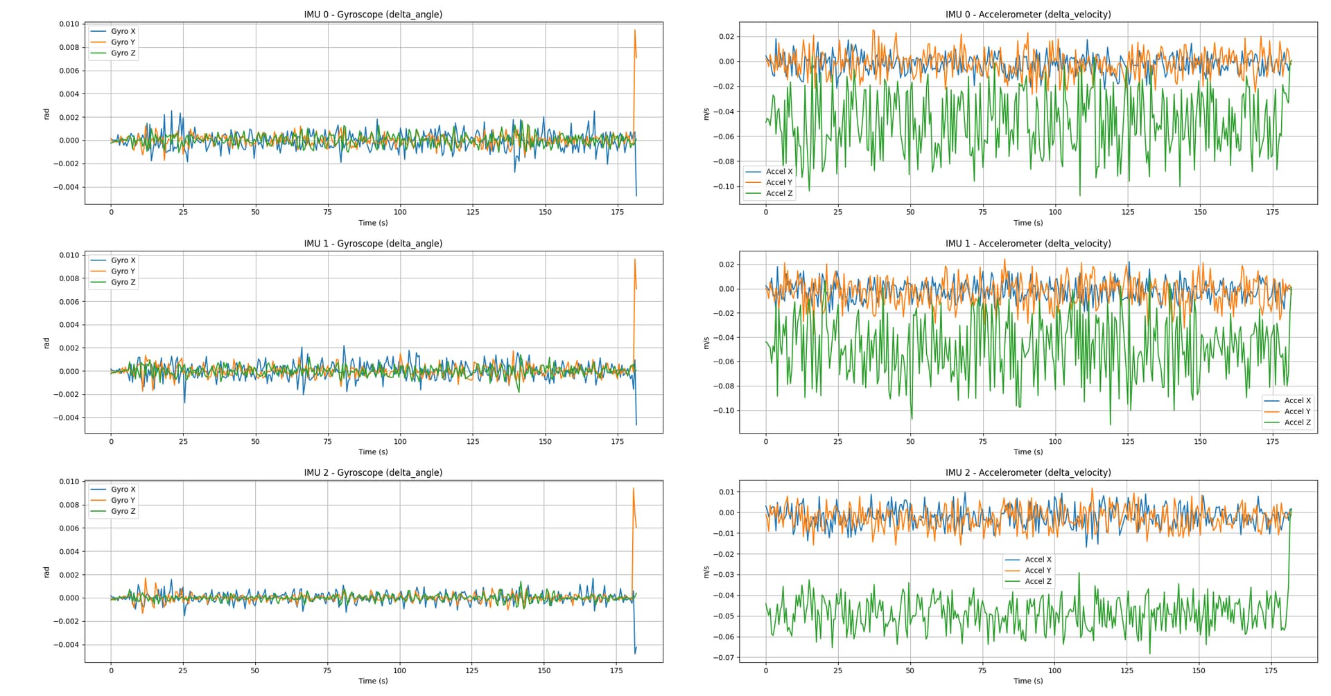

An explanation of the Flight Performance and moments until the sudden change in events was simply an extended Hover Test. Takeoff and climb to about 6M and then Hover.
 ![IMU State Estimator](https://discuss.px4.io/uploads/default/original/3X/8/5/8580c7d3e75b98dcc7f88ac02290bbdaf90e8344.jpeg)
The Drone was Hovering for about 3minutes until the sudden change in IMU readings, specifically the Gyroscopes. All three redundant Gyros reported an extremely aggressive change in angular movement that in turn caused the Drone to react and effectively flip on itself. It responded to what it thought was a valid input.

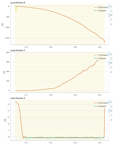

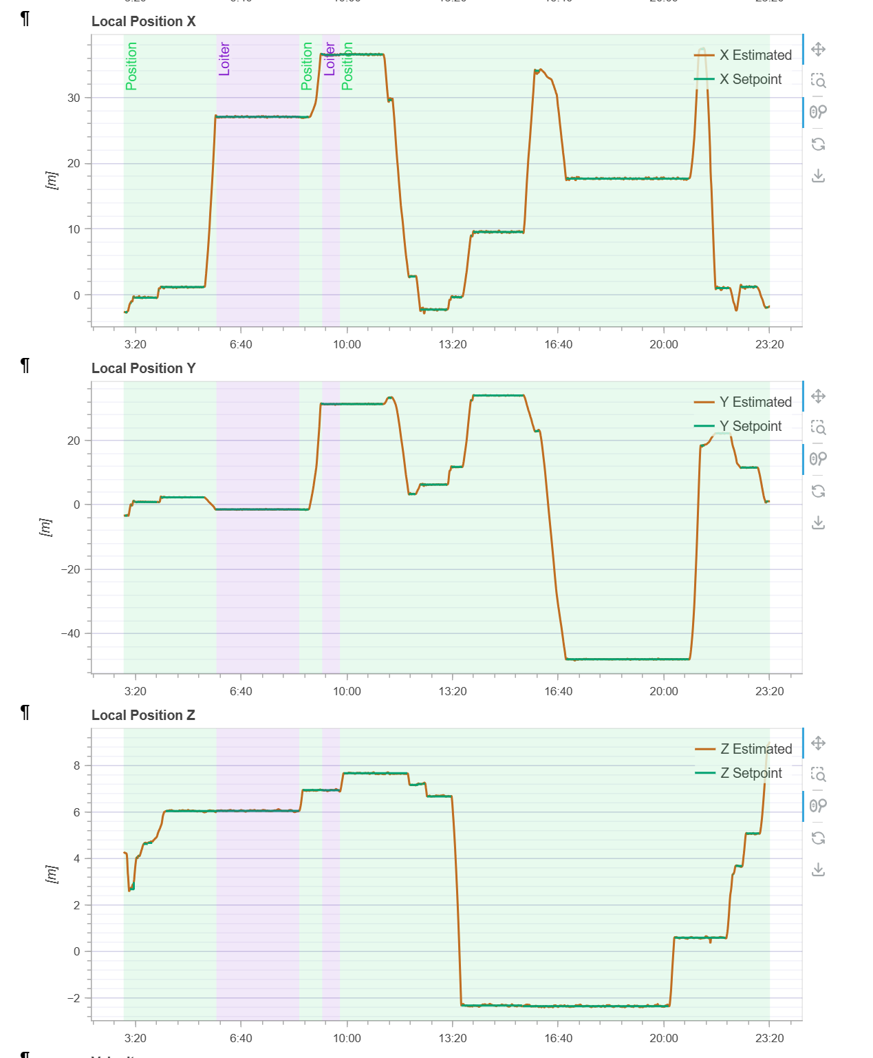

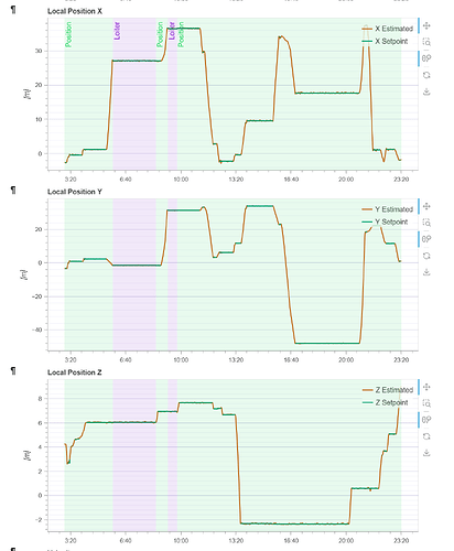

Again my crude theory is some sort of faulty calibration in the open field, something didn’t set right and led to a build up / aliasing and cascading effect where eventually the system rejected its own state, because while the Drone was hovering it thought it was moving ~1000 meters.

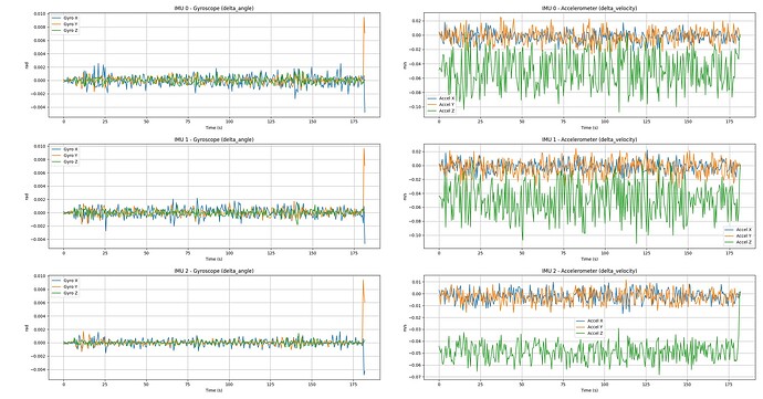

 ![image](https://discuss.px4.io/uploads/default/original/3X/1/a/1a30e54c1dac59e9c1b58a52800551c2566ae693.png)

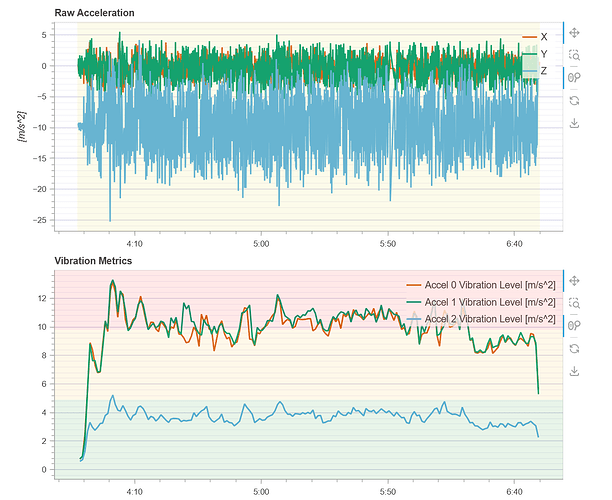

Could excessive vibrations lead to a build up errors on the IMU?
 ![image](https://discuss.px4.io/uploads/default/original/3X/e/a/eabf7d778339caa4c3402ffffe0027c8fc5a721f.png)

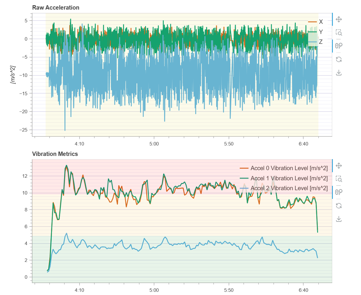

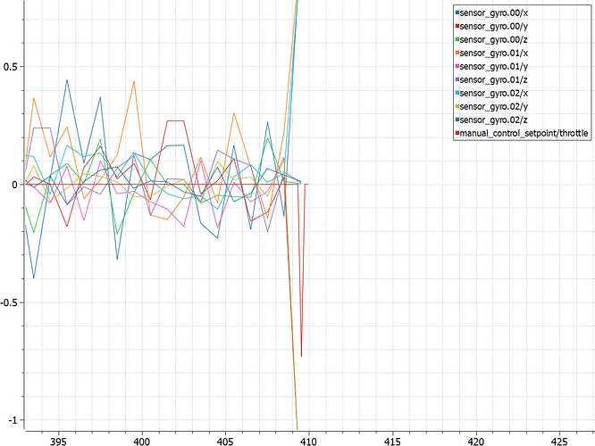

The seemingly sudden change in IMU readings before throttle input is simply puzzling me.
 ![3x Gyro Trigger Before Throttle Input](https://discuss.px4.io/uploads/default/original/3X/5/3/539078f7248d3bec37e555f01fa8700dfd3dc074.png)

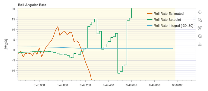

Sorry about the crash.

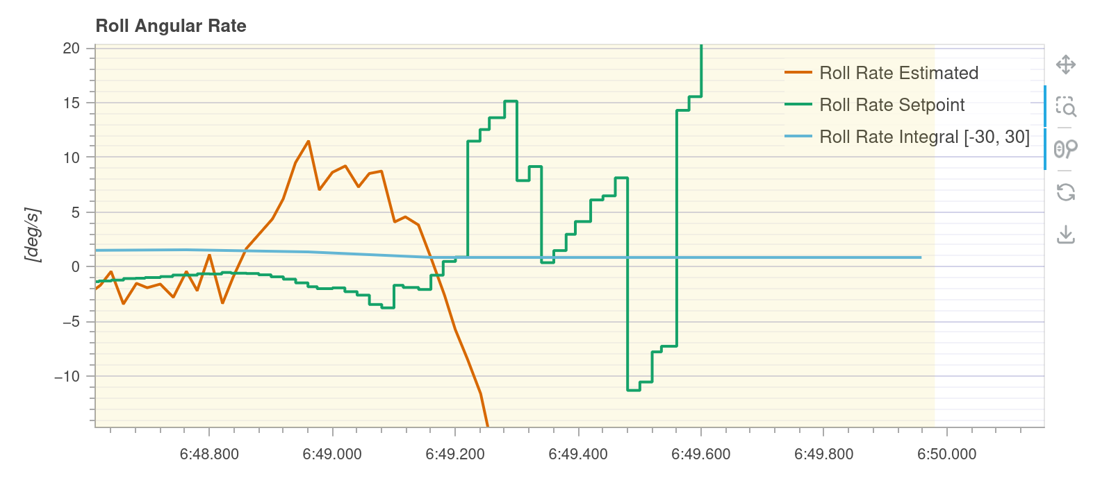

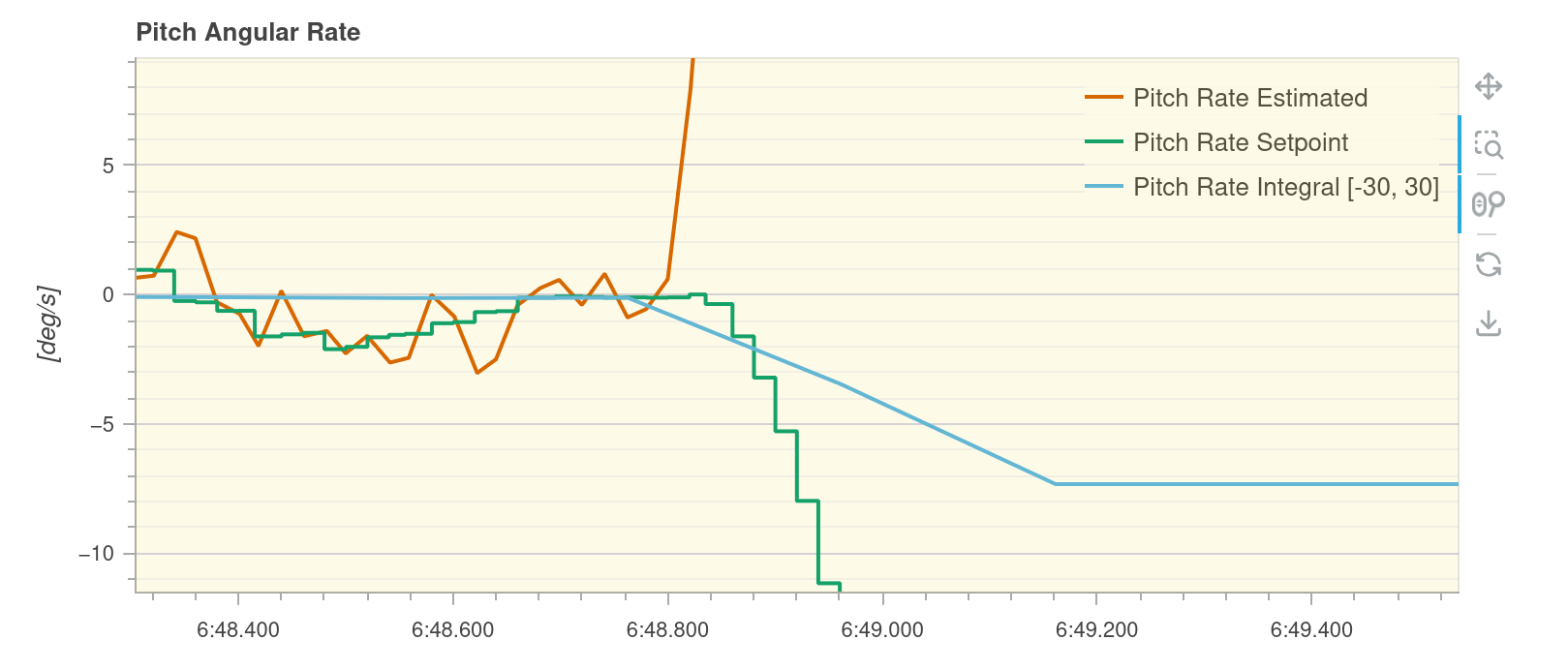

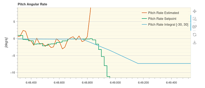

It looks like attitude starts diverging around 6:48.8:
 ![image](https://discuss.px4.io/uploads/default/original/3X/5/2/529bc4f322a46ed9b21ec87200dde02c4f218b8f.png)
 ![image](https://discuss.px4.io/uploads/default/original/3X/c/7/c7a0b3f42f8bba24c40da165a8e5fcb6934d9d8d.png)

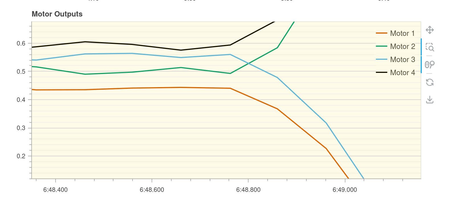

The controller correctly tries to keep it level:
 ![image](https://discuss.px4.io/uploads/default/original/3X/e/2/e2e19a89efa4d7062732911fb429ca9c1648dcaf.png)
That sort of behavior usually points towards a hardware problem, e.g. one ESC or motor loosing power or sync.
Often, a power module measuring current will indicate when a motor drops out, but that doesn’t look to be hooked up in your case.
Have you checked whether all 4 motors are still working properly, after the crash?

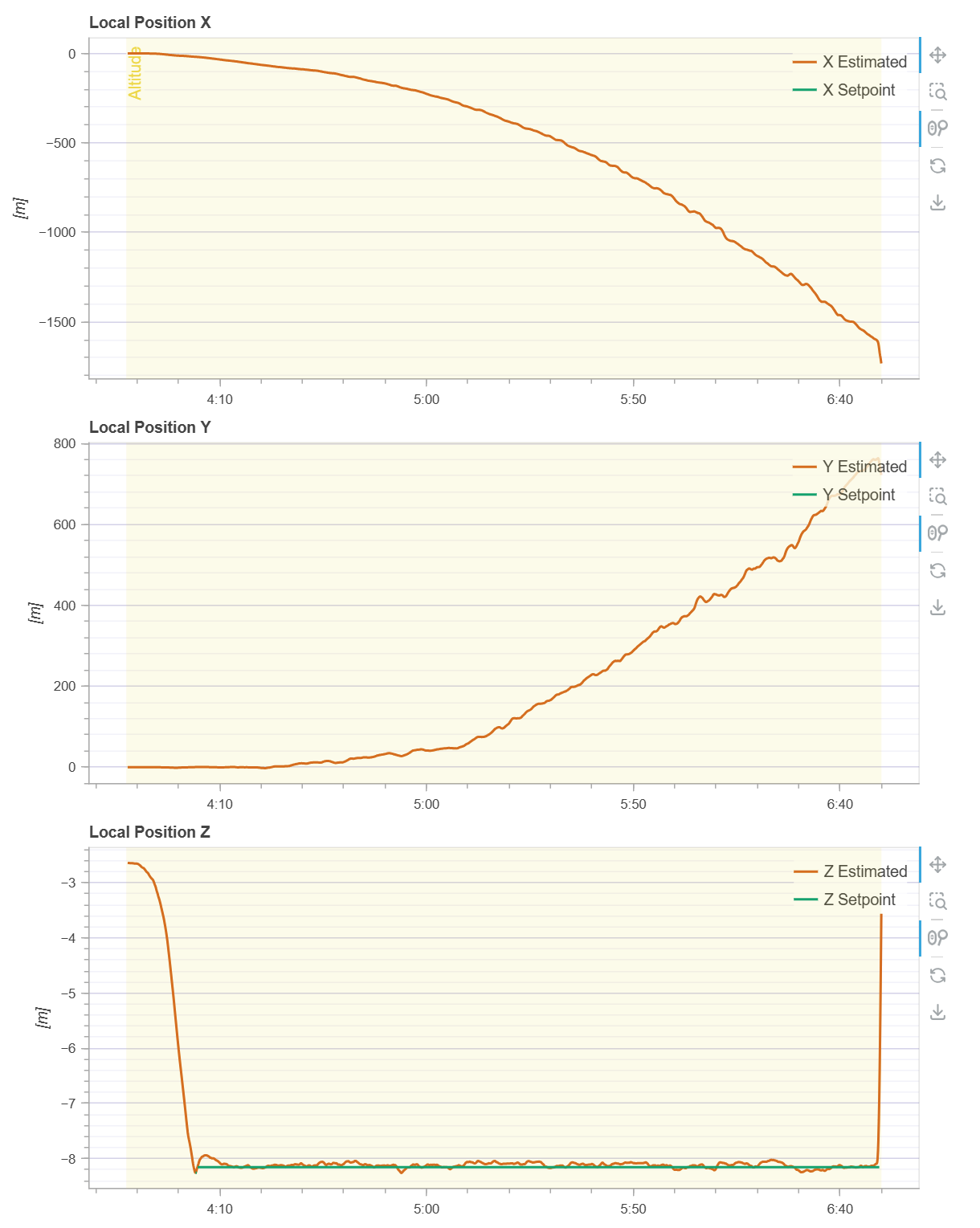

I have hung my hat on the theory of somehow corrupted IMU calibrations during that day, because of the massive drift in local position during a hover test (it thought it went moved 1000M!, see earlier Local Position graphics from above)
Here is a snippet of our most recent flight during a hover test with some minimum movements around the field. Much more accurate / realistic.
 ![image](https://discuss.px4.io/uploads/default/original/3X/1/3/132e175a439fdabec05d71580babdaf107f24b60.png)
