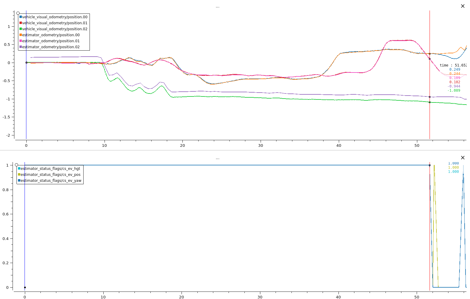

Hi all,
I’m trying to achieve GNSS-denied flight using external vision with the following setup:
- **External vision / odometry:** FAST-LIVO2
- **LiDAR:** Livox Mid-360
- **Camera:** OAK-D W
- **FCU:** MicoAir743 V2
- **PX4 firmware:** v1.16
The visual odometry output itself appears to be stable and accurate. However, **after about 1 minute of operation, EKF2 stops fusing the external vision data,** despite the continuous publishing of accurate odometry from FAST-LIVO2
The interesting part is that this happens even when the drone is completely stationary and not armed. If I move the drone around after fusion has stopped, EKF2 can sometimes start fusing the external vision again for another period of time, so I’m curious as to what makes it lose it in the first place or regains after.
Since the dropout happens at roughly the same time regardless of whether the vehicle is moving, I’m wondering whether there is some EKF2 timeout, reset condition, timestamp issue, or some condition in the EV fusion control logic that I might be missing.
Here is an example flight log [https://review.px4.io/plot\_app?log=701e1aaa-75c9-4a99-a44f-690bbb401b61](https://review.px4.io/plot_app?log=701e1aaa-75c9-4a99-a44f-690bbb401b61) and its estimator status flags and estimator vs visual odometry
 ![Screenshot from 2026-09-28 23-07-51](https://discuss.px4.io/uploads/default/original/3X/3/5/3542faca106fbd3088b3c59ee7cf7b1435a9ea38.png)
I can provide more flight logs or the full parameter list if required.
Thanks!

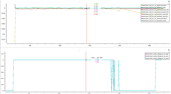

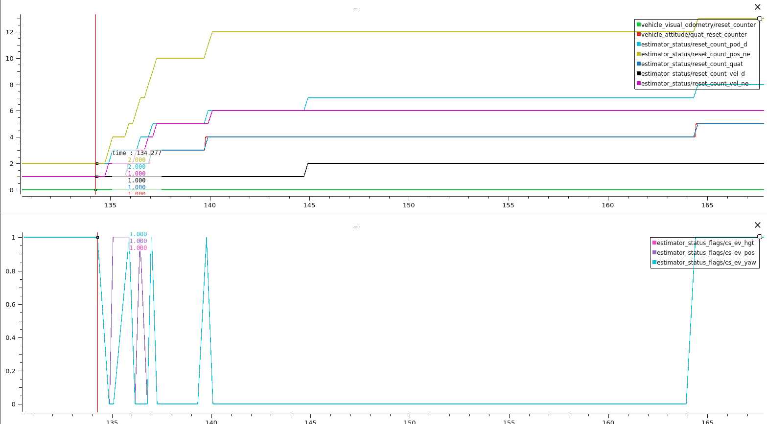

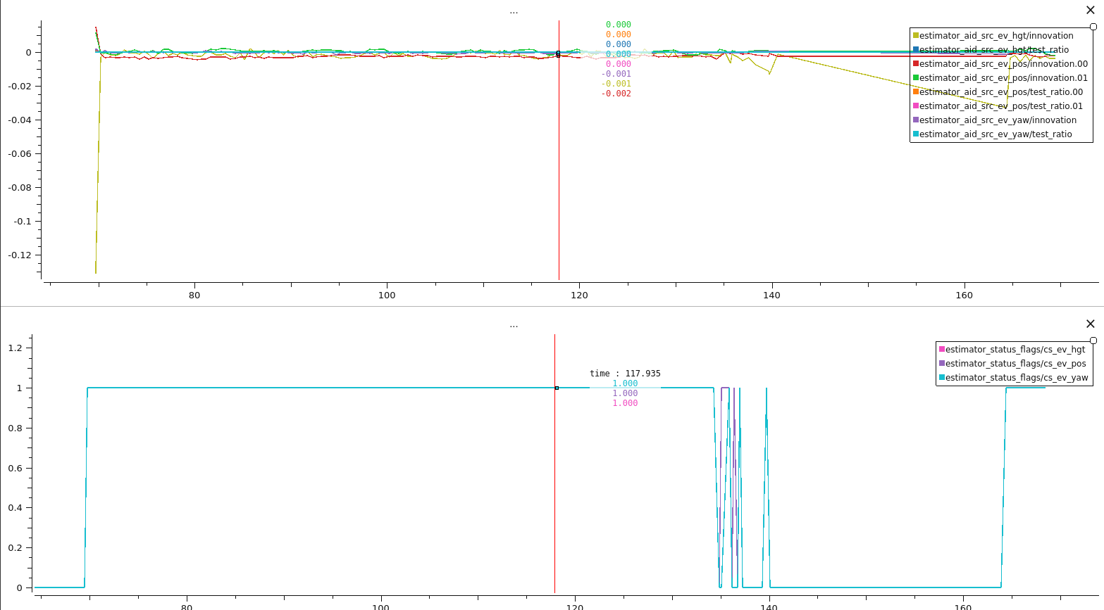

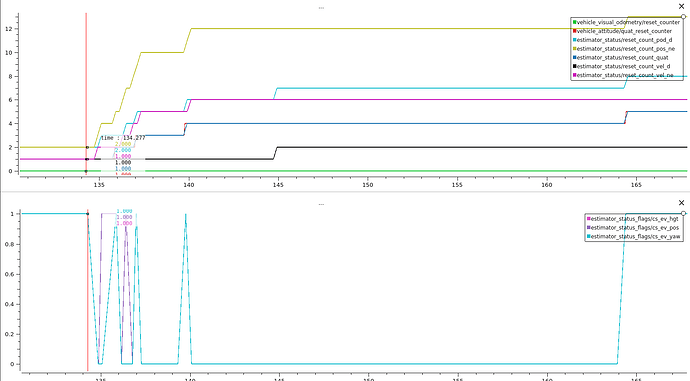

Thank you for the reply, I have logged down a stationary scenario from boot till shutdown to better look at the problem.
Here is the log file [https://review.px4.io/plot\_app?log=27d93abe-eec9-43d6-ad78-cbbd4ddeea2f](https://review.px4.io/plot_app?log=27d93abe-eec9-43d6-ad78-cbbd4ddeea2f) and parameter list (had to make it into a pdf).
[Full list parameters.pdf](https://discuss.px4.io/uploads/short-url/hjG5o4tWSG6EmKQd5rSdvVntNk0.pdf) (209.5 KB)
To answer your checklist,
- Yes the `vehicle_visual_odometry` timestamps continue to advance normally
- Both the timestamp and timestamp\_sample don’t show any obvious gaps.
- I don’t fuse the velocity only height, position and yaw, and the innovation and test ratio behaviors don’t seem to have anything out of the ordinary
- The estimator\_status\_flags can be seen in the image above as well. The interesting thing is that it regained fusion before I shut it down.
- The EV variances are hardcoded in my bridge and remain constant at 0.01, so there is no variance change associated with the fusion loss. The reset counter from the EV also remains at 0. However, I have recorded the estimator\_status reset counts.
- I would say the exact timestamp where all three flags go down is at around 134.87 s

Thanks, this log narrows it down quite a bit.
The fact that `timestamp` and `timestamp_sample` continue normally, the EV variances remain constant, and the EV `reset_counter` stays at 0 makes a simple EV stream interruption or an explicit estimator reset less likely.
The most interesting part is that position, height and yaw fusion appear to drop together at approximately 134.87 s and later recover. That suggests we should look for a common condition affecting EV fusion rather than treating the three fusion paths independently.
Could you paste the bridge code that publishes `vehicle_visual_odometry`?
In particular, I’d like to check how these fields are populated:
- `timestamp` / `timestamp_sample`
- `pose_frame` and `velocity_frame`
- position and quaternion
- position/orientation variance
- `quality`
- `reset_counter`
Also, around 134.87 s, could you check whether `vehicle_visual_odometry.quality`, the pose frame, or any validity-related field changes even for a single sample?
If you can paste the publisher/bridge section, I can trace it against the EKF2 EV fusion conditions. The simultaneous loss and later recovery should give us a fairly small search space.

**Post date:** [September 29, 2026, 12:46pm UTC](https://discuss.px4.io/t/fast-livo2-ekf2-fusion-lost-after-1-minute/49551/6 "2026-09-29T12:46:43Z")
Thanks the bridge code reveals a couple of things that I would isolate before looking for an EKF2-side bug.
One thing stands out immediately: the position is explicitly converted from ENU to NED:
```auto
Eigen::Vector3d p_ned =
    px4_ros_com::frame_transforms::enu_to_ned_local_frame(...);
but the message is then labelled:
```auto
px4_msg.pose_frame =
    px4_msgs::msg::VehicleOdometry::POSE_FRAME_FRD;
Those aren’t equivalent frames from EKF2’s perspective. `POSE_FRAME_NED` is North-aligned, while `POSE_FRAME_FRD` represents a local FRD frame with an arbitrary fixed heading offset. EKF2 also handles those two cases differently, including interaction with EV yaw alignment.
So for the first controlled test I would make the whole message consistently NED:
```auto
    px4_msgs::msg::VehicleOdometry::POSE_FRAME_NED;
    px4_ros_com::frame_transforms::enu_to_ned_local_frame(p_enu);
Eigen::Quaterniond q_px4 =
    px4_ros_com::frame_transforms::ros_to_px4_orientation(q_enu);
px4_msg.q[0] = q_px4.w();
px4_msg.q[1] = q_px4.x();
px4_msg.q[2] = q_px4.y();
px4_msg.q[3] = q_px4.z();
That also removes the manual quaternion component permutation as another variable.
The second thing I would instrument is the timestamp relationship. `timestamp_sample` is coming directly from the incoming `PoseStamped`, while `timestamp` comes from the ROS node clock. The fact that both advance continuously doesn’t necessarily prove that they’re in the same clock domain.

not as the final latency-correct implementation, but simply as an A/B test. If the ~134.87 s fusion loss disappears, that would strongly point us toward timestamp/clock-domain handling.
The fact that quality remains 100, reset\_counter remains 0, reject flags remain 0, and all three EV fusion flags disappear together and later recover makes this look more like a common EV eligibility/alignment/timing condition than three independent innovation failures.
Also, your observation that `cs_yaw_align` differs between the NED and FRD cases is useful. I would keep NED/FRD as separate experiments rather than changing only the enum while feeding otherwise NED-transformed data.
If you can run the consistent-NED + `timestamp_sample = now_us` diagnostic case and post whether the dropout still occurs, that should split the problem into two much smaller branches.
