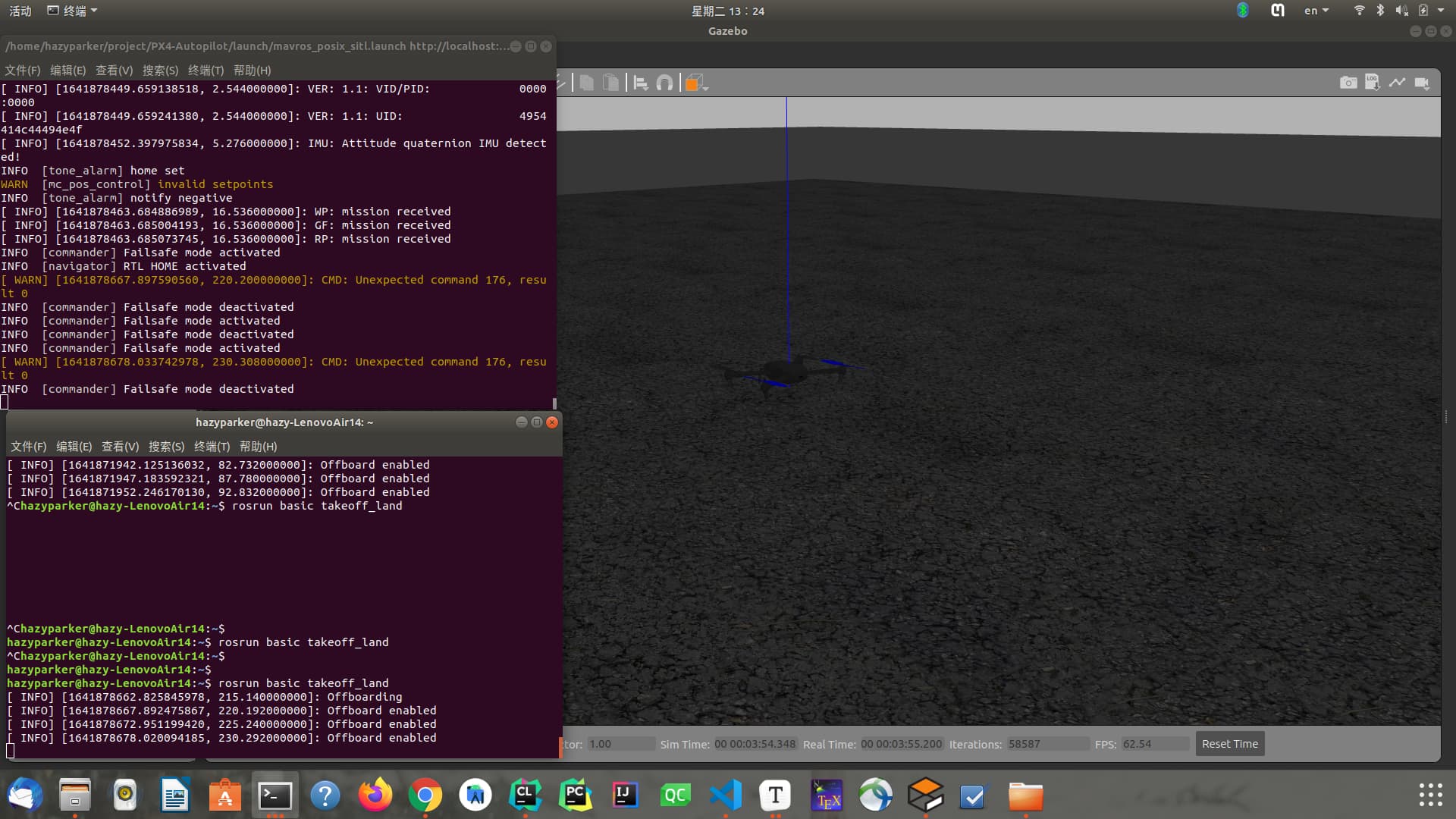

I ran command
```auto
roslaunch px4 mavros_posix_sitl.launch
then I ran a command
```auto
rosrun my_ros_package offb_node
offb\_node is the executable file of offb\_node.CPP, provided by PX4 website [mavros\_offboard](https://docs.px4.io/master/en/ros/mavros_offboard.html)
then I met an error like this image:
 ![2022-01-11 13-24-42 的屏幕截图](https://discuss.px4.io/uploads/default/original/2X/2/2055107e9655e89eb3d32d83d1aa8f59359c2069.jpeg)
- the program sink in the loop of changing the mode from offboard to armed
- failsafe mode somehow activating, and being deactivated, keeps going, never stop
- the plane can never takeoff
if were any solutions. please tell me, thank you

Thanks to my senior friend LBY’s fixing, bug was solved;
There are so many reasons to activate failsafe mode, mine is **no manual joystick**
so I launch QGC, set using joystick as clicked, then the bug is fixed;

when it came to multi uavs, this issus seemed to happen again.
Even though I clicked “use virtual joystick”, the plane could take off would only be uav0
