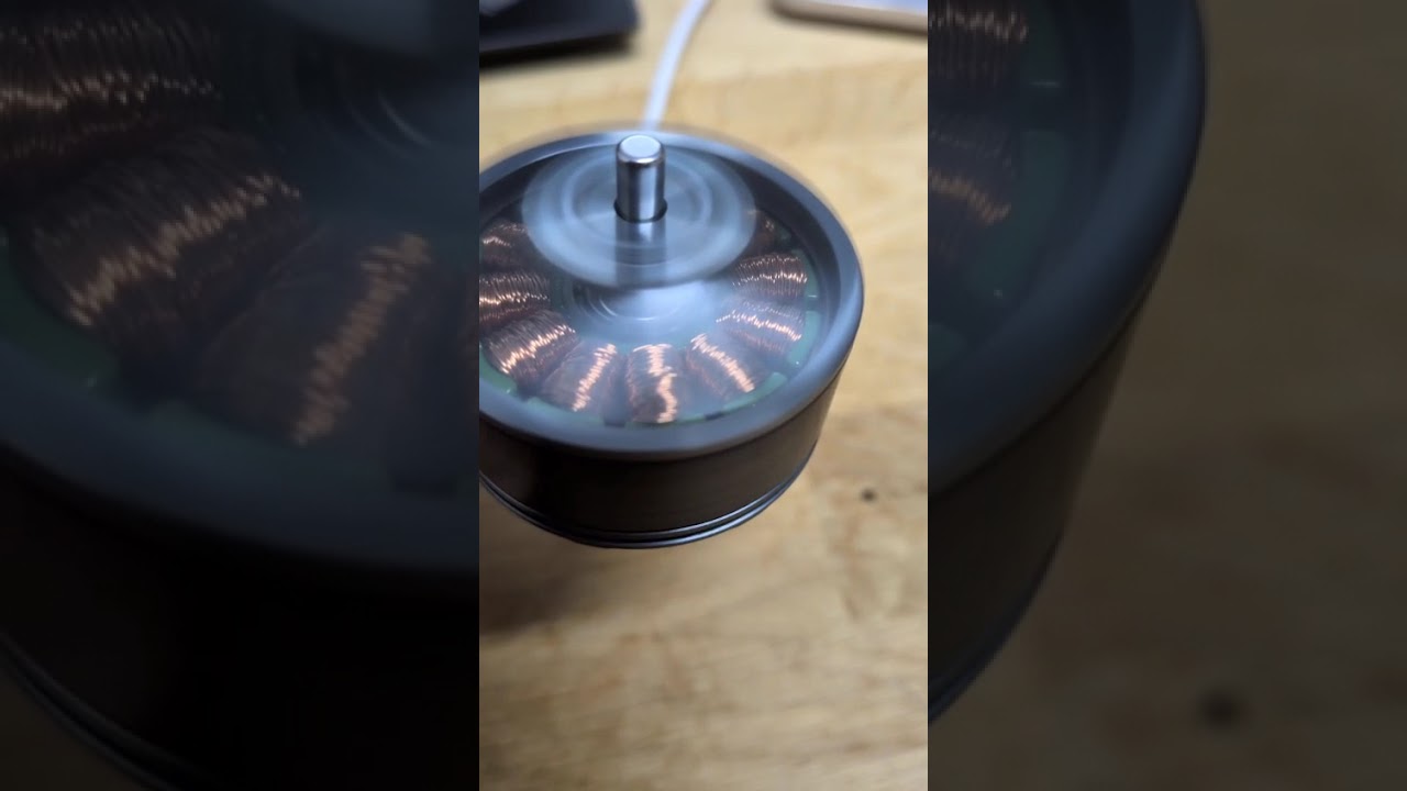

Every few seconds, the motors jiggle
I am having a Pixhawk 6xpro, with PX4 1.16 Stable, with a fixed wing VTOL, that has 4 of these as vertical lift motors: T-Motor MN3510-13 Multirotor Fixed Wing UAV Motor KV700 ( MN3510 UAV / Drone Motor - Stability & Longer Flight Time ).
As ESC, I am using **Skystars Jupiter 35A 3-6S AM32 (**Skystars Jupiter 35A 3-6S AM32 | Rotorama).
Every few seconds, somehow my motors jiggle, meaning there is a short “desync”?
I uploaded a video on youtube showcasing my problem:
I think the smoking gun in this regards is the mavlink console output:

Especially
“INFO [arch_dshot] Timer 0, Channel 2: read 0, failed nibble 8979, failed CRC 0, invalid/zero 8230”
If I understand correctly, this means that many packages do not even transfer correctly?
I tried with many different AM32 settings, different timing advance, etc, but nothing really resolved the problem.
Can someone please help do name me what this problem refers to exactly?
Does this happen with the motor test with QGC? And does it also happen when you just try to arm and test it that way. You could force arming in the MAVLink console doing commander arm -f (and commander disarm -f.
Hi Julian,
when Arming and in manual flight, I don’t notice this behavior. Yes, this video is from the actuator test with QGC.
Yes, then that’s likely a communication issue between QGC and PX4 as QGC sends commands at a (too) high rate.
Is there a way how to fix this? Or a way how to dive deeper into the code of Qgroundcontrol and monitor the signals that arrive at the Autopilot?
