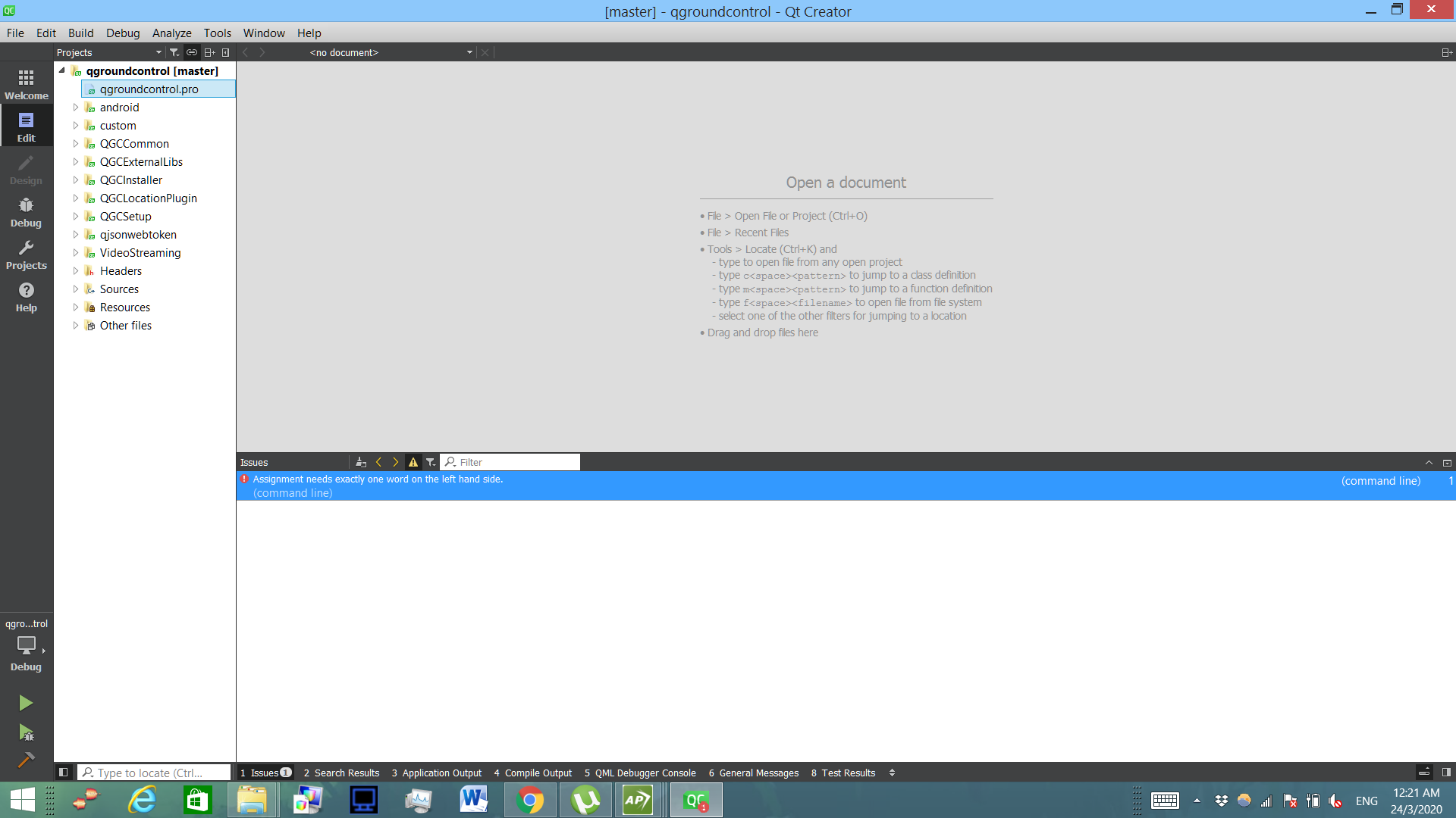

Update:
Just tried compiling again and it shows this error
 ![assignment](https://discuss.px4.io/uploads/default/original/2X/7/7d180d662e1dc7256ba35cf7ad6965134753adad.png)
**Author:** ![DonLakeFlyer](https://discuss.px4.io/user_avatar/discuss.px4.io/donlakeflyer/32/3036_2.png) [@DonLakeFlyer](https://discuss.px4.io/u/DonLakeFlyer)\
**Post date:** [March 23, 2020, 5:09pm UTC](https://discuss.px4.io/t/error-when-trying-to-build-qgc/15808/4 "2020-03-23T17:09:49Z")
Take a look at Compile Output tab instead which should provide more context as to where this is coming from

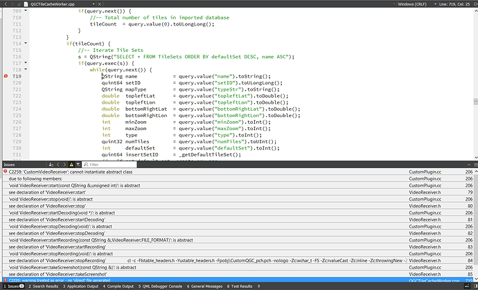

**Author:** ![NectroX](https://discuss.px4.io/user_avatar/discuss.px4.io/nectrox/32/5828_2.png) [@NectroX](https://discuss.px4.io/u/NectroX)\
**Post date:** [March 24, 2020, 2:33pm UTC](https://discuss.px4.io/t/error-when-trying-to-build-qgc/15808/7 "2020-03-24T14:33:59Z")
My apologies, the qmake error was because there was an additional argument.
After building it again, it shows:
C2220: warning treated as error - no ‘object’ file generated
and
C4819: The file contains a character that cannot be represented in the current code page (932). Save the file in Unicode format to prevent data loss
 ![Untitled](https://discuss.px4.io/uploads/default/original/2X/c/c0022a2bdb39e38c9b4f57a265eaeae76e29bb69.png)
The compile output just shows the elapsed time
 ![build settings](https://discuss.px4.io/uploads/default/original/2X/e/e35d0a8d3bc8cbffabdfd4fbba0d7e935b95ae8e.png)
**Post date:** [March 24, 2020, 5:09pm UTC](https://discuss.px4.io/t/error-when-trying-to-build-qgc/15808/8 "2020-03-24T17:09:55Z")
Ah, interesting. We don’t see that in our CI runs. So specific to OS setup. I’ll remove that.

One of it involves QGCTileCacheWorker.cpp line 719
**Post date:** [March 24, 2020, 5:30pm UTC](https://discuss.px4.io/t/error-when-trying-to-build-qgc/15808/10 "2020-03-24T17:30:45Z")
Just remove the comment which has the bad character in it

Hi, i have an idea about the reason why there is no building problem with video-build but have building issue(C2220 and C4819) on non-video-build.
If the video streaming is enabled(gstreamer installed), qmlglsink.pri will be included. And qmlglsink.pri will set QMAKE\_CXXFLAGS\_WARN\_ON to empty, which result the /WX flag(C2220) been removed, and in turn no warning treated as error.
And indeed, the real reason is what C2220 and C4819 indicated - building the QGC with some bad character in source files can not be represented in some code page(like 932). So remove the bad chars are the right way to go.
