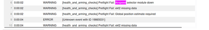

I have some experience with Ardupilot but now need to move to PX-4. I haven’t yet flown PX-4, so I’m rather new here. I am seeing what appears to me like very, very strange behavior around arming. I see, perhaps, two different points.
- “Preflight Fail: ekf2 missing data” seems to never go away
- The presentation of which flight modes may arm is incorrect
I don’t know if QGC is getting incorrect data or QGC is handling the data incorrectly. Stabilize mode presents as being “Ready”. Manual mode presents as “Not Ready”. QGC permits or prohibits attempts to arm the flight controller consistent with the presented “readiness”. Using the rudder arming gesture on the transmitter makes it possible to attempt to arm when QGC prohibits it. With Stabilize mode presenting is “Ready”, attempts to arm using either QGC or the RC transmitter are refused by PX-4. The refusal is presumably consistent with “ekf2 missing data”. Switching to Manual mode, the system presents as “Not Ready”. Yet, using the transmitter to arm results in the system arming.
I have been unable to find any leads on either the ekf2 problem nor the strange presentation of readiness to arm. I can guess that the ekf2 problem might be a parameter/configuration problem, but the message give not a hint of where to look. The presentation of readiness seems more like a bug, possibly specific to the Holybro Kakute H743-Wing flight controller I am using, but the policies involved would seem not flight controller specific.
I also have a question about the use and behavior of automated launch/takeoff. I am attempting to configure for a catapult or hand-launch. As soon as I arm the system it displays a message that it is “Ready for throw launch”, yet it is in Manual mode. I would expect to need to be in Takeoff mode (or a mission perhaps?) for it to be ready to be thrown. What is the correct usage of flight modes for hand launch and how should this message be interpreted?
@DonLakeFlyer , it is probably not correct to call you in this way, but because this post isn’t in the QGC section, I’m not sure if you’ll see it and QGC may have a roll in this set of issues. …I wasn’t sure if or how to split this post up.
Data log and screen recording linked below.

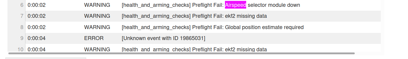

**Post date:** [September 14, 2026, 2:11am UTC](https://discuss.px4.io/t/ekf2-missing-data-and-very-strange-ready-arm-behavior/49490/5 "2026-09-14T02:11:59Z")
@j3kestrel are you using an airspeed sensor?
This is what I see from the log:
 ![image](https://discuss.px4.io/uploads/default/original/3X/2/f/2f336be034120105b9034ed786a159baff634dc6.png)
**Author:** ![j3kestrel](https://discuss.px4.io/user_avatar/discuss.px4.io/j3kestrel/32/21870_2.png) [@j3kestrel](https://discuss.px4.io/u/j3kestrel)\
**Post date:** [September 14, 2026, 3:33am UTC](https://discuss.px4.io/t/ekf2-missing-data-and-very-strange-ready-arm-behavior/49490/6 "2026-09-14T03:33:45Z")
Yes. Matek ASPD-4525 and SENS\_EN\_MS4525DO is enabled.
I had missed that mention in the logs and don’t know the implications of it. What does “selector module down” mean?
