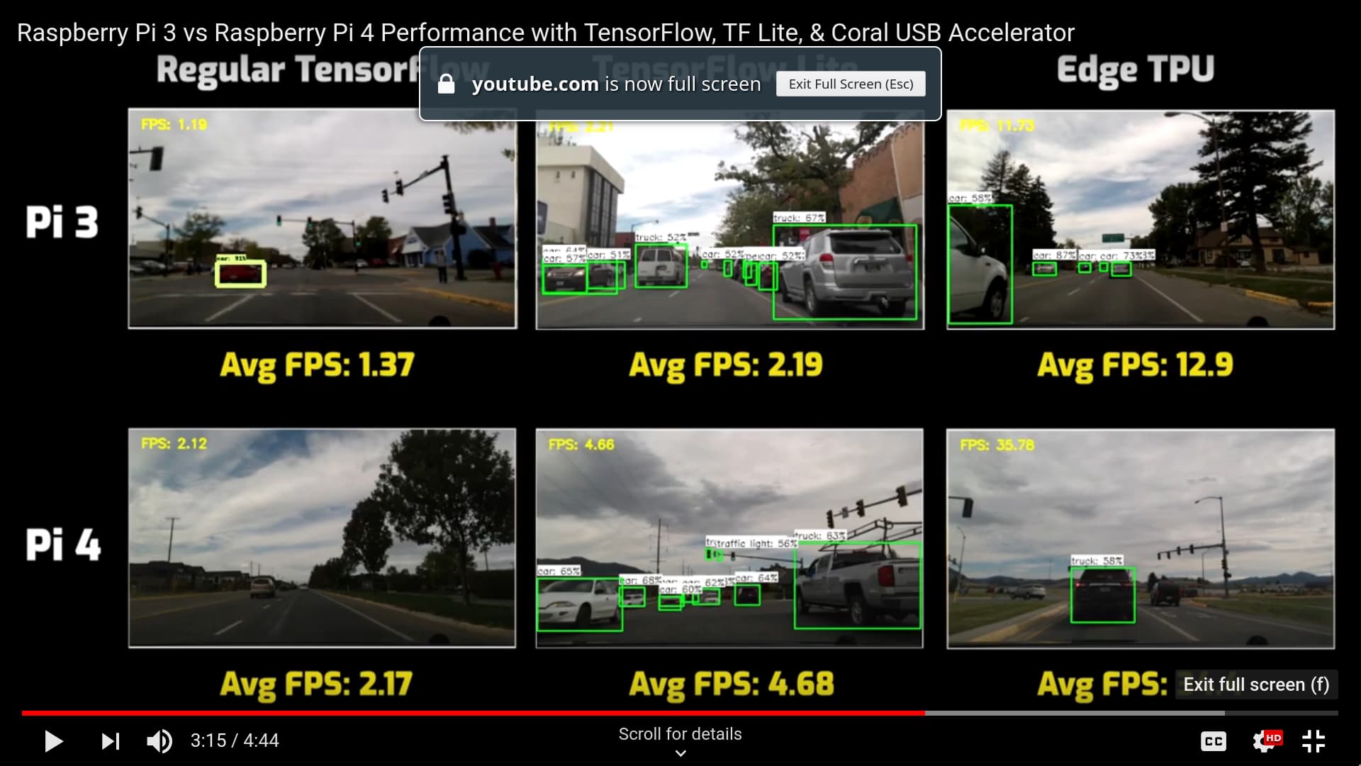

I was thinking about using a raspberry pi or another companion computer to run a computer vision program to detect smoke from fires through a camera. I was also thinking about using a CO2 sensor as an additional layer of confirmation for fire detection. Regarding area to be covered, this is more of a test bench. After I can prove the concept works on a quadcopter drone I was planning to move on to a fixed-wing UAV. Does that narrow it down a bit?
**Author:** ![Karl\_S](https://discuss.px4.io/user_avatar/discuss.px4.io/karl_s/32/14567_2.png) [@Karl\_S](https://discuss.px4.io/u/Karl_S)\
**Post date:** [July 11, 2025, 11:46pm UTC](https://discuss.px4.io/t/drone-computer-vision-project-need-help/46350/4 "2025-07-11T23:46:13Z")
I can save you some time and hassle:
a few years ago I’ve done some object detection using a Raspberri-Pi 3B+.
Due to limited CPU power it manages to process less than 2 picture frames per second. This is not enough to get reliable, quality results whilst flying. - Might be alright for a stationary device.
As part of my research back then, I’ve found this handy little comparison:
(Thanks to the autor, as is not mine).
 ![Speed comparison](https://discuss.px4.io/uploads/default/original/3X/3/0/30f9360261acf528ee17179da76eaec123c41327.jpeg)

Thanks a lot, I will look also into more powerful platforms like an NVIDIA Jetson board. I will probably proceed with the X500 frame since it has the necessary payload and flight-time for me right now. Regarding a camera to use for the computer vision aspect, do you have any thoughts on that? My plan was to utilize a camera gimbal that could freely rotate, but I’m not familiar with any commercial products.

Re. Computer: I’ve ended up with a mini PC. As I could use the more powerful CPU and also install a suitable version of Linux. There are many projects out there based on Linux and less issue with proprietary limitations.
