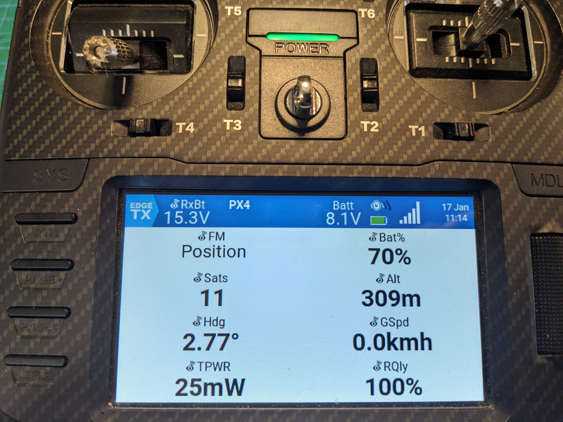

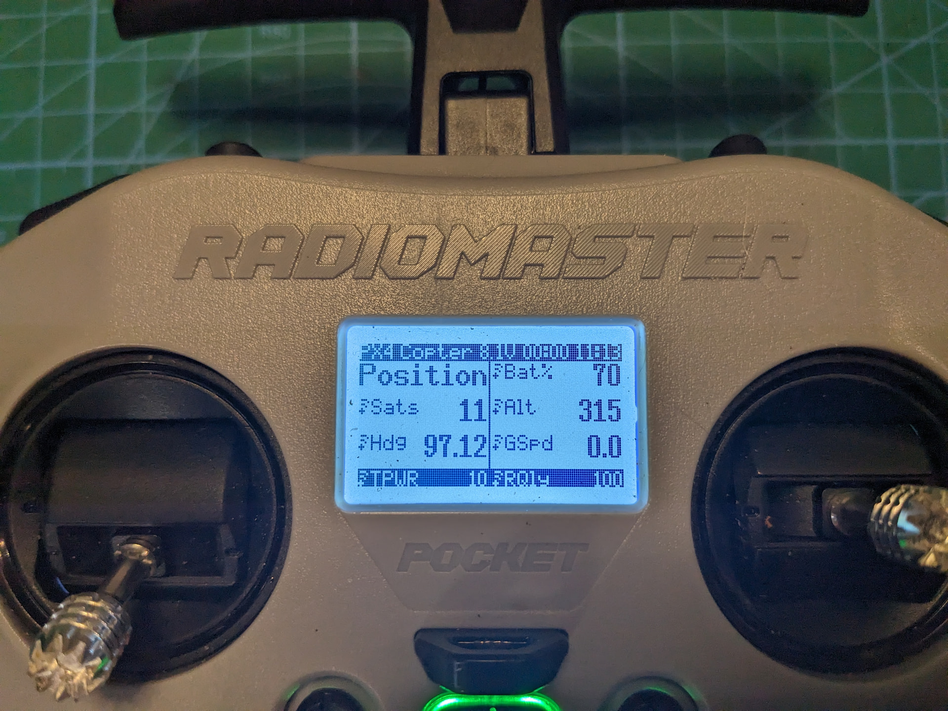

I later realized that with the firmware driver for ELRS telemetry in the target, I could simply use EdgeTX widgets to display this information. Here are examples on a RadioMaster Pocket, and a RadioMaster TX16S.
