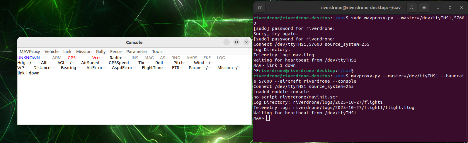

 ![WhatsApp Image 2025-10-27 at 21.06.57_c7f44471](https://discuss.px4.io/uploads/default/original/3X/0/4/0451d9d6440dc2bc76741c7b366a6133ba97e63b.jpeg)
I am struggling with same.
I have installed MAVProxy but I have not been able to figure it out.

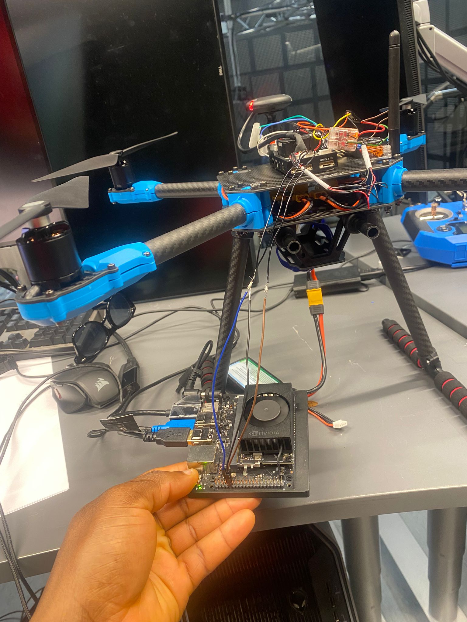

My connection JSTGH pin2 TX, pin3 RX and pin6 GND to jetson orin nano 40-pin header 10, 8 and 9 respectively
 ![WhatsApp Image 2025-10-27 at 21.08.06_cda9de29](https://discuss.px4.io/uploads/default/original/3X/f/0/f0bba63f39378e33b9aa4fea7f756daa65411284.jpeg)
