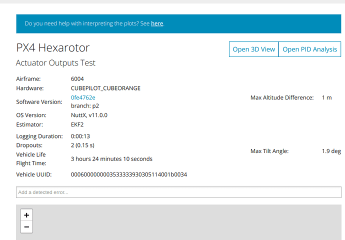

Dear all,
I’m currently trying to build a VTOL and I want to test the elevator and ailerons. My problem is that it seems that the aircraft doesn’t switch from multicopter to fixed wing mode. I assigned channel 7 on the RC for the transition switch parameter but nothing really happens when using the lever on the RC. Is there something I need to keep in mind? Currently, there is no airspeed sensor integrated. Could that be the issue?
Thanks for your help!

**Post date:** [March 10, 2023, 10:38am UTC](https://discuss.px4.io/t/changing-from-multicopter-to-fixed-wing-flight-mode/31183/3 "2023-03-10T10:38:46Z")
[https://review.px4.io/plot\_app?log=ad7b1d63-6c45-4397-8ad7-012f920ca999](https://review.px4.io/plot_app?log=ad7b1d63-6c45-4397-8ad7-012f920ca999)
In the log messages, you can see nowhere that the flight mode is changed. And this wonders me as I used the switch and in QGroundControl it is visible that the switch works.
**Author:** ![junwoo0914](https://discuss.px4.io/user_avatar/discuss.px4.io/junwoo0914/32/12312_2.png) [@junwoo0914](https://discuss.px4.io/u/junwoo0914)\
**Post date:** [March 10, 2023, 3:16pm UTC](https://discuss.px4.io/t/changing-from-multicopter-to-fixed-wing-flight-mode/31183/4 "2023-03-10T15:16:20Z")
From the log it is apparent that your vehicle isn’t a VTOL (not configured to be):
 ![image](https://discuss.px4.io/uploads/default/original/2X/3/373c16c802005637916e77e1dc4121078b034f48.png)
Also, it sees that your airframe is a ‘Hexarotor’ (Title of the log review):
 ![image](https://discuss.px4.io/uploads/default/original/2X/d/dc3a2b7ecd613859088dabc6893dc533b017b23b.png)
Is it actually a VTOL? Did you configure it as a VTOL in Airframe selection? (Refer to: [Frame Setup | PX4 User Guide](https://docs.px4.io/main/en/config/airframe.html))
Could you share the picture of the vehicle? Just to check whether it is actually a Hybrid VTOL or not as well 😉
