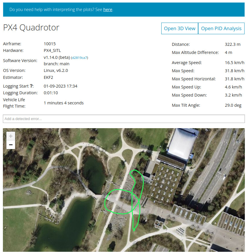

I’ve tried legacy gazebo installation, gazeob-classic, and the updated gazebo simulation instructions, but for all of them (on both Ubuntu 20.04 and 22.04) the following happens when I try to extract data from a log file:
1. I start the simulation with whatever instructions are listed on the following pages:
[Gazebo Simulation Main Page](https://dev.px4.io/v1.11_noredirect/en/simulation/gazebo.html#taking-it-to-the-sky)/ [Gazebo Simulation (most recent?) Main Page](https://docs.px4.io/main/en/sim_gazebo_gz/) / [Gazebo Classic Main Page](https://docs.px4.io/main/en/sim_gazebo_classic/)
2. I open qgroundcontrol to make sure that my controller is working, and to make sure I’ve got the parameters set to record the log files. I just recently changed SYS\_HITL to SIH enabled to see if that would make a difference, but this didn’t work.
 ![image](https://discuss.px4.io/uploads/default/original/2X/3/3485d08258b8604dfe2daefe625b3f491e5b421a.png)
3. Perform a simple flight
4. Download the log file from the “Analyze Tools” tab of qgc. I’ve also tried copying the log file from /PX4-Autopilot/build/px4\_sitl\_default/rootfs/log, but the same things happen
5. Open MATLAB, and use the ulogreader function to read the extracted ulog file. I know this works, as I have previous log files which I can read, but the for the most recent gazebo logs, I get the following output:
 ![image](https://discuss.px4.io/uploads/default/original/2X/b/b0938f24562c31f5c7ff69ea9ecd3d974012b585.png)
When trying to import the data directly, I get the following:
 ![image](https://discuss.px4.io/uploads/default/original/2X/a/a2539508bac158d6b6c559de7f152ec6dcfba848.png)
But when using the ulog flight review tool, it seems to work:
 ![image](https://discuss.px4.io/uploads/default/original/2X/a/a0c261d68627886ad02c54b9bffbb702da3fc380.jpeg)
Alternatively, with a log file that I know the matlab function works with, from an older version of px4 and gazebo (~Summer 2022, not sure exact version numbers):
 ![image](https://discuss.px4.io/uploads/default/original/2X/2/26999b2d26ba95ed15a197cacd815393bca9f256.png)
Can someone point me in the right direction regarding what I need to change to get the log files to properly output their data in matlab?
Thank you in advance.

UPDATE: It seems like this is just a Matlab issue. The default ulogreader function hasn’t been updated to account for whatever changes happened to ulog files between when I last successfully used it in 2022 and now. Moving on to using [pyulog](https://github.com/PX4/pyulog) to read/convert ulogs to csv files for future work. Thanks!
