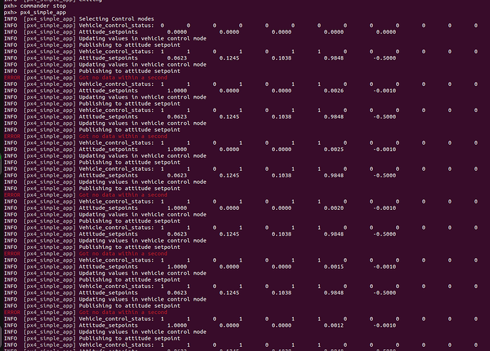

@A7sus4 Why would you stop commander to run your code? Then this means that you need to handle what commander was doing in your code, which I believe the code is not doing and therefore not working
**Author:** ![A7sus4](https://discuss.px4.io/user_avatar/discuss.px4.io/a7sus4/32/11958_2.png) [@A7sus4](https://discuss.px4.io/u/A7sus4)\
**Post date:** [December 15, 2022, 8:07am UTC](https://discuss.px4.io/t/cannot-control-quad-in-jmavsim-using-actuator-controls-reference-writing-your-first-application-px4-user-guide/30059/5 "2022-12-15T08:07:53Z")
I tried running the code with commander start too.
here’s the output with commander stop
 ![Screenshot from 2022-12-15 10-59-24](https://discuss.px4.io/uploads/default/original/2X/3/36dacfe7547536d1d53e3668899c315817340aac.png)
here’s the output with commander start
 ![Screenshot from 2022-12-15 11-05-31](https://discuss.px4.io/uploads/default/original/2X/c/c72c98df63335cb16f72f1c2891b86767ac262cc.png)
Commander start is updating the vehicle\_control\_status values after every iteration.
**Author:** ![Jaeyoung-Lim](https://discuss.px4.io/user_avatar/discuss.px4.io/jaeyoung-lim/32/10829_2.png) [@Jaeyoung-Lim](https://discuss.px4.io/u/Jaeyoung-Lim)\
**Post date:** [December 15, 2022, 9:09am UTC](https://discuss.px4.io/t/cannot-control-quad-in-jmavsim-using-actuator-controls-reference-writing-your-first-application-px4-user-guide/30059/6 "2022-12-15T09:09:37Z")
@A7sus4 I was not implying that you should run your code together with commander.
What I meant is that there are a lot of states that are being set for safety in commander, and that you need to handle these if you want to replace commander.
If you are just interested in implementing a controller, you can look at what information the mc\_rate\_controller is using, and just replace the `mc_rate_controller` with your implementation
