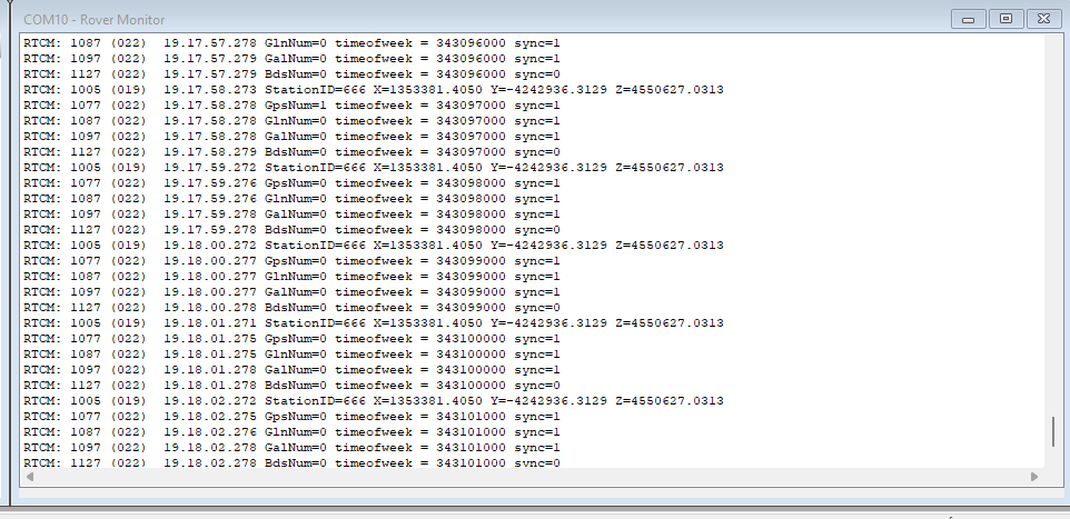

I followed both PX4’s and DATAGNSS’s documentation, but I’m unable to get the RTK base module to connect to QGroundControl. In the Satrack app, I can see RTCM corrections coming in at 1Hz, and according to PX4’s documentation, it should be plug-and-play from this point.
On the rover side, GPS works fine on the drone, just without the corrections.

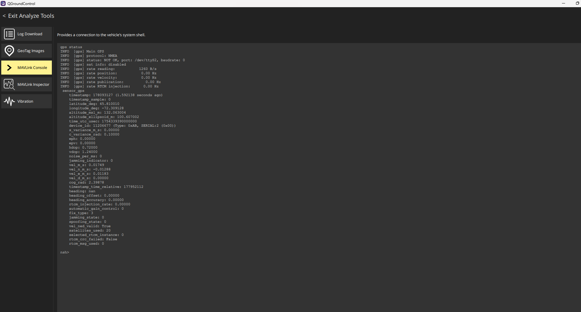

Are you talking about the rover gps or the base gps?
For the rover, it is connected in the gps port of the FC and it is working.
The Base gps is connected to my windows computer running QGC.
Here is the result of **gps status**
 ![Screenshot_gps_status](https://discuss.px4.io/uploads/default/original/3X/2/3/23fded1fd60a66612b100f65e43530ef190e568a.png)

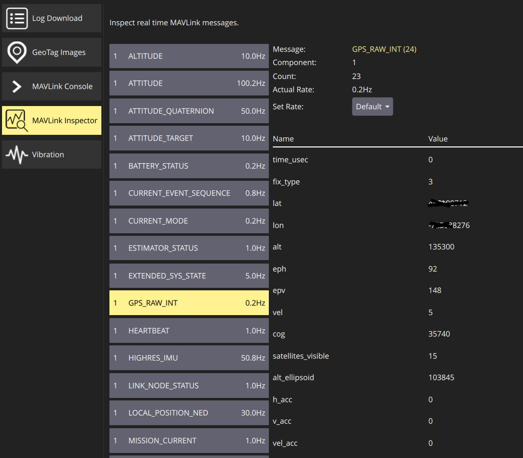

Hi there, same problem here, but with problems with the NMEA receiver module.

1. GPS\_RAW\_INT
 ![Screenshot from 2025-08-06 21-21-41](https://discuss.px4.io/uploads/default/original/3X/7/3/73d574309fec7fa5c18ede0dd465e9c127ce4292.png)

After a quick inspection, I noticed the same issue as @Napoleon
I had always assumed the rover GPS was working fine since I was getting a GPS fix, the number of satellites, and the red arrow appearing in QGC. However, in `gps status` I see “NOT OK” and a rate of 0 Hz.
I’ve seen many forum posts regarding issues with PX4 and NMEA GPS units. Before buying the DATAGNSS unit, I made sure to choose something listed as officially supported by PX4 to avoid problems. Has anyone actually tested these units before adding them to the officially supported devices list? I can’t seem to find any example of someone successfully using these with PX4.

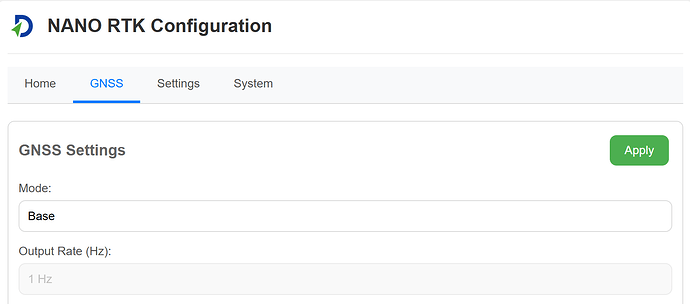

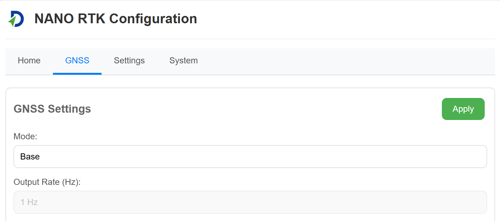

**Post date:** [August 11, 2025, 5:02am UTC](https://discuss.px4.io/t/base-rtk-module-not-recognized/46725/9 "2025-08-11T05:02:17Z")
Hi Gabriel,
Our team has already sent you an email. According to your description, the rover mode (NANO HRTK) is currently functioning properly, but there is an issue with setting up the base (NANO RTK Receiver).
Your setup on Satrack is correct.
However, since the NANO RTK Receiver is based on ESP32, it will automatically configure itself according to the mode in the web settings during system startup. Therefore, even after your settings, the correct RTCM data output may still not be available. We recommend that you log in to the settings page of the NANO RTK Receiver and change the GNSS mode to base mode or unconfigured mode.
