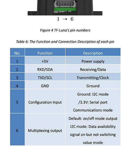

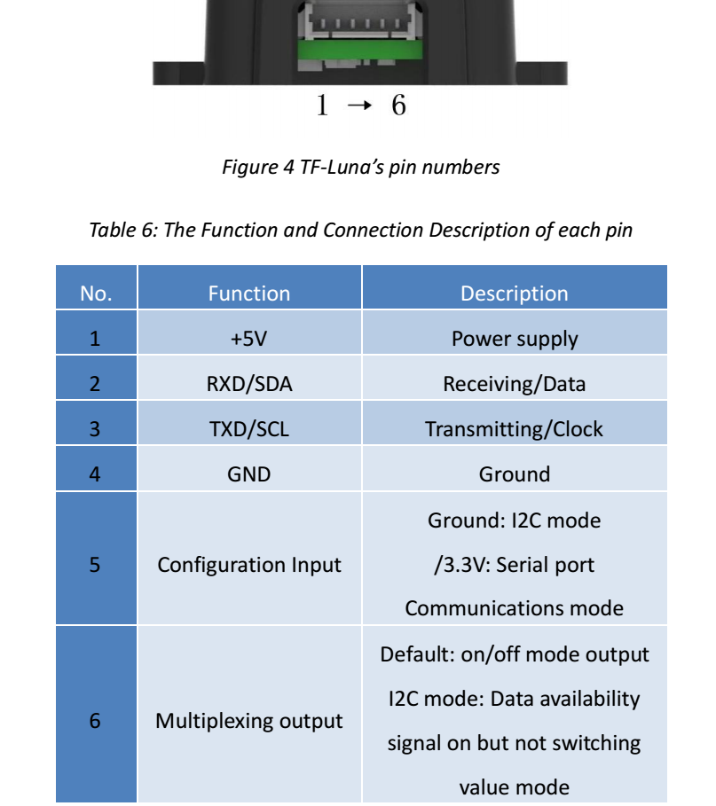

The default communication of TF-Luna is UART. LiDAR comes with a single cable. In order to use IIC the cable needs a little modification, details are mentioned in the coming paragraph. Please see TF-Luna IIC communication pin details as below:

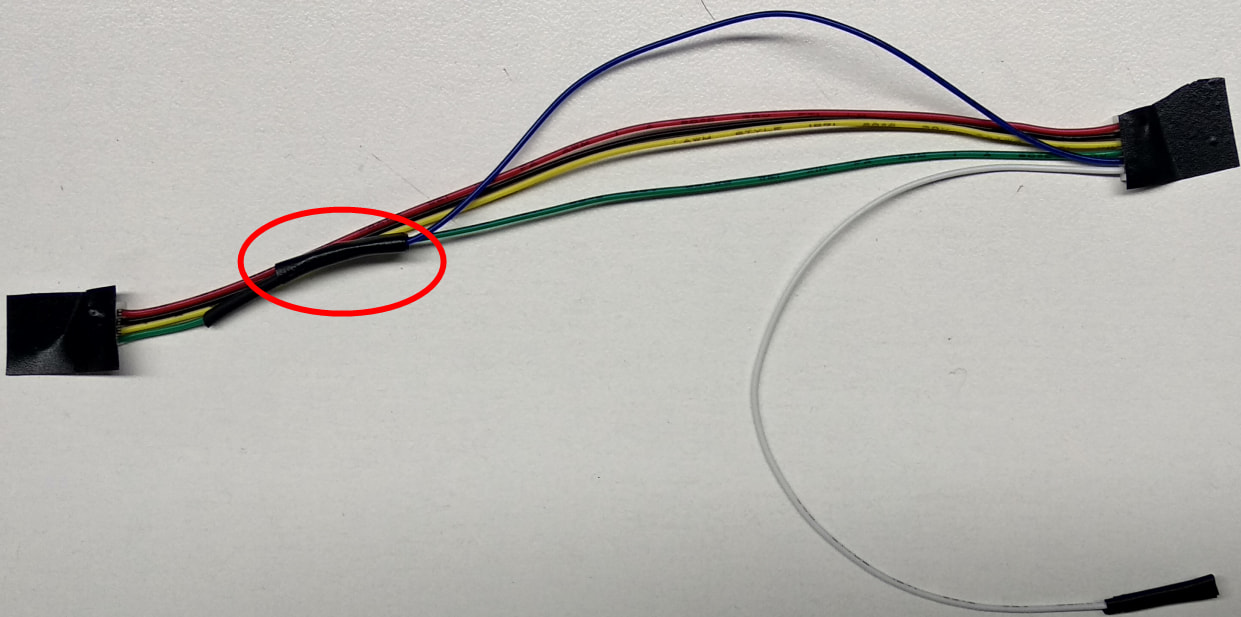

If we look at the pin configuration of TF-Luna, IIC can be set by grounding pin-5 in addition to the other four pins. For this purpose a customized cable is needed because in IIC mode we need to connect both pin-4 and pin-5 to the ground.
The modified cable is shown below. I have connected green wire (pin-4) and blue wire (pin-5) to single pin which will go to the GND pin of the source. Leave pin-6 connected. Please ignore the color standard in this case as black wire represents RXD/SDA while yellow wires represents TXD/SCL, just follow the pin numbering according to the user-manual.

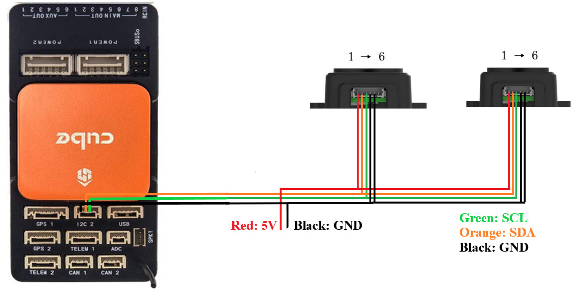

1. PixHawk Cube Connection:
We take PixHawk Cube Orange flight controller as an example:
Figure 1: Schematic Diagram of Connecting TF-Luna to I2C Interface of PixHawk Cube
Note:
1. Default cable sequence of TF-Luna and PixHawk Cube are different, please change it accordingly (SDA and SCL wires need to be interchanged). Look at the pinout of controller, pin configurations are:
Pin Name Dir Wire Color Description
1 VCC_5V out red/gray Supply to peripheral from AP
2 SCL in/out blue/black SCL, 5V level, pull-up on AP
3 SDA in/out green/black SDA, 5V level, pull-up on AP
4 GND - black GND connection
2. IIC connector should be purchased by user.
3. If TF-Luna faces down, please take care the distance between lens and ground, it should be larger than TF-Luna’s blind zone (20cm).
4. If more TF-Lunas need to be connected (10 LiDARs are supported), the method is same.
5. Power source should meet the product manual demands:5V±0.5V, larger than 150mA (peak current)*number of TF-Luna.

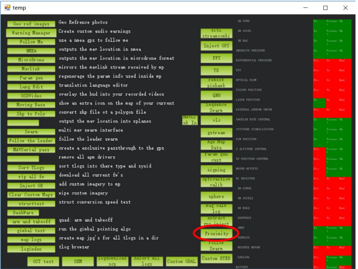

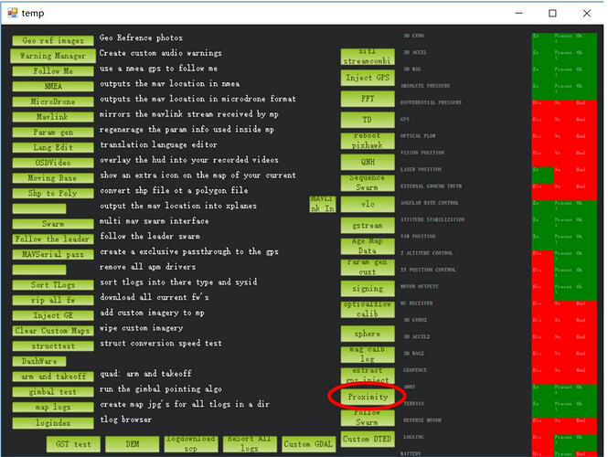

Upon setting of these parameters, click [Write Params] on the right of the software to finish the process. After writing the parameters you need to power off the controller and then turn it on to apply the setting changes. If the error message “Bad LiDAR Health” or “Bad Proximity” appears, please check if the connection is correct and power supply is normal. How to see the target distance from the LiDAR: press Ctrl+F button in keyboard, the following window will pop out:

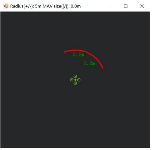

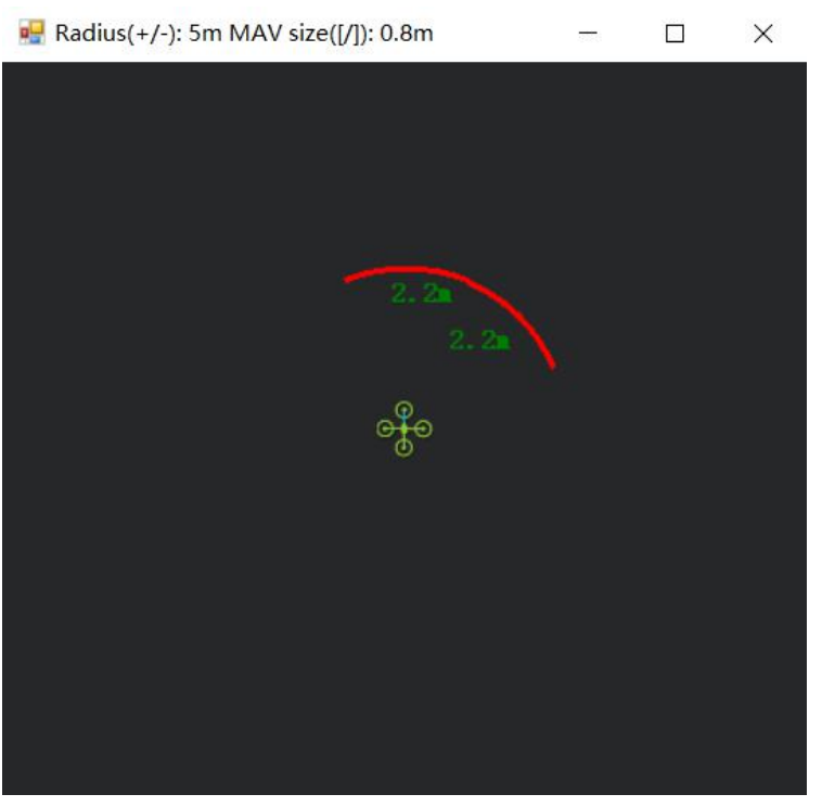

Click button Proximity, the following window will appear:
The number in green color means the distance from LiDAR in obstacle avoidance mode(the number only refresh when this window opens, closes, zooms in or zooms out, it doesn’t mean the real time distance from LiDAR and will not be influenced in Mission Planner. The mission planner version at the time of writing this tutorial was v1.3.76.
