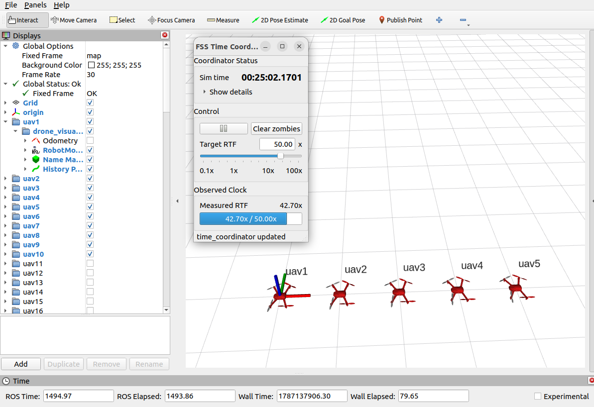

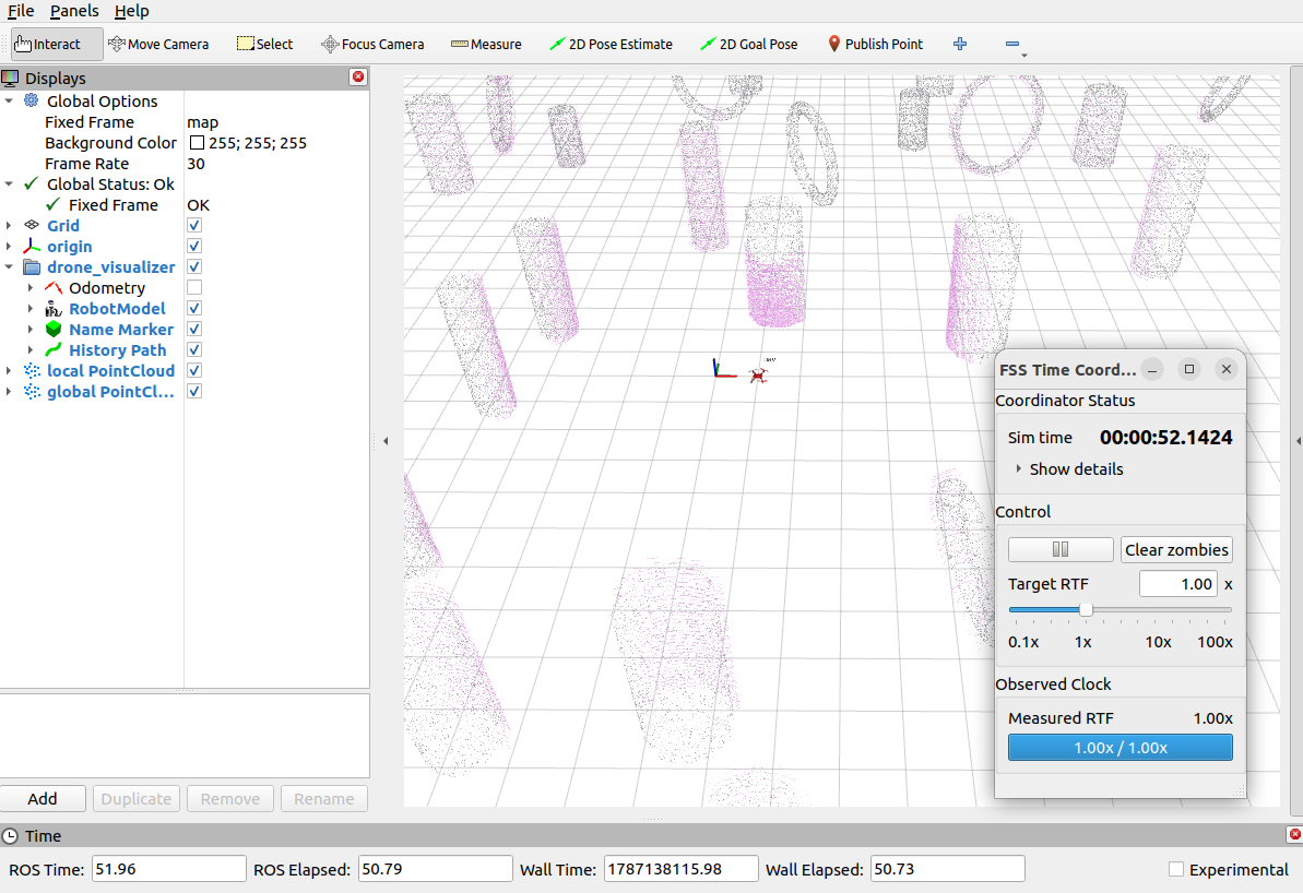

FastSwarmSim is intended for PX4 and ROS 2 multi-vehicle algorithm development, repeatable simulation-time experiments, and accelerated testing. It combines a trimmed PX4 runtime, MAVROS-compatible ROS interfaces, RViz visualization, local LiDAR point-cloud rendering, and a lock-step simulation clock.
The simulator achieves operation up to approximately 100x real time for a single vehicle and 50x for five vehicles with LiDAR simulation disabled on a desktop-class computer, with lower but still accelerated rates as the vehicle count increases. Actual performance depends on the host system and workload.
Lock-step simulation with ROS 2 /clock
A central feature is the lock-step time model. FastSwarmSim publishes simulation time through ROS 2 /clock and advances the simulation in lock-step, so simulation progress is explicit, reproducible, and coordinated across PX4, ROS 2 nodes, sensors, and controllers.
A ROS node can participate after a relatively small adaptation: use ROS time, respond to /clock, and advance its computation or publish outputs according to the simulation-time cycle. This makes it possible to bring existing ROS nodes into lock-step experiments without redesigning the whole node. Nodes that are not adapted can still run normally, but they will not have the same deterministic lock-step semantics.
