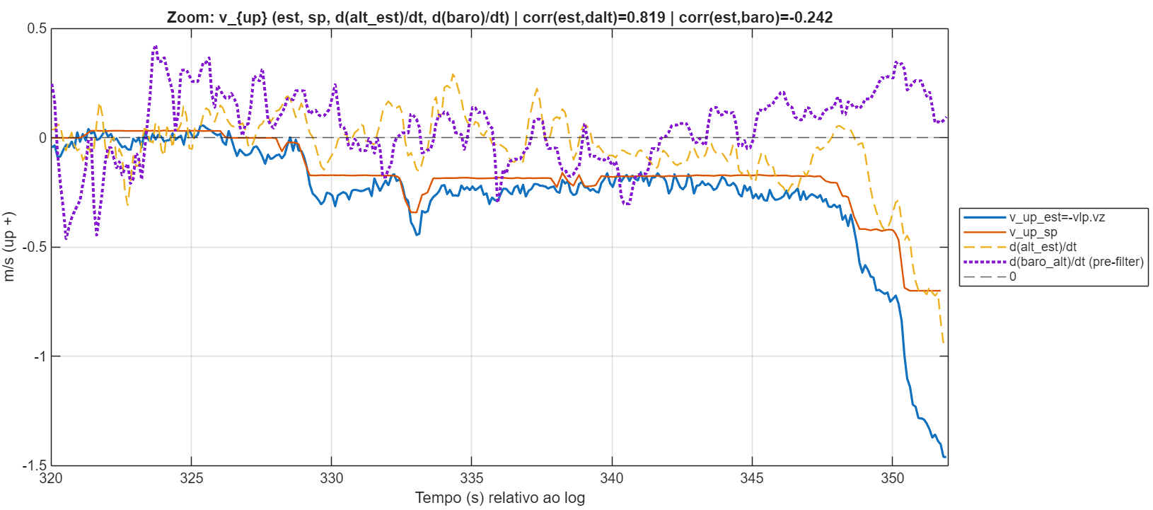

Hi all,
I’m trying to understand something that happened in Altitude mode and would really appreciate some estimator-level insight.
Firmware: PX4 v1.16.1
**What happened**
- Drone was hovering normally.
- Mid-flight it started climbing unexpectedly.
- I reduced throttle (including strong downward input).
- The drone kept climbing.
- In the log, EKF vertical velocity (`-vlp.vz`) shows descent during that period.
- The controller reacted consistently with that estimate (increased thrust to “stop” the perceived descent).
So at that moment:
- The drone was physically climbing (visually confirmed).
- The barometer altitude trend (from `vehicle_air_data.baro_alt_meter`) shows climb.
- EKF vertical velocity estimate shows descent.
What I’ve already ruled out:
- No EKF instance switch.
- No attitude resets.
- Baro test\_ratio stayed low.
- `cs_baro_hgt = 1` (barometer was the active height source).
- EKF appears to be internally consistent (`v_up_est` matches `d(alt_est)/dt`) (see image below).
- Motors follow thrust setpoint normally.
So this doesn’t look like a classic reset or measurement rejection.
In the figure below, the X-axis represents log time in seconds (so 320 s ≈ 5:20 in the flight). The derivatives of the estimated altitude and the barometer altitude (used here as vertical velocity proxies) begin to diverge in that interval. After ~350 s (≈5:50), the data is no longer reliable, as the vehicle was already in an abnormal state and I attempted a non-standard external intervention to prevent further damage, which contaminates the measurements beyond that point.
 ![image](https://discuss.px4.io/uploads/default/original/3X/d/6/d65f20b9a36bc8e9ef7f0d4399307879c4614315.png)
**Other observations**
- From some point onward, the drone flies with a persistent ~5° pitch offset.
Not sure if it’s related, but worth mentioning.
- Vibration levels are higher than recommended.
- GPS was physically connected but not used for estimation (`SYS_HAS_GPS = 0`, and related parameters disabled). Height source was barometer only.
- Additionally, the Local Position X/Y values in Flight Review seem to be several orders of magnitude larger than expected, considering the vehicle never left a ~5 m radius from the takeoff point. I’m not sure whether this is a logging reference issue or something estimator-related
**Main question**
Is there a realistic EKF2 mechanism where high vibration (or something similar) could bias vertical acceleration/velocity enough to produce a sustained vertical velocity error without triggering innovation failures or high test\_ratio?
In other words, can the estimator drift in vertical velocity while still looking statistically “healthy”?
**Flight Review link:**
[Flight Review - Hexarotor](https://review.px4.io/plot_app?log=d4bd5d68-75ea-4aec-acfc-7abc0aebce2a)
If needed, I can upload the full `.ulg` file and/or `.params` for more details.
I’m trying to understand whether this smells like configuration, vibration-induced bias, or something deeper.

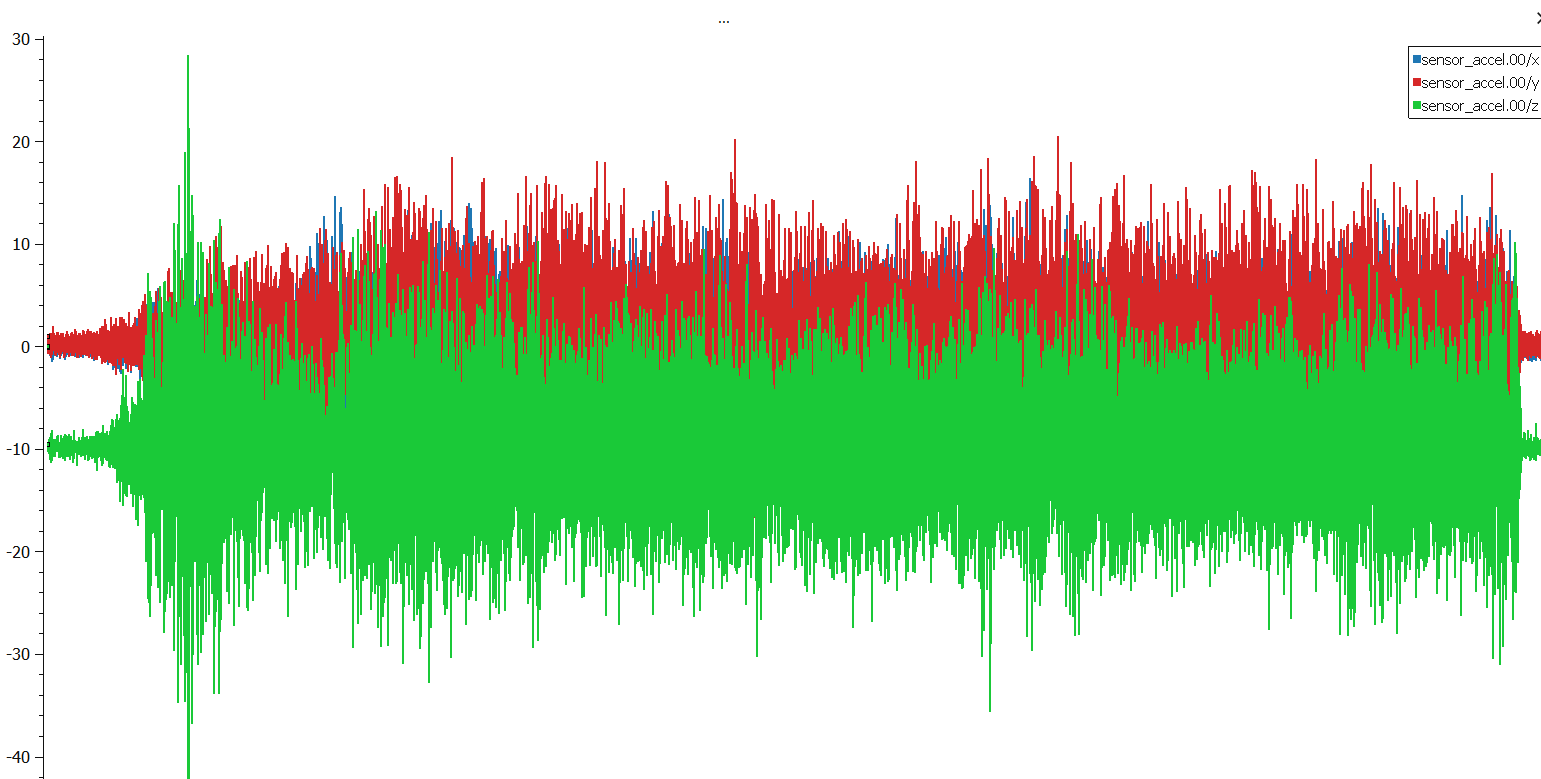

**Author:** ![eriog](https://discuss.px4.io/letter_avatar_proxy/v4/letter/e/a183cd/32.png) [@eriog](https://discuss.px4.io/u/eriog)\
**Post date:** [March 2, 2026, 8:51am UTC](https://discuss.px4.io/t/altitude-mode-ekf-thought-it-was-descending-while-the-drone-was-clearly-climbing/48546/4 "2026-03-02T08:51:10Z")
Hi !
The EKF2 estimate recover itself after some times yes, and the drone did not crash.
I also did some experiment and found that my issue is probably due to velocity estimate. I re-activated EV velocity fusion with patched velocity estimate from the SLAM algorithm and it worked waaaay better.
Also, how do you check vibration level ? Without ev velocity fusion I beleive the EKF uses accelerometer to estimate velocity and had issue doing so
edit:
 ![image](https://discuss.px4.io/uploads/default/original/3X/8/7/87c8430af8d4b4c320828bb27b671c0df429d207.png)
I may have a vibration issue…

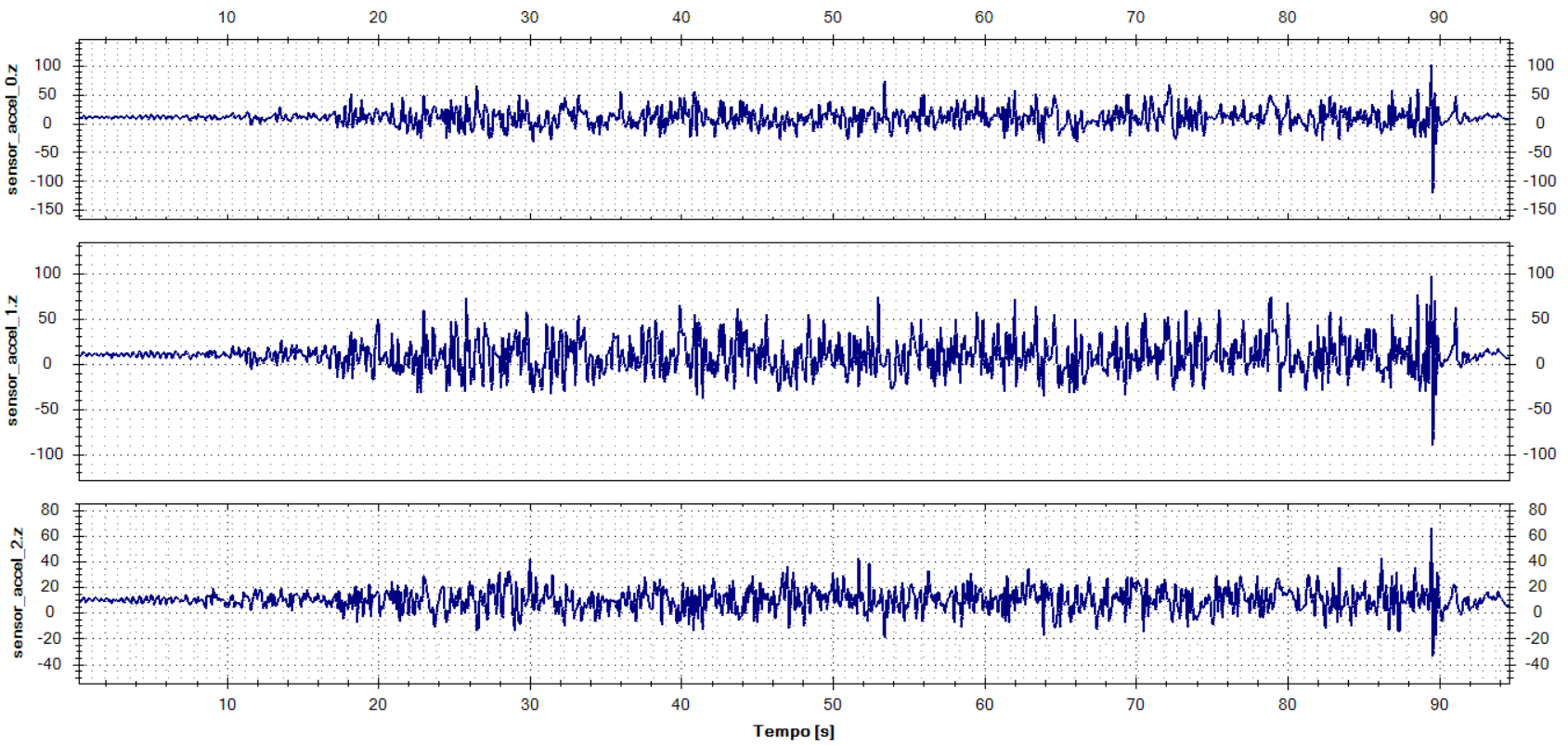

**Author:** ![marceloroberti](https://discuss.px4.io/user_avatar/discuss.px4.io/marceloroberti/32/12153_2.png) [@marceloroberti](https://discuss.px4.io/u/marceloroberti)\
**Post date:** [March 3, 2026, 1:31pm UTC](https://discuss.px4.io/t/altitude-mode-ekf-thought-it-was-descending-while-the-drone-was-clearly-climbing/48546/5 "2026-03-03T13:31:50Z")
I also have vibration issues. I think mine might be worse than yours… You’re seeing something like -25 to 10 m/s², while mine goes from around -20 up to 40 m/s² on accel\_0.z.
Could this level of vibration affect the IMU-based velocity estimation? And could it also disturb the barometer? I’m wondering if both of my vertical references (IMU and baro) could be getting unstable because of vibration.
