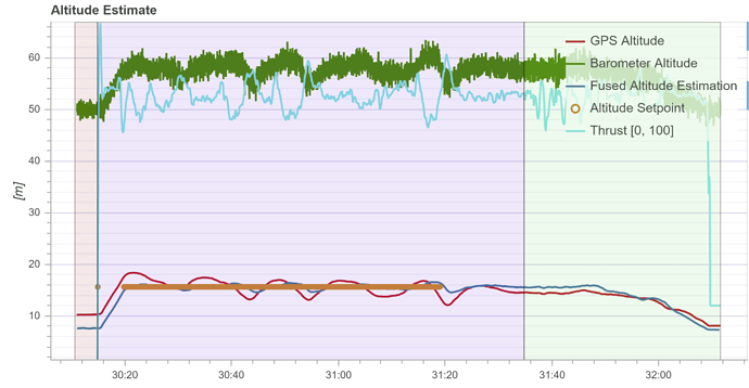

When flying a basic mission with constant altitude waypoints, the drone’s altitude erroneously fluctuates several meters. When at a waypoint, the drone climbs to the correct altitude–but while it travels to the next waypoint, it slowly loses altitude. Here’s a snippet from the flight log:
 ![0771_AltitudeGraph](https://discuss.px4.io/uploads/default/original/2X/1/1c7fc22aca8bf864d2fc07c021e821330f159e94.png)
These results have repeated on Pixhawk 1, Pixhawk Cube, PX4 v1.8.2, and PX4 v1.9.2, and different GPSs. The problem doesn’t exist when flying in other auto altitude-controlled modes, and the drone is not under-powered.

I see heavy vibrations. You need to isolate your Flight Controller. [https://docs.px4.io/v1.9.0/en/assembly/vibration\_isolation.html](https://docs.px4.io/v1.9.0/en/assembly/vibration_isolation.html)

Thanks for the suggestion. We tested this a different time with a different aircraft with low vibration levels, but still had the same problem.
