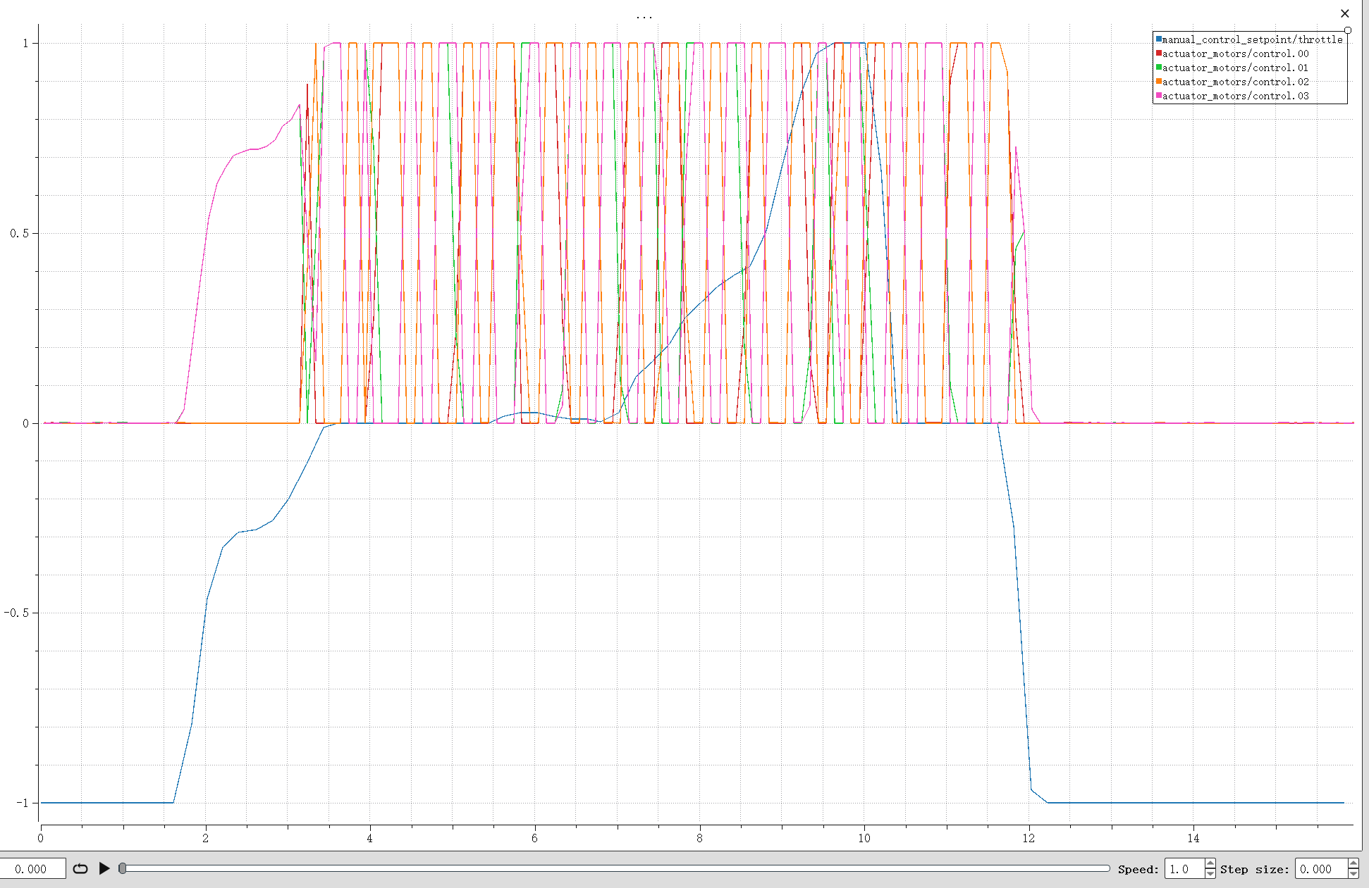

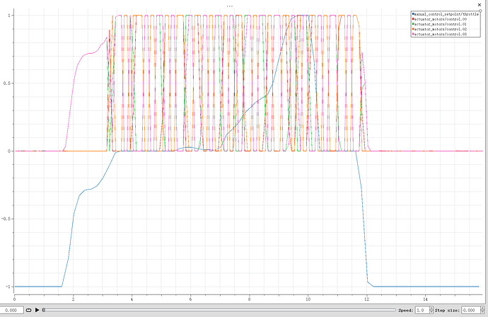

When the throttle reached a certain level, the drone began to oscillate on the ground. No matter how much I increased the throttle, the drone continued to oscillate on the ground and could not take off. By analyzing the logs, I discovered that when I increased the throttle, the speeds of two motors increased, while the other two motors, due to their control_allocator_status being -2 (indicating that these two motors had reached their minimum limit), could not increase their speed.

By the way - you mentioned 2 motors going to minimum limit, but we can see there are points where all motors going to 0 or to 100.

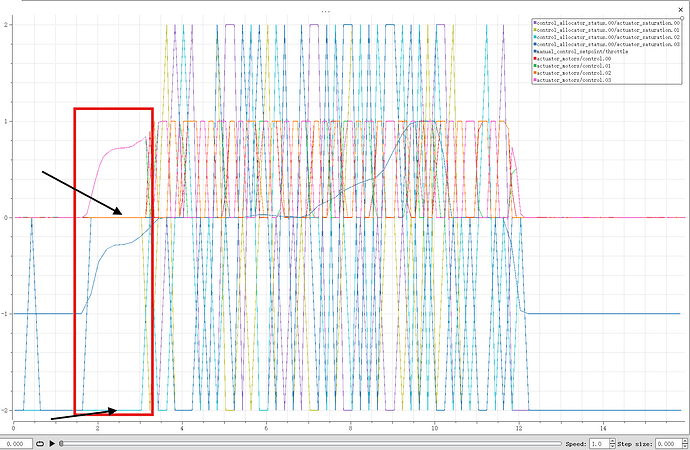

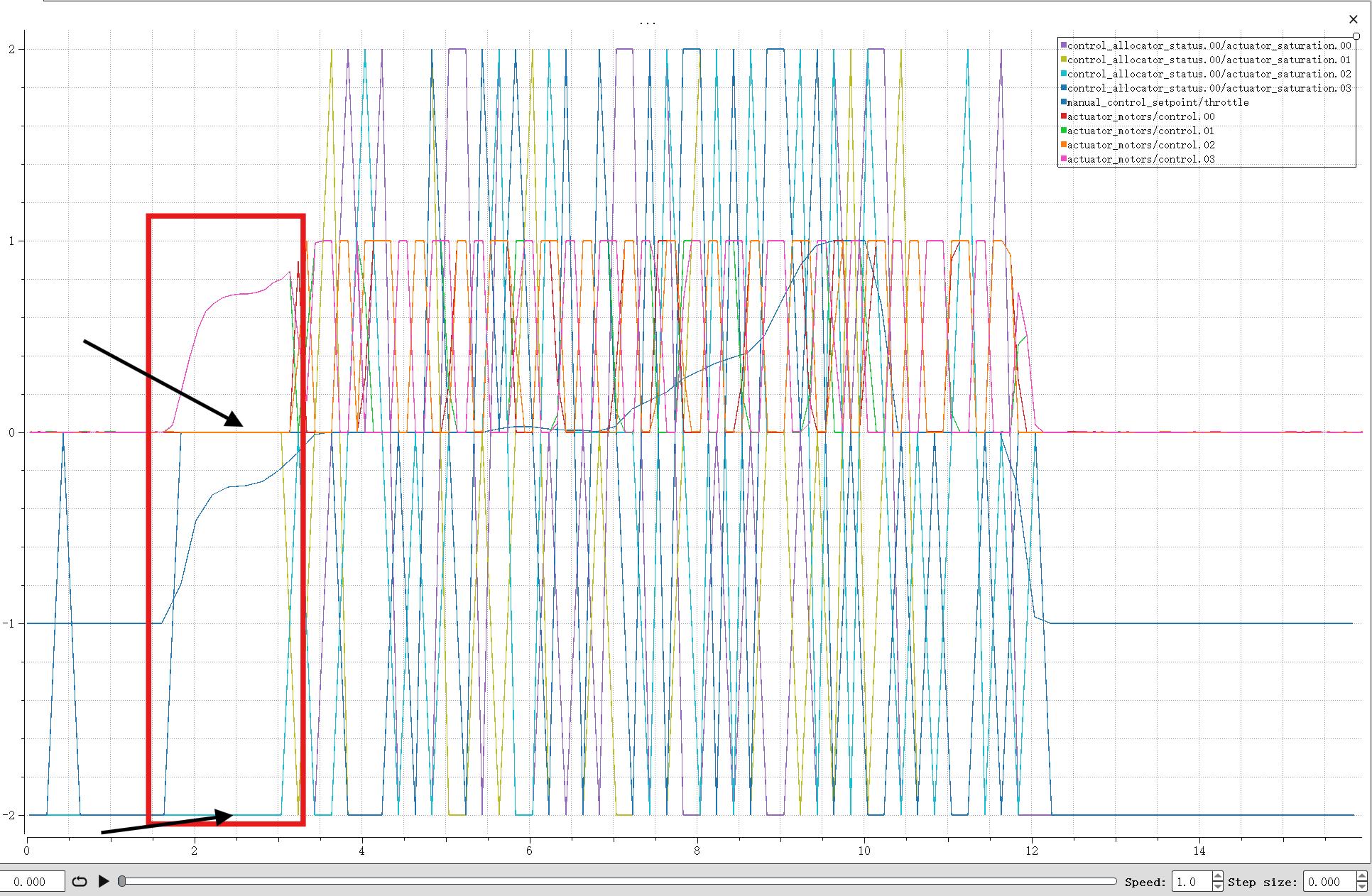

What I mean is that ControlAllocatorStatus = -2
int8 ACTUATOR_SATURATION_LOWER_DYN = -1 # The actuator is saturated (with a value >= the desired value) because it cannot decrease its value faster
int8 ACTUATOR_SATURATION_LOWER     = -2 # The actuator is saturated (with a value >= the desired value) because it has reached its minimum value
In the area indicated by the red box, as the throttle increases, the upper arrow shows the output of two motors, and at this point, the state of the two motors indicated by the lower arrow has reached the minimum limit.
