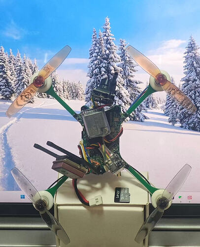

I have designed a small copter myself. In my sensor design, I used a combination of the BMI088 and SPL06, which share the same SPI bus. During testing, I noticed it is very strange in the SPL06 sensor data(The data looks completely abnormal; both the temperature and pressure readings are erratic.). However, all sensors work perfectly under the same conditions when using the ArduPilot firmware(It can fly normally.).
video: [～Very small size h743 full function ardupilot copter～ #rc](https://www.youtube.com/shorts/5bouj-E4xus)
 ![flexfly](https://discuss.px4.io/uploads/default/original/3X/a/a/aafeb52b2f1b27ef04c5e46e4e3e3f4b2a544880.jpeg)

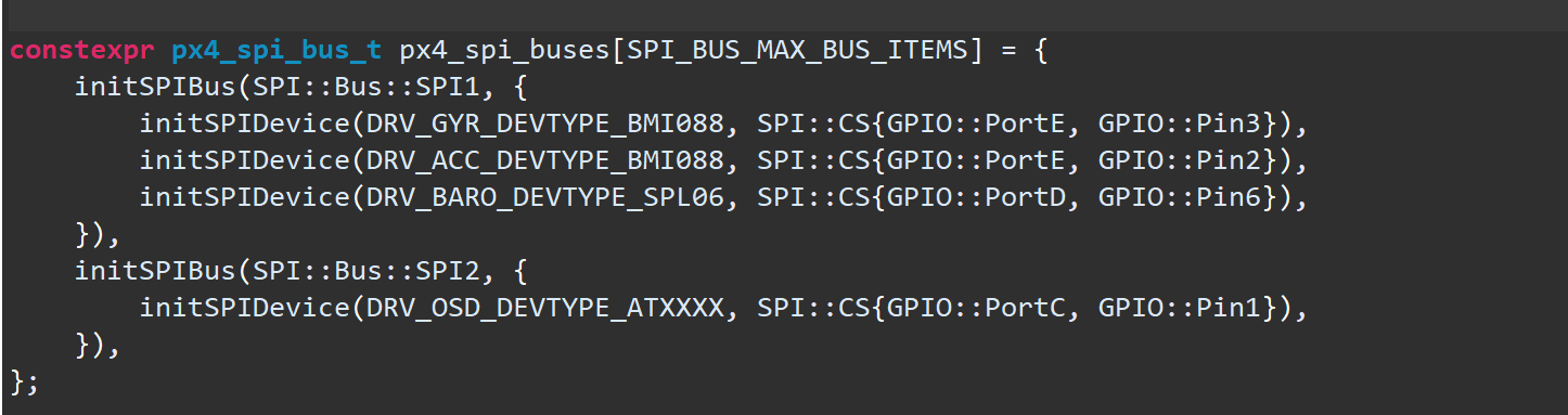

I would greatly appreciate it if anyone could help clarify this. Below is my SPI bus configuration:
 ![image](https://discuss.px4.io/uploads/default/original/3X/9/0/9089ec04bea920130d7a7c36566f39b3c6c9d2a8.png)

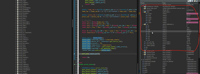

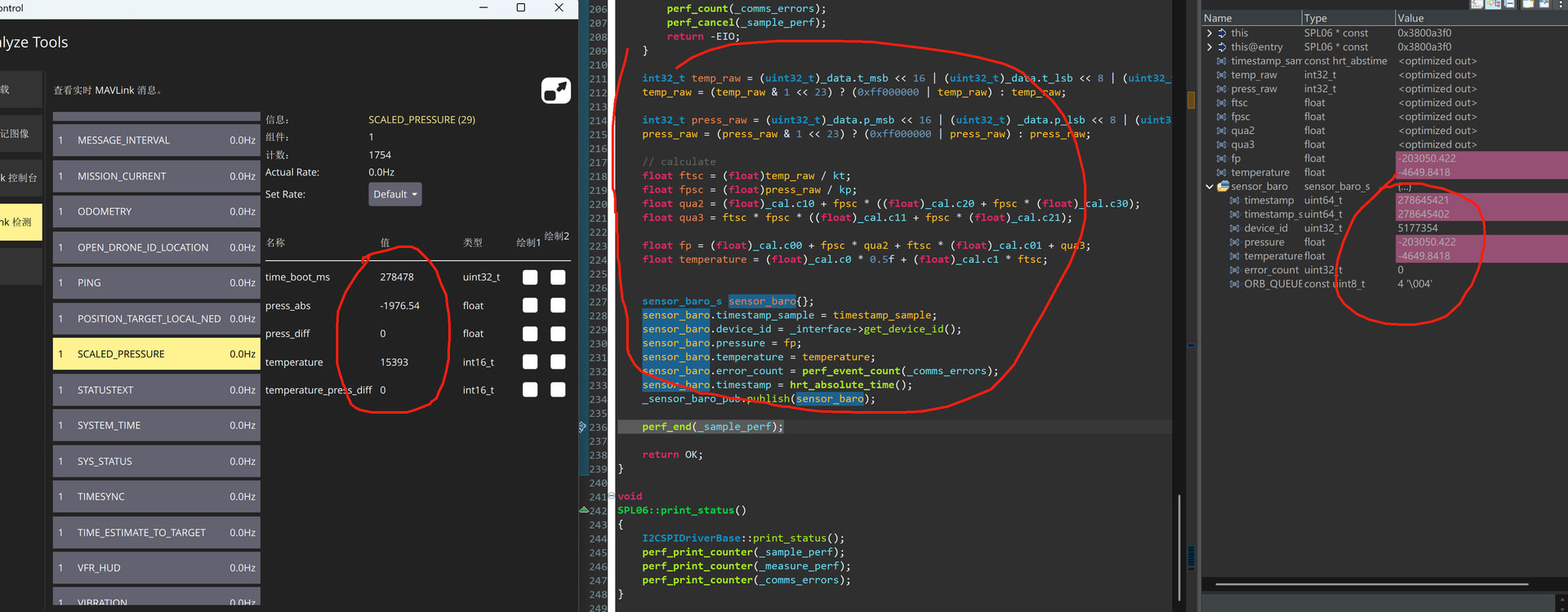

Live debug data：
 ![image](https://discuss.px4.io/uploads/default/original/3X/6/1/611cf5abd605ee83ac370213273f191adad8bbb8.jpeg)

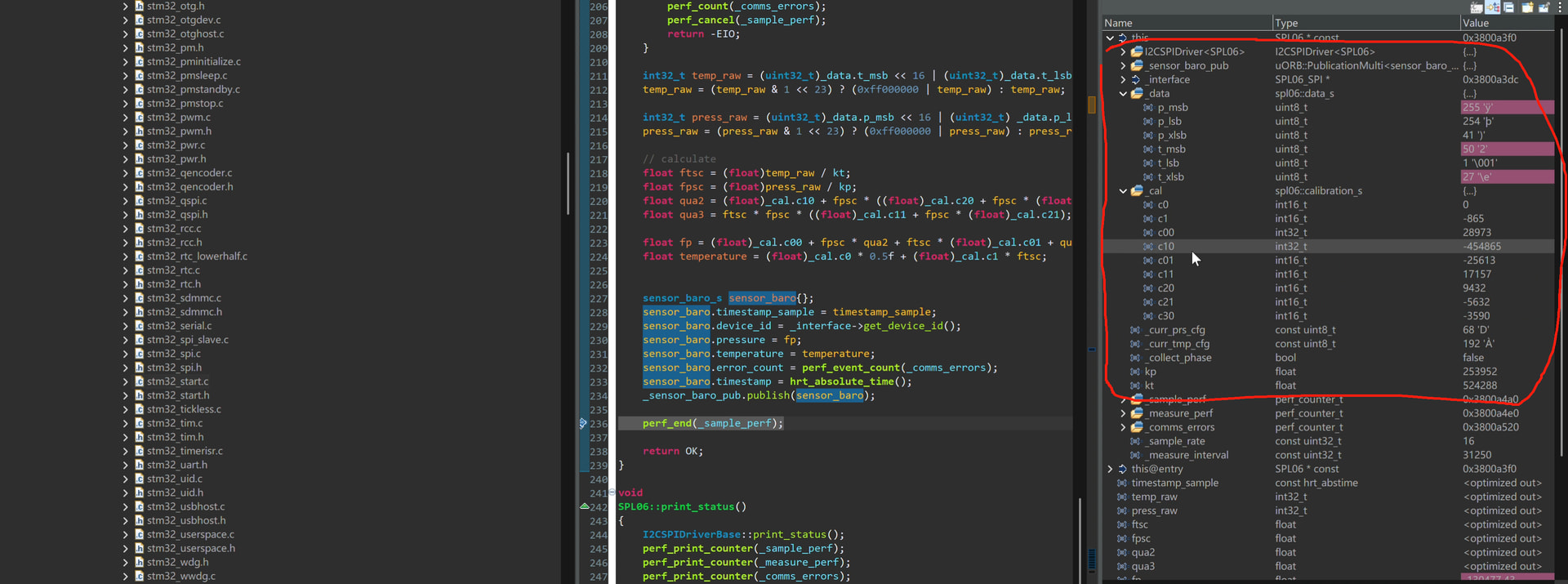

spl06 config data:
 ![image](https://discuss.px4.io/uploads/default/original/3X/0/5/053cdcf9d0e69bc602c67b5940968b5786282894.jpeg)

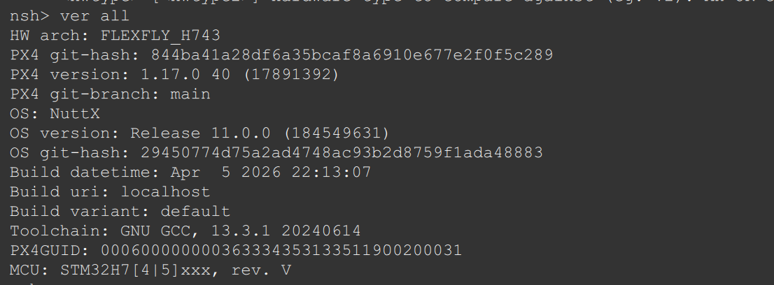

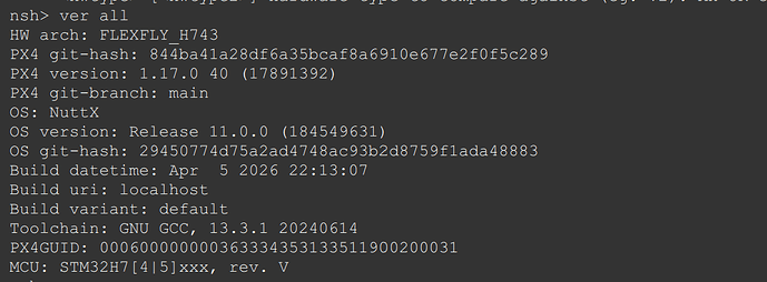

Hi **rroche** , thanks for your reply! Below is my software version information. I’ll try to submit a code pull request later (the main work on the local code is adding support for board-level hardware definition files, with no modifications to other parts of the code). Due to the barometer issue, actual flight testing hasn’t been carried out, so no actual flight log files have been generated yet. I’ll keep researching this.
 ![image](https://discuss.px4.io/uploads/default/original/3X/c/e/ce0f5e62b40c32f56ba4dc2a0c392b36db93cb5e.png)

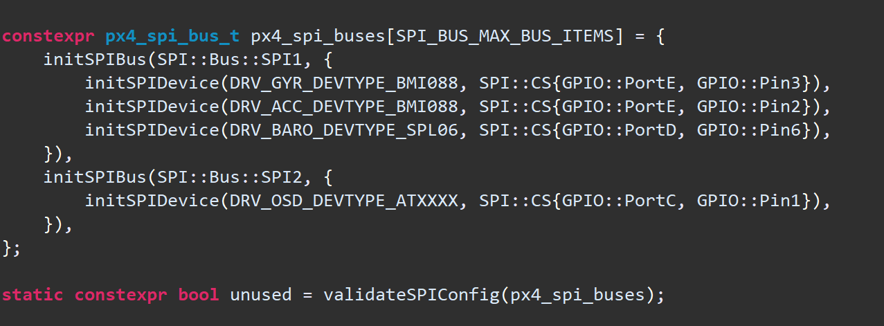

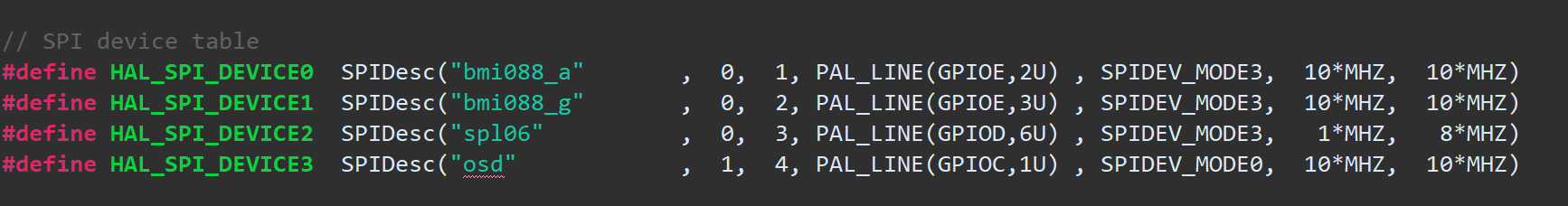

I noticed that Ardupilot can independently set the respective operating frequencies and SPI modes for different devices on the same SPI bus, and PX4 can also pass in relevant parameters via startup commands. My question is: will the parameters set in PX4 overwrite each other, or can they each take effect for every individual sensor, I also try to use “spl06 -s -b 1 -f 1000 start” to slowdown for spl06, but the problem not gone.
PX4 spi bus device define:
 ![image](https://discuss.px4.io/uploads/default/original/3X/7/3/739d47329c72933052db9ed79ffef62c07da6d2e.png)
ArduPilot spi bus device define:
 ![image](https://discuss.px4.io/uploads/default/original/3X/e/5/e575c67294ad451b1ed4f9bbac498fe3a47b383c.png)

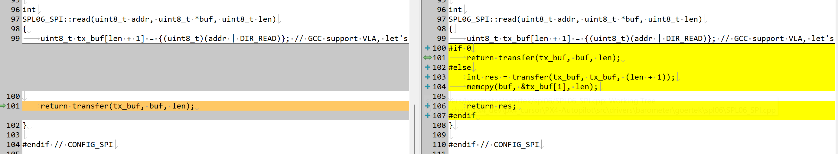

Hi, [rroche](https://discuss.px4.io/t/a-strange-problem-when-driving-the-spl06-via-spi/48770/2), I think I’ve found the root cause of the problem. It lies in this file([SPL06\_SPI.cpp](https://px4-autopilot/src/drivers/barometer/goertek/spl06/SPL06_SPI.cpp%20at%20main%20%C2%B7%20PX4/PX4-Autopilot)): the data buffer filled during SPI multi-byte read operations was misaligned.
After making the following modifications, all the data from the SPL06 sensor is now functioning correctly. This issue affects all flight controller hardware that uses SPI to read data from the SPL06 sensor：
 ![image](https://discuss.px4.io/uploads/default/original/3X/2/d/2dfd37574dad46b58af5802d1cd019b6696a9b24.png)

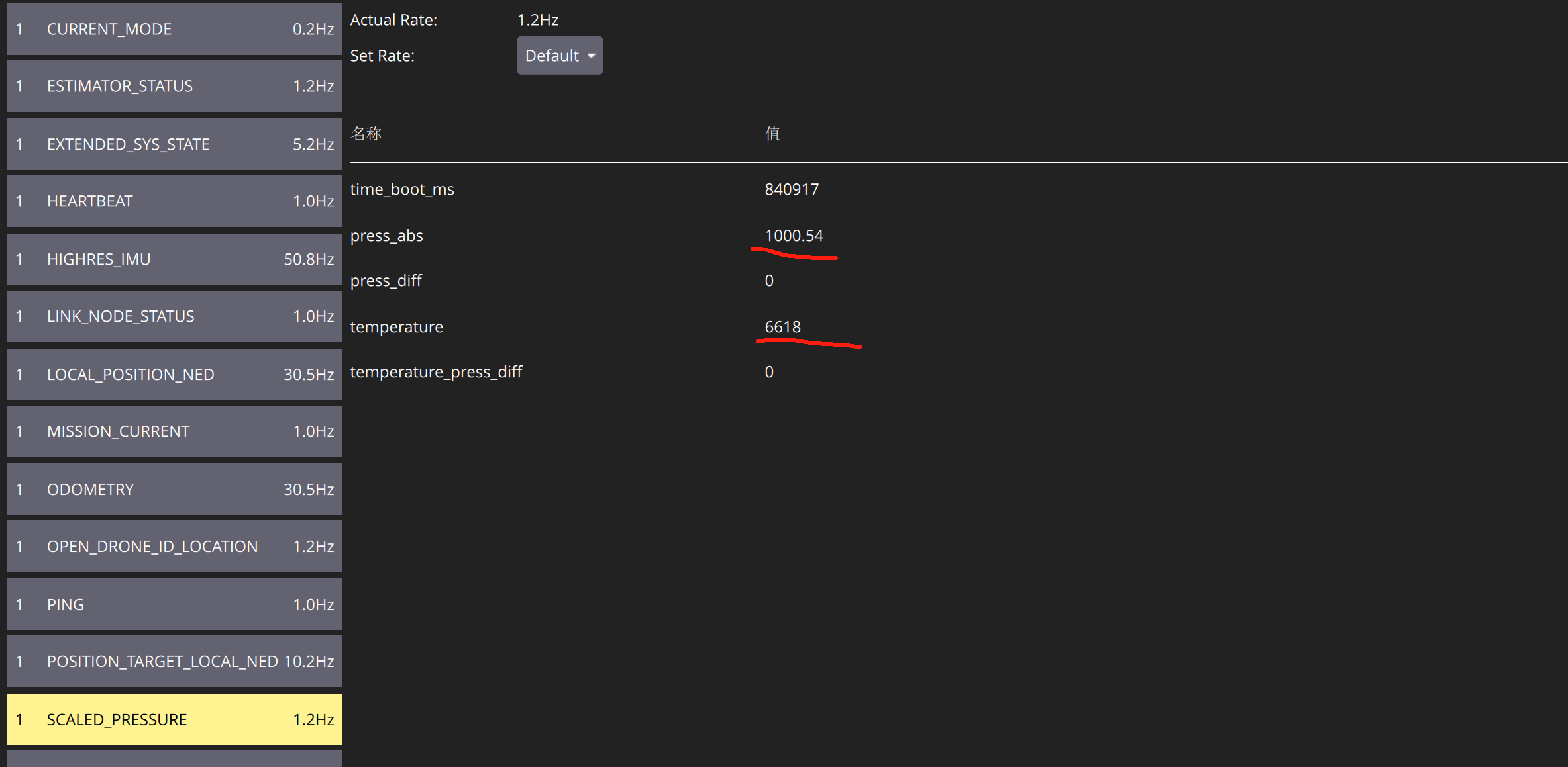

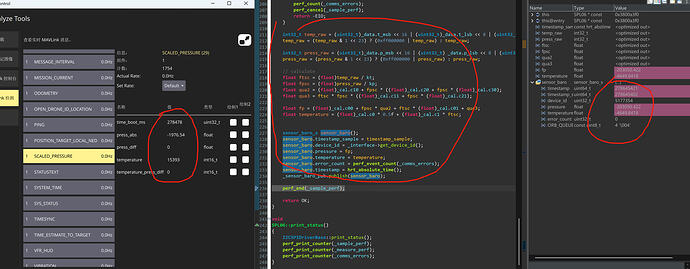

sensor data looks good：
 ![image](https://discuss.px4.io/uploads/default/original/3X/f/7/f7ffc5d3b39d197c236c561abdc09da13a673b32.png)
