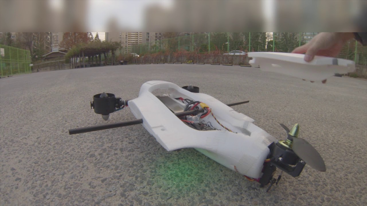

Hello everyone,
I decided to build a VTOL with EDFs on flying wing with tricopter style as described below image
I actually almost finished building as below
I setup as default Tricopter + setup and successfully flew in vertical mode.
Now I need to figure out how to make transition from vertical to flying mode.
I tried to search for any selectable option in the default setup but could not find anything yet.
Maybe I have to write my own script file for this? Any idea and suggestions would be much appreciated.
Kyu

OK so I wrote my own script file as follows.
In init.d folder, I added a file named “13014_vtol_tricopter” which includes following lines of code.

and in mixer folder. I added a file named “vtol_tricopter.aux.mix” which includes following lines of code.
Elevon 1 mixer
M: 2
O:      10000  10000      0 -10000  10000
S: 1 0  -6000  -6000      0 -10000  10000
S: 1 1   6500   6500      0 -10000  10000
Elevon 2 mixer
M: 2
S: 1 1  -6500  -6500      0 -10000  10000
Tilt Servo
M: 1
S: 1 5  10000  10000      0 -10000  10000
How do you think about this code?

Now I am trying to figure out how to match the pwm output to servo motor.
When I triggered transition, tilt servo does not seems to move its maximum position vs directly controlled by receiver.
Below image shows the two outputs. CH1 is from AUX, CH2 is from the receiver.
When all the way down, AUX only reach about 1.48ms while the receiver generating 1ms duty pwm signal.
I did increased the Tilt servo mixer in my mixer file to 15000 but nothing change much.
Tilt Servo
M: 1
S: 1 4 15000 15000 0 -10000 10000
Is there anything I can do to solve this issue?
It think the problem is in the scaling and offset value of your mixer. The parameter “VT_TILT_FW”, “VT_TILT_MC” dictate the tilt control output value in each mode. Since in your case it’s 0 and 1 the trick is to setup your mixer using the positive scale and a offset.
Yes you’re right and figured it out myself too.
I changed the mixer as follows and now I can get the right pulse
M: 1
S: 1 4 0 22000 -10000 -10000 10000
Thanks for your comments.
Now I can fly the thing!
