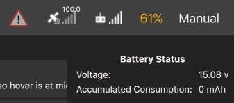

Strange Behaviour of Battery Voltage observed. When I tried to arm the vehicle would deny with âVery Low Batteryâ - despite just before Arming it showed 61% (15.1V for 4S), then during the Arming Command the Battery percentage dropped to around 40-45% (still showing 15.1V!!). See Pictures:
During Arming:
After Arming (same as before):
And this is what the Messages showed - Again the Safety Switch!?
But not only due to the Safety Switch Issue - after a Reboot same thing happened.
