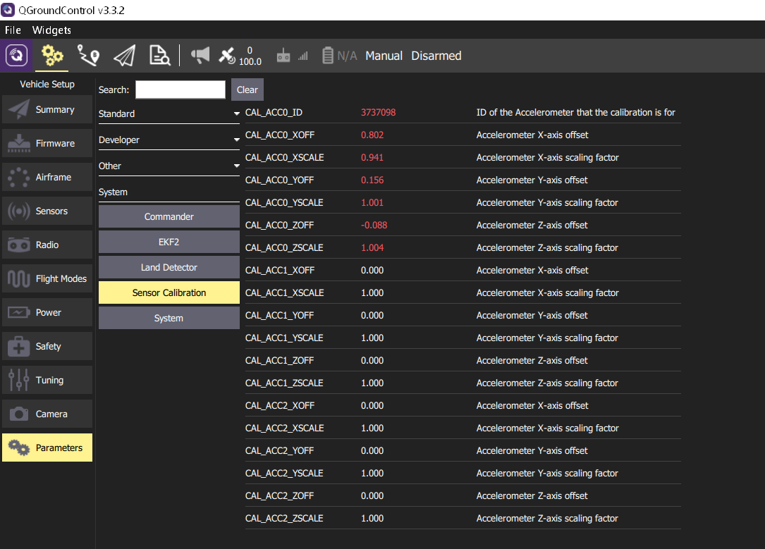

Hello I am trying to test a prototype quadcopter with a PIXHAWK MINI 3DR. The prototype worked well a couple of times and now is not anymore. It had a little contact on front side of the copter when testing the stabilization(I will try to attach the video)and after that the drone won’t stabilize itself anymore. I get the message “PREFLIGHT FAIL: EKF HIGH IMU ACCEL BIAS” I checked on the commander COM_ARM_EKF_AB to make sure its value was at the default value since that is what I saw online to do (which it is). I kept searching for possible errors and came to find under parameters>system>Sensor Calibration that the default values are way off on what I’m getting after calibration (even when I reset them to default values) I will also try to attach a screenshot of what I am talking about because the values are way off.

If you calibrated your sensors and the error still occurs then have a look at the COM_ARM… parameters in QGroundControl. You can set the thresholds for the parameters which prevent you.from arming. Of course this is at your own risk of possibly ignoring a problem in the system.
Everything but the flightmode slots (1 and 6) is under the default values.
I keep getting the same message “PREFLIGHT FAIL: EKF HIGH IMU ACCEL BIAS” after setting values to default under sensor calibration and then calibrating the drone. Is there anything else I could check or do to fix this problem?
