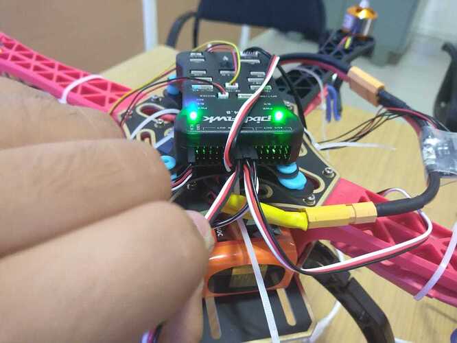

These are the images of my pixhawk connection with ppm and receiver. I followed the below attached pixhawk connection for my drone
Hm, I can’t spot something wrong. And you have calibrated RC in QGC? And done all calibrations? And were able to arm without error messages?
Yess calibrated twice actually , still can you share any link for calibrating piwhawk using mission planner ? And even after calibrating all motors aren’t working together on same channel .
If you’re using Mission Planner, you’re using ArduPilot and not PX4 and I recommend you ask int he ArduPilot forums.
