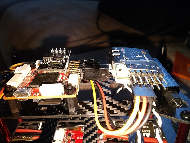

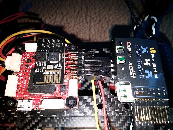

Please someone helpā€¦I tried to flash pixracer with px4 using qgc but could not get radio to calibrate. My understanding is I should be using a specific download of QGC and a specific px4 fw. Could someone link me to each specific one that works to date. I have been trying various SW and FW and run into one dead end or anotherā€¦being it radio, software, fw or esc problems. I have followed painless 360 videos but do not get same results. I was able to get Mission planner to flash PX4 master but can not get escā€™s to calibrate. I dont get the calibration startup tones. Thatā€™s following videos and on screen instructions. Im about ready to sell this board. Pleased with quality but disappointed in lack of documentations specific to this FC. Very hard for someone who has never set one up comming from Cleanflight worldā€¦Shame for price paid.
Pixracer V1 rc14
Aikon boltlite 30a
Sunny Sky 2206 2000
Taranis plus 2.1.8
X4r sbus
Can you please download QGC from here:
Then flash the latest BETA of the PX4 flight stack (while flashing, tick the advanced check box, then pick beta). Re-do the airframe setup. Let us know what you end up with.
Charger, I use the X4R-SB myself. Can you post a picture of how you have it connected?
Thanks,
Phil

Radio calibration was successfulā€¦but sorryā€¦sensor calibration is asking for air speed sensor nowā€¦is there a way to turn that off?..I chose Lumenier QAV250 for frame type
SW: QGC 2.9.5
FW: PX4 beta
Phil
Can you reboot and check if it still asks for airspeed?
Lorenz
Thank you for your help. That did it. I have managed to make it through all necessary steps I do believe. Not sure about esc calibration. There were no tones from the motors to verify escā€™s calibrated and it didnā€™t have me do any stick movements? Is this correct? When I lower the throttle I have one motor that shudders like its not off all the way.
Also, where do I go to learn about the various flight modes for QGC? What they are/mean and how to set them up?
Can I ask what was the resolution for the RC not being detected?
The QGC SW and PX4 FW versions Lorenz recommended in his answer to my question resolved that issue for me.
