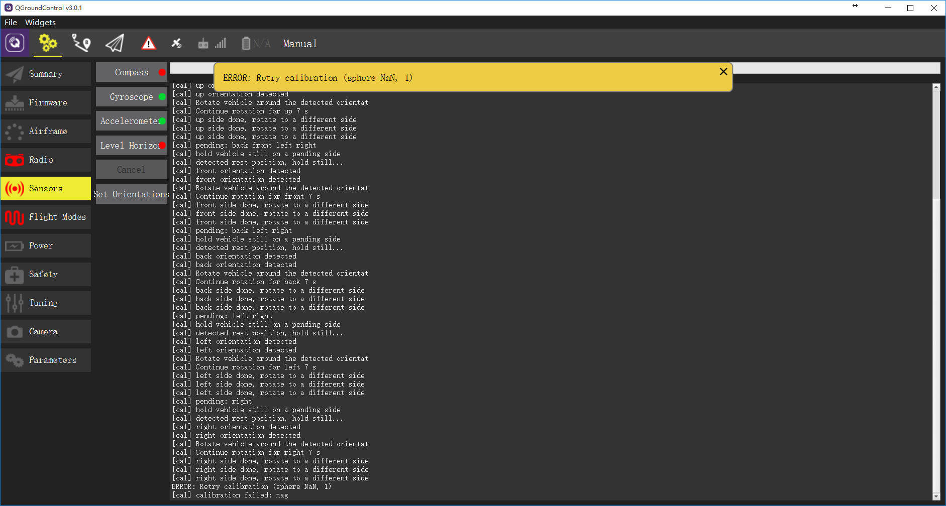

When I calibrate mag0 and mag1, QGC always says that mag0 selftest failed. I use teraterm and see that mag0 is successfully mounted. Can anyone help me what causes this problem. Thanks.
EDIT: sometimes it pops up this error msg:
Cannot figure out why. Please help me out. Thanks guys in advance.

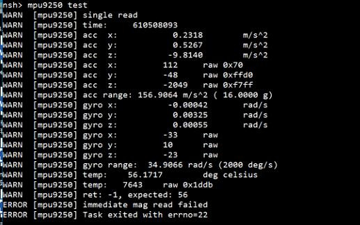

I use teraterm testing the sensors:
All the sensors sort of pass the tests, but when I test 9250, it gives me the following error:
while testing hmc5883:
It seems that it is 9250 that causes this problem. Does it mean this sensor is broken already?
