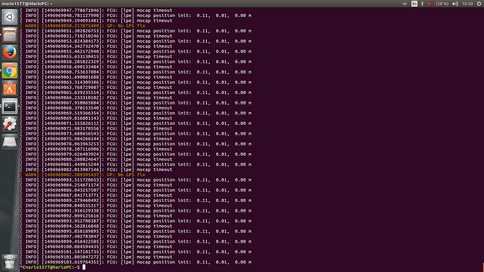

We are working on visual hovering indoor using 6 optitrack cameras. However, it does not work with the following configuration.
Issue details
I can see the data stream in the mocap node and the data was received by the mavros correctly.
[ INFO] [1495755189.973277609]: FCU: [lpe] mocap position init: 0.11, 0.18, 0.20 m
[ INFO] [1495755190.162792328]: FCU: [lpe] mocap timeout
However, the terminal kept sending timeout during the flight and posctrl was rejected. The drone doesnot fly correctly.
MAVROS version and platform, Autopilot type and version
Odroid side: 14.04+mavros+mocap_optitrack+wifi;
Flight controller side: px4 stack 1.6.1 lpe+921600@telem2+Lpe_fusion is set to use vision position and vision yaw and othersare unchecked + ATT_EXT_HDG_M is set to motion capture;
PC side: motive tracker is broadcasting the rigid body frames through wired ethernet connection.

No. Nothing visual signal appears in the FC side.
Do you see something like this? @Sand
Sand
June 24, 2017, 3:11am
6
Yes! Exactly same.
Will you get rejected when you switch to posctrl?
Hello! @Sand
I think it will not be rejected, maybe the Quadcopter will have oscillating movements.
Have you been flying the quadcioter while appear the message “timeout”?
have you been sending position setpoints to pixhawk?
Regards!!

What do you mean by “oscillating movements”? Does the “rejected” response relate to the movement controller?
The message always appears during flight.
I have not sent setpoints offboard cmd to px4.
Oscillating movements = the movement is not stable, I think that the first step that you have to do is to fix the “timeout” maybe your mocap frequency is very high. @Sand
