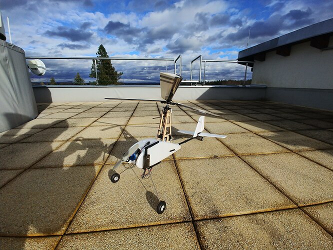

we have tried to fly with autogyro Auto-G2 with PX4 autopilot. After recieving the package from HobbyKing we were surprised, that model is more similar to the airplane (fixed-wing) then autogyro (as here http://www.aviastar.org/theory/autogiro/fig12.gif ) This is because it is possible to control only thu roll axis of the rotor-head. And elevator and ruddle is so big and efficient to compare with autogyro body mass. So we decided to try model with fixed-wing regulator.

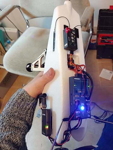

The first thing we had to solve was how to attach autopilot with all accessories to such small autogyro. Autopilot, RC receiver, Telemetry radio and airspeed sensor were attached from outside with loop and hook fasteners. Pitot pipe was mounted on the top of top pilon using a hot-glue.
Battery, Power module, small GPS with antenna and regulators were placed inside.
After the installation and wiring of all equipment, we have measured the center-of-gravity. It was a few cm from the rear side.

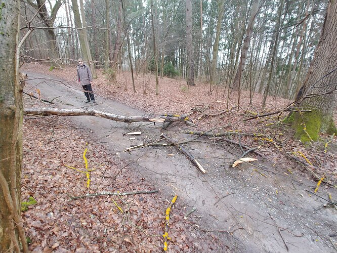

On the way back we had to clear the road of the fallen tree due to the strong wind. :smiley:
